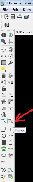

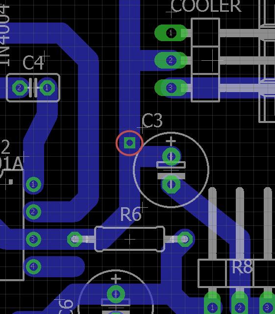

    Now, while browsing the PCB and adding one element (Pinhead 1x3 / 90) to the Cooler, I suddenly found myself on the Drill Size path and I can't remove it. In Tools Errors, he points to him all the time. How can I get rid of something like this from my plate? VA Transformer Capacity for 24V, 5A Power Supply & LM317 to LM350 Swap Query
  • #16 16626465
    398216 Usunięty
    Posts: 34164
    Help: 3925
    Rate: 9279
    This is a grommet? "Ripup" this path and lead it again.
    Unless it is a heat sink mounting - then it is assigned to the heat sink itself in the library and it cannot be done this way. You would have to change the library of this item.
