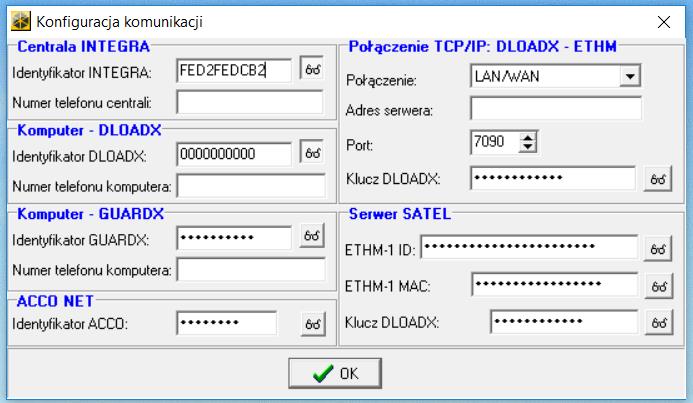

    c) Select from the "Communication / Communication configuration" menu and enter the INTEGRA and DloadX identifiers (in the attachment window for entering)
    Despite the steps described, I can't connect to Integra 64.

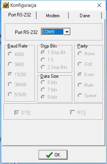

    2. After entering the correct COM port in DownloadX (point 5b) the window with the rest of the options in the window is inactive. Should it be like that? Screenshot attached.
    3. After starting DonwloadX, some Integra ID is entered that does not match the ID of my Integry64, and the zeros are entered in the DownloadX ID field.
    In connection with point 5c, do we enter in DownloadX -> "Communication / Communication configuration" both identifiers (Integra and DownloadX) obtained in points 2d and 2e?

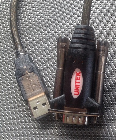

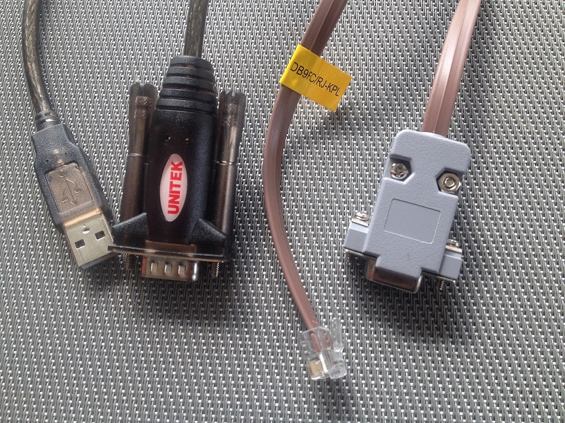

    4. I attach a photo of my cable. I bought it from a Satela store. Through it (I connect 3 cables: USB + RS-232 (DB9FC / rj-KPL) + RJ / PIN3) I configure the settings in GPRS-T2. I have used it only a few times (less than 10) in the last 3 years. Do you think the reason for the lack of connection with Integra64 could be my cable?

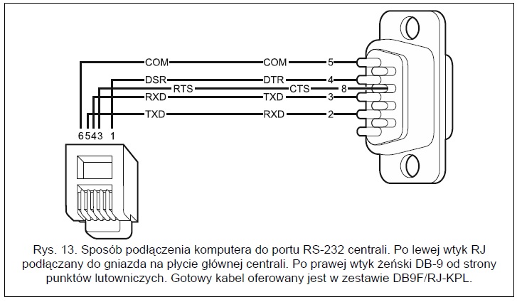

    As already mentioned in the post of colleague Stan-Mar and in my above, this cable is not correct. It should be white (DB9F - without "C"). It is no longer produced, but you can do it yourself according to the installer's instructions for the Integra control panel.
    Today, the only official Satellite cable in current sales is USB-RS.

    So I have to make the cable as in the installer manual on page 24 (diagram attached). The made cable is connected to the computer via a USB-RS232 cable (attached).

    Mierzyn007 wrote:
    Do i understand correctly
    Yes
