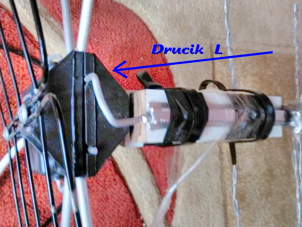

    Hello all.
    Once I bought an ordinary normal room antenna.
    However, there is poor reception to catch something good in DVB-T tropo time or an analog signal from Kaliningrad.

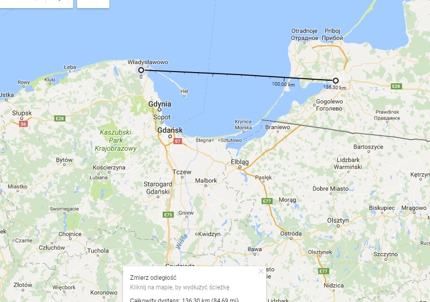

    I am from the vicinity of Władysławowo and I have a range of 135Km to Kaliningrad.
    With such a small tropo one can say the marginal signal obtains the quality of the visible snow-covered channel sometimes with voice but poor visibility of the image.
    So can you tell me if there is anything I can do to get a better effect?

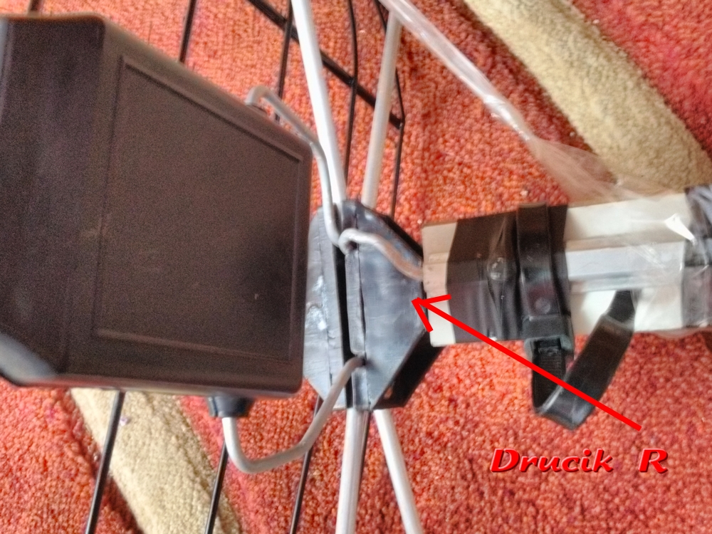

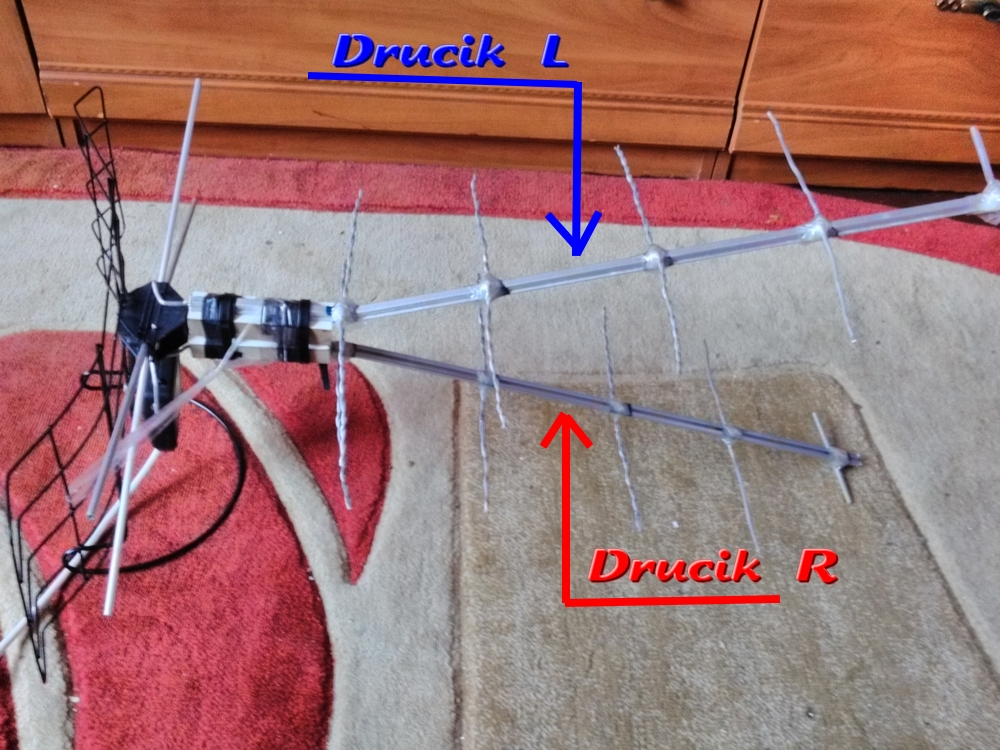

    I made my modification in the same way as in the pictures, which improved the signal quality a bit, but I would like to change it even more effectively to get a long range of up to 150km or more.
    Can you advise me on how to convert it to get a better signal effect?
    Here are the photos of my antenna that I have converted.
    Improve DVB-T Reception & Analog Signal: Room Antenna Rework for 150km+ Range near Władysławowo Improve DVB-T Reception & Analog Signal: Room Antenna Rework for 150km+ Range near Władysławowo Improve DVB-T Reception & Analog Signal: Room Antenna Rework for 150km+ Range near Władysławowo
    I would like to add that sometimes almost every day with this modification of my antenna it can catch such a reception from Kaliningrad almost every day in the evening.
    I'm upstairs and the antenna in the room will catch this reception
    And if I put the antenna on the roof in the right direction, it can get such a reception from Kaliningrad almost every day.
    So I need your help what to do and how to convert it to get a better effect.

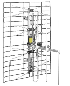

    I am thinking of buying a broadband mesh antenna like in the picture
    or plain without yagi.
    And when it comes to the directional line, I am not sure which one because I am looking for one with the longest range in kilometers.
    And would it be good with a gain of up to 46dBi?

    After all, the range reaches Kaliningrad via the Baltic Sea, so there is no area on the way.
    I know that I would have to test a broadband and directional antenna,
    just throw the money for them, the antenna needed with one of them is also a waste of money as one of them does not serve well as it should.
    As for this plate, which I gave in the link, it has a range of 180km and I used to have this plate and I know that it served me functions as the analog in Poland was.
    So which Antene is best to buy for you?

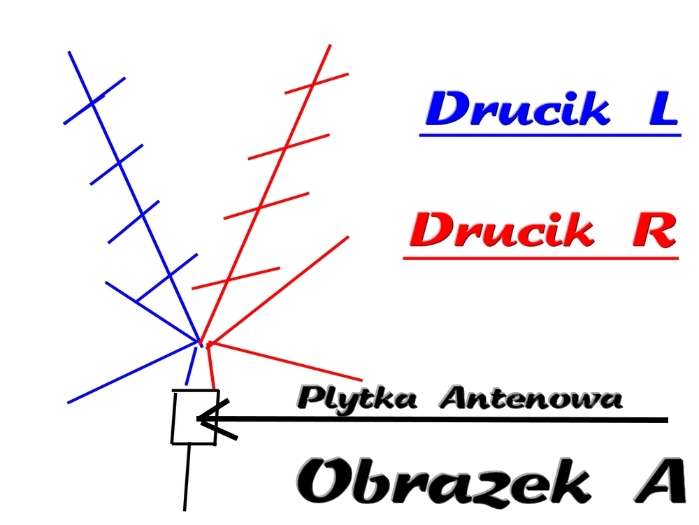

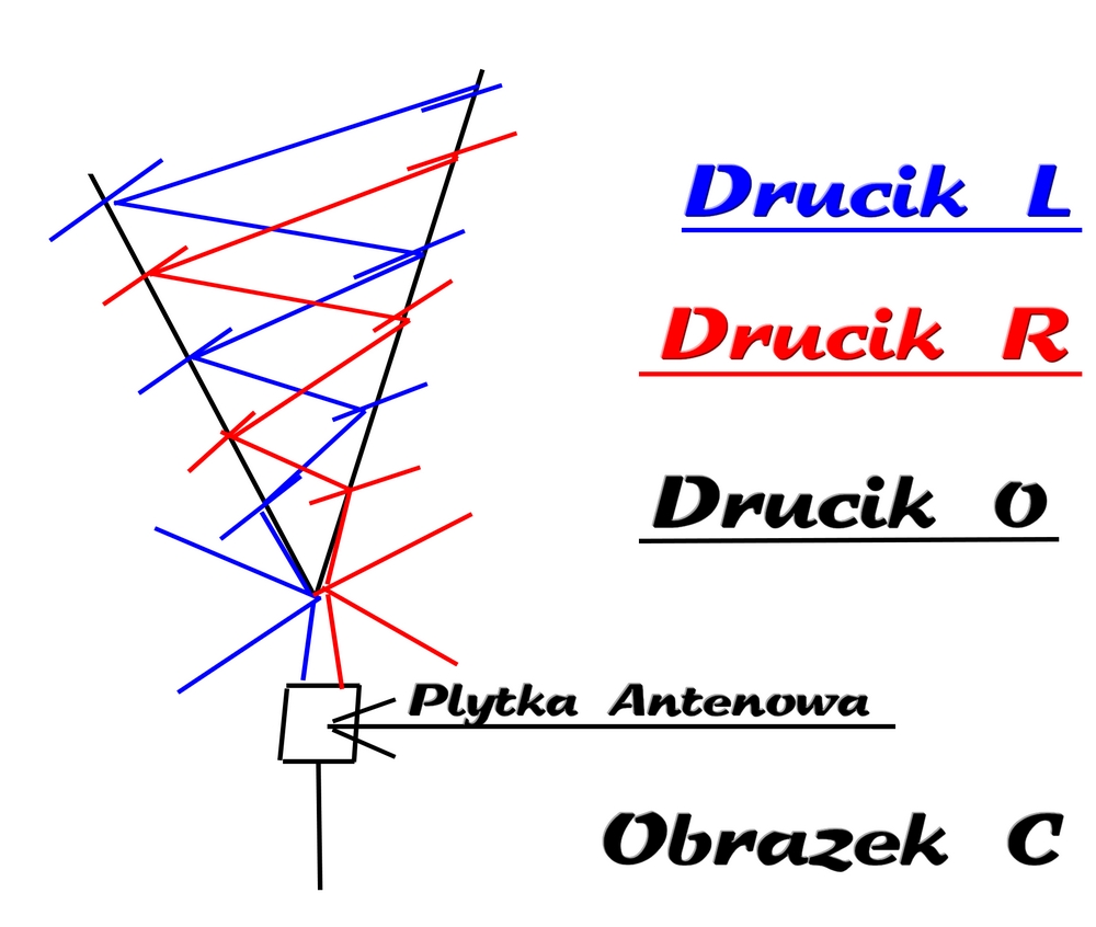

    Coming back to the question of whether to rework the pictures on this antenna in the way I have given below.
    On Picture by A.
    Currently, I am connected so that the wires adhere to the main wire.

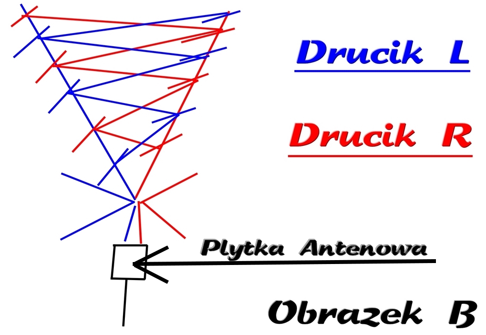

    On Picture B
    In picture B I made a diagram that a pair of wires will be connected from the R to L channel without adjacent the main wide wire through which the stream flows.
    Of course, I will add that the connection will not be as crossed as in the picture in the middle between Wire L and R, only the connection will look in such a way that on Wire L there will be 3 wires adjacent and 3 wires of wire R will be along the line of the main wire L will not be adjacent at all the way when they will be connected, and then the other way round from the main wire R connect 3 wires to wire R and then 3 wires will not be adjacent to the main wire R, and along the main line R the wire L will be led to the wires.
    On Picture C.
    Picture C looks like a diagram similar to picture B, except that the main wires R and L will be completely free of streams and isolated from wires. And the connection will look like picture B only without the main wires.
    Question...
    Which scheme do you think would be the best A, B or C solution?
    I would like from your solid advice on the schemes that I have written for you.
    Thank you very much in advance for your help and advice.

    Someone of you will help me choose a good diagram from pictures A, B, C what did I give above?

    Buddy, you don't write anything about the dimensions of the antenna. Remember that the antenna must be matched to the frequency of receiving or transmitting. No antenna made "by eye" can work properly.
    On the other hand, when it comes to the popular amplifiers you mentioned, let me write this: paper will accept everything. The gain of 45, even 60 dBi, is pure fiction, the fur seller does not have to be a furrier, in electronics it is exactly the same. "The seller said that, I bought it." There are a lot of such statements.
    You have to buy or make a 5-7 or 9-element 223MHz antenna, plus an amplifier, but with a real gain of about 18-22dB and you can expect effects. If you look around, maybe you will find an antenna from the 90s for the "first program" and an amplifier for such an antenna.

    Of course, he also adds a picture of how I have myself to the Kaliningrad transmitter.
