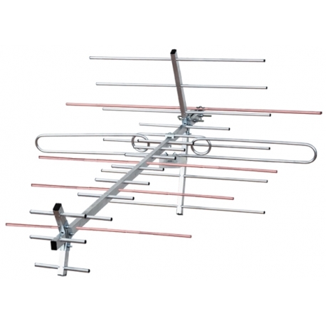

    Hello, can anyone say if such a directional DVB-T antenna can reliably receive the signal? https://davbol.pl/anteny-telewzyjne/antena-kiercyjna-q100 I urgently need to buy an antenna and I have no one to advise on, I don't know anyone who will deal with satellite TV issues ... the first thing that caught my eye on the net is this antenna. If possible, please provide a quick response. If this is bad then what would be good?

    Very good choice, the place of receipt is?

    Gdańsk, suburbs. The antenna should be on the roof of the house.

    Gdańsk suburbs - covers the area from Chwaszczyna itself, through Banino, Matarnia, Żukowo, Kolbudy, Kowale to Przejazdowo. This location is not precise enough. Pruszcz Gdański is also a suburb of Gdańsk. Also sometimes hilly. Maybe something more specific - address or coordinates ... where the antenna (roof, balcony, wall) will be mounted, which floor, how much power it will supply to the TV sets, some obstacles on the way to the transmitter ...

    A bushing is a specific place when it comes to receiving, basically from any transmitter.
    Both Chwaszczyno and Jaśkowa Kopa (only MUX-3 lighting) are obstructed by a large Biskupia Górka, located "behind" almost behind residential buildings and towering over them a lot. Reception from Chwaszczyna and Jaśkowa is practically impossible, except from reflections. A directional antenna without a proper device is rather difficult to hit the right and reflected beam.

    It is almost 60 km to Jagodnik from Spadzista. It had to be a good "barrel" since as passive it managed with these 10/10/10 powers. But the view could have been beautiful like Chwaszczyna from Wierzyca.
    The location of the streets on Zaroślak is extremely unfavorable to receive and either Jagodnik with a solid antenna or antenna with a wider angle of view capable of catching signals from reflections. Only that in the east and north-east direction is not very much from what. There are no potential larger objects and the area is flat.
    Well, but you have to try, preferably with the right tool.

    That's exactly Żukowo. I will order today the one I wrote about, I talked to one "specialist" (I hope :) ) and claimed that there would be no problems, in case I could send her back. Thanks for so many answers.
