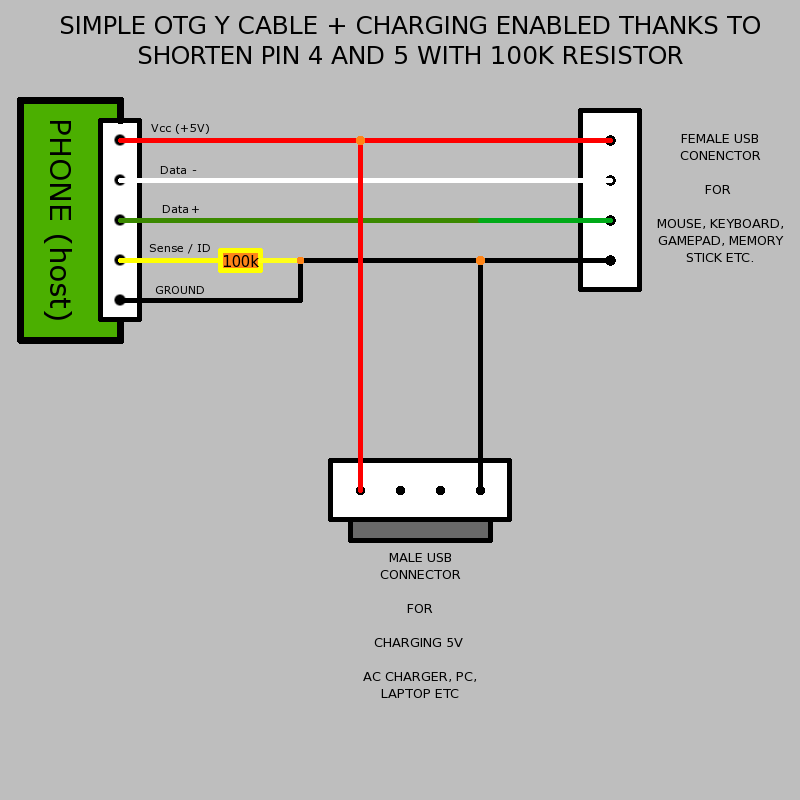

    Your USB HUB to a separate power socket?
    This is more or less the schematic of the OTG Y cable
    Nexus 7 2012 WiFi Tablet: Issues with OTG Y Cable and 4 USB Hub using Timur's Kernel ROM
    The outgoing cable is for charging, i.e. you connect it to the USB power socket in the 5V lighter from 0.5A to 2A. The USB hub, if it does not have a separate power supply, receives power from the phone and thus from the cigarette lighter power supply, if connected.

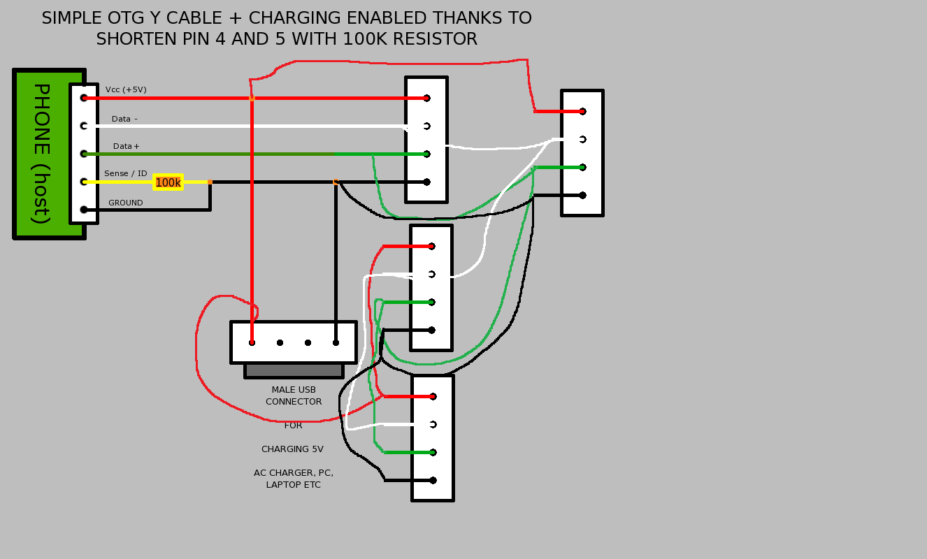

    I even disassembled this hub, I unsoldered the cable from the +/- I soldered the power supply from the Dc-Dc converter and left only the cables from the Data + / Data - and then nothing, the tablet shows the 400mb / s hub in the USB device (or I do not remember something exactly) but if I get hooked devices, do not connect them.
    And I have a question, I found such a diagram on the net and if I create it, I will add more usb inputs as in the 2nd photo, will it be ok?

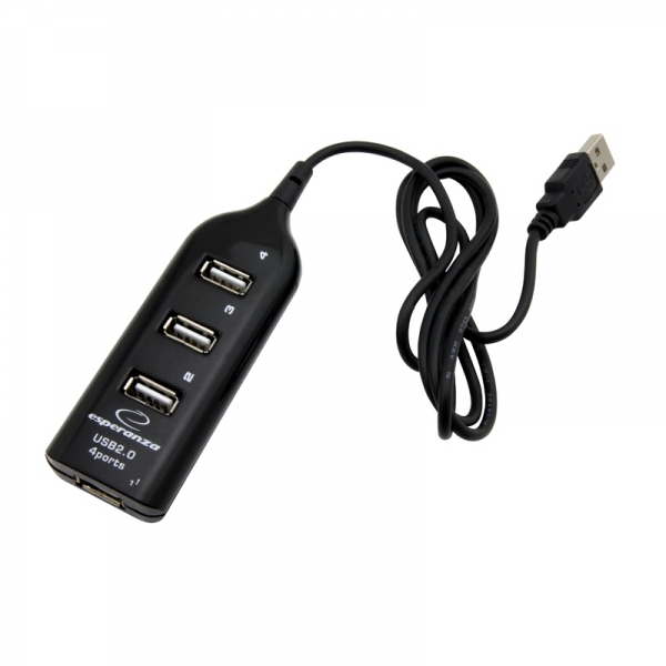

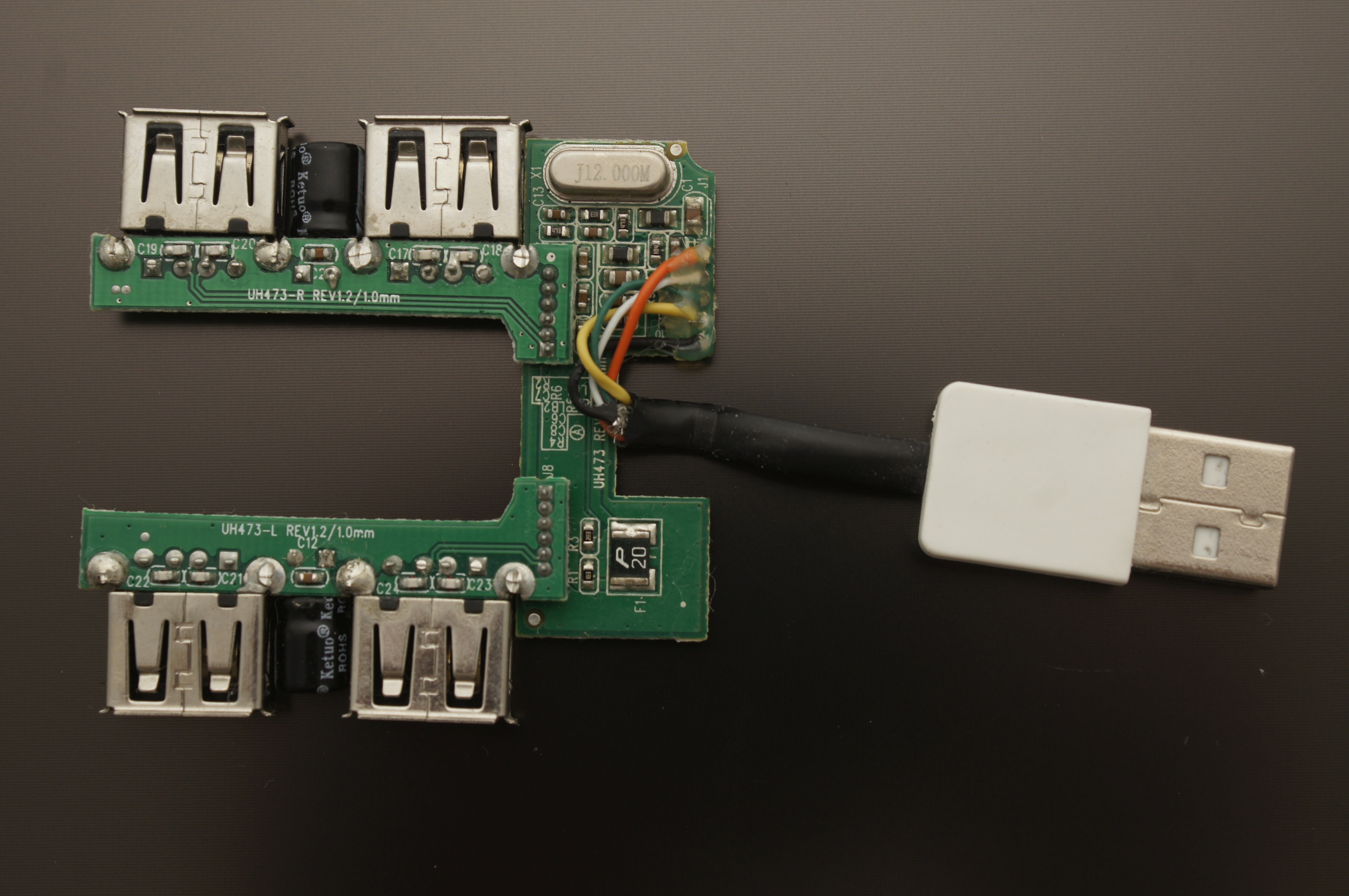

    Probably the USB HUB is to blame, for example, on an ordinary OTG, I connected the USB HUB and the CAMERA and PENDRIVE to it, and this and it works. Of course, under the samsung galaxy s4.
    malaoko wrote:
    You can upload a link or photo to your hub.
    I have a UH473 on the GL850G chip

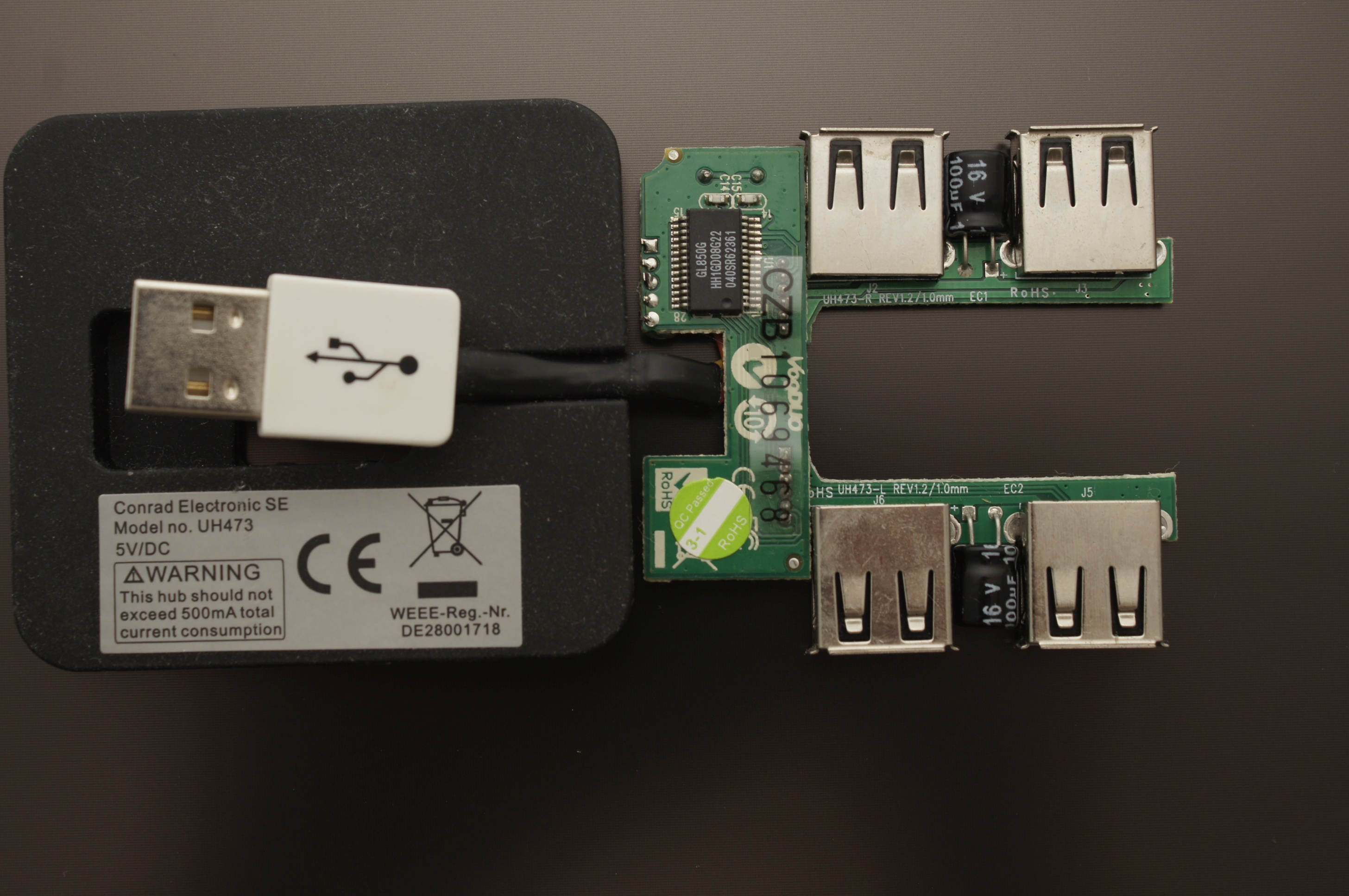

    Above I threw a cable diagram, you can look.
    I bought one and it had a processor inside, when I measured it with a cable continuity meter, if I put it on the DATA + input, there was no continuity on DATA + behind the processor on the usb inputs. It seems to me that this processor just goes crazy. You can upload a link or photo to your hub.
