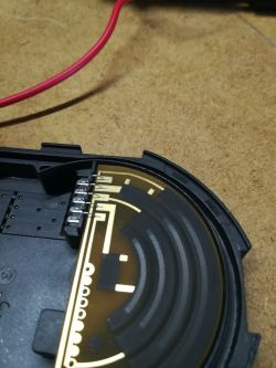

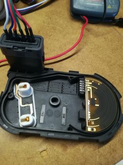

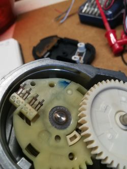

Throttle potentiometer wear inside the Bosch unit. The wiper scrapes resistive tracks, causing signal dropout and A/B mismatch (P0121/P0122). One owner saw failure after 28,000 km in two years. This can also cause sudden power loss in traffic. [Elektroda, tunek, post #18848400]
Is there a temporary repair for a worn throttle potentiometer?
Yes. Open the throttle, clean tracks with isopropanol, and shift the brushes about 0.5 mm to unworn paths. The car then “runs like gold,” but lifespan is limited. Replace any wet or loose connectors during reassembly. [Elektroda, tunek, post #18848400]
