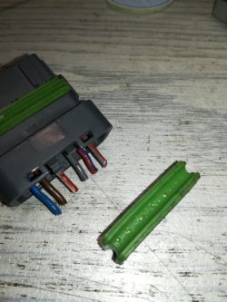

    It was exactly the same. 1.6 16v engine. I changed the throttle plug. I bought a new one with earned wires and soldered. After tearing the old one apart, I see a lot of moisture. This plug works with very large temperature differences and has been able to suck moisture from the air over the years. Resistance was measurable in ohmmeter over the 20 kilo range. I finally see something that could be causing error P0121. Changing the accelerator pedal or cleaning the new throttle did not have a long effect. Now I have a few days to wait ... Best regards to sour apple lovers. Peugeot 307 Error P0121 - Antipollution Fault, Throttle Potentiometer Issues & ELM327 Tester Peugeot 307 Error P0121 - Antipollution Fault, Throttle Potentiometer Issues & ELM327 Tester

    Can you give a picture of the contacts from this plug?

    There was water, I changed the plug, the error reappeared. But I will follow this lead. I will dismantle the plug from the gas pedal and leave it in the sun for a few hours. If it does not help, I will dismantle the plugs at the computer. It must be the same ...
    Light of Winter .. I bought a plug in a well-known portal ...

    Gas pedal plug suspected of breaking contact. I cut it off evenly, one of the middle pins did not hold the test pin. It was strangely bent. It is obvious that the contact with the pedal pin is a coincidence. He had no chance of some signal transmission. I replaced the contacts from the plug I bought with the unfinished one along with the throttle plug. I soldered the wires in the right colors. In the trash I had a very decent complete connector for Led lighting, which I used to connect the extended pedal prosthesis with the installation. So far it works, wait for further reports. No information .... That's good news for sour apple lovers ....
    And yet .... the definitive solution is different ... look at my answer to the post https://www.elektroda.pl/rtvforum/topic3366979.html#16633304
