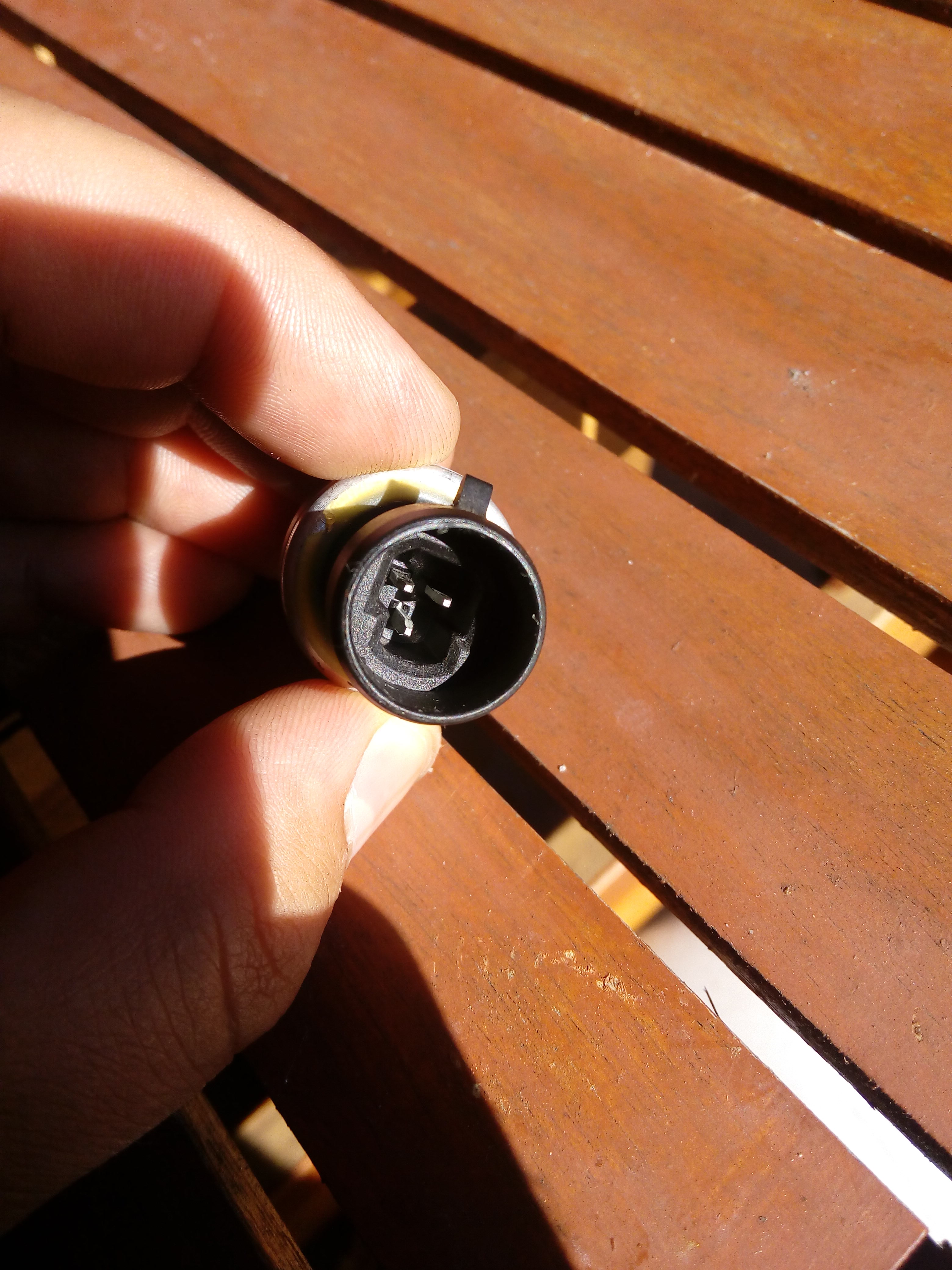

    Bieda z nędzą wrote:
    Sensors come in two types, if we are talking about three-pin. One generates an analog signal, i.e. pressure / voltage. The second works by impulse, i.e. pressure / filling the waveform.
    The sensor is 3-pin, made in mexico (hehe ...) unfortunately I can't read any symbol from it.
    I am adding illustrative photos showing the sensor.
    Suzuki Swift 1.3 DDiS, 2008 "the climate is not working ..."IMG_201708...161212.jpg (1.43 MB)You must be logged in to download this attachment. Suzuki Swift 1.3 DDiS, 2008 "the climate is not working ..."IMG_201708...161220.jpg (1.43 MB)You must be logged in to download this attachment. Suzuki Swift 1.3 DDiS, 2008 "the climate is not working ..."IMG_201708...161231.jpg (1.63 MB)You must be logged in to download this attachment.
    Edit - symbol read - ordinary common GM sensor
    9131721
    Photo 1, medium pressure 0 bar. No controller will start the compressor.
    I will come back with a question from the first post.
    Should the computer convert the voltage (which it receives from the sensor) to pressure (say 5bar) or is it a task for another system?
    Poverty with misery, can you give something more about the type of sensor after the GM number below? You wrote about two types before. Is there any sense to buy another sensor if giving 5V artificial voltage did not bring the expected effect?
    grala1, I have already run out of ideas :(

Quick 3‑step: how do I sanity‑check the Swift’s A/C pressure signal path?
  1. Read live data: confirm ECU sees A/C request and shows sensor voltage.
  2. Measure the sensor pin: expect about 1–1.2 V at low pressure.
  3. Carefully simulate higher voltage and watch for commanded fan/clutch. Document results for ECU/wiring diagnosis. [Elektroda, jimorrison, post #16645491]
What’s an edge case that can mislead pressure diagnostics?
A scan tool may show 0 bar because it cannot convert that ECU’s voltage to pressure units. In such cases, rely on the raw voltage and a dedicated scan to judge pressure plausibility. [Elektroda, grala1, post #16646299]
Bottom line: what should I fix first on a no‑cool Swift like this?
Restore factory wiring, verify the correct 3‑pin sensor type, and confirm the ECU sees valid pressure/temperature inputs. Only then test outputs to the clutch and fan. Avoid bypassing the clutch to ignition to prevent relief‑valve venting. [Elektroda, jimorrison, post #16635646]
