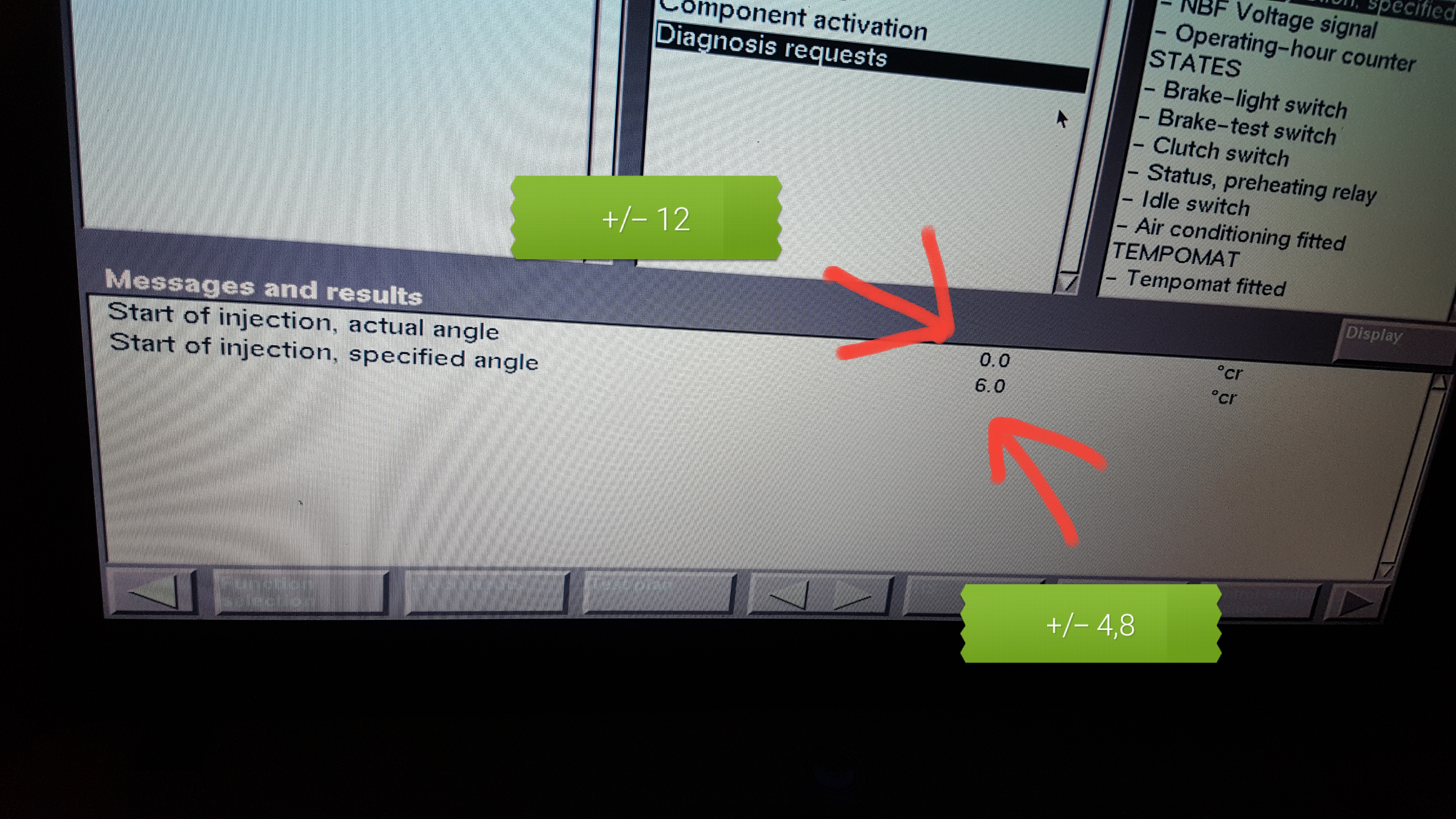

    Hello, I have a problem. I had to pull the engine in my BMW because my crankshaft broke. Everything cool, the engine starts, but there is no power.
    DISem checked the injection pump and something like the picture came out.
    Now the question is how to set up the pump? Is the pump on a wedge or not? Disem or impem check the timing?

    Hello, today I set up the pump with DIS, and the car works theoretically as it should, fires from an arrow, spins on the turn, etc., but something kicks. In DIS, both fuel pump values were close to each other +/- 7
