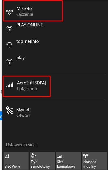

    Is vpn server simply a cloud with the address xxx.sn.mynetname.net?
    This is what I have started. I have created vpn on the computer but it connects as soon as I'm in lan.
    Mikrotik 951G - Remote Access using USB Modem, Variable IP, PPP Client & DDNS/NO-IP Solutions

    Run yourself quickly in "Quick set" VPN Access, because I suppose you don't have it set. Set up PPTP VPN on your computer quickly and there is no whip. You must connect.

    And what do you have in the Winbox address field when you are out of lane?

    Hmmmm ....
    https://wiki.mikrotik.com/wiki/Manual:IP/Cloud
    from what I write here, cloud is a DDNS service, unless I have not understood something
    ddns it will not help to get to MT from outside, for this you need a public IP (permanent or dynamic) or vpn tunnel with public IP at the end of the tunnel.

    @whizzo, and what I didn't write there ... ;)
    @bogiebog
    I'm afraid you're right and no other combinations will help.
