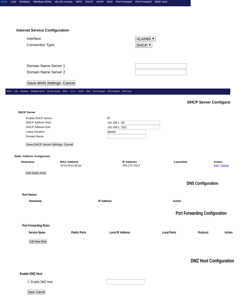

    I have an optical fiber from the operator INEA. The supplier provided the Genexis Titanium-48 station to which I connected the ASUS RT-AC750 router with the disk. Additionally, I purchased the "Public IP" service, which is active and working.
    On the ASUS router I have IP NAT 192.168.1.168, and I would like to start the DDNS service, which involves setting a static address due to an error:
    Spoiler:
    "The wireless router is currently using a private WAN IP address. This router may be in a multi-NAT environment, and the DDNS service cannot work in this environment."
    How to live, dear users? Attempting to set a static IP causes the connection to be blocked and the Titanium-48 main station is cut off from NAT. Switching to AP causes the inability to log in and nothing works without restoring the factory settings.
    Disabling DHCP on a station that automatically assigns 192.168.1.168 does not help. I am asking for help, because my knowledge has run out, and the networks somehow did not turn me on ...

    After all, this Genexis is a router, so it assigns Asus a private address. You have to put it in bridge mode best.

    In this case, assign Asus on Genexis a permanent MAC address, then enter it in DMZ. Then run DDNS on Genexis.

    Thank you, gentlemen, for the offer, unfortunately it still does not work ... Support as standard, only the first port, further questions ended with answers like yyyy, eeee, oooo. He offered me a public IP address service that I have running. The first port is used for the bridge.
    User manual:
    bridge mode - the device connected to the Ethernet 1 port gets a direct connection to the external network. There is no WiFi connection available for this mode. It is not possible to log into the device management page. This is the recommended operation mode when using an external router.
    So why do I have access with the ability to run WiFi on 192.168.1.1?
    I did, doesn't help.
    sosarek wrote:
    The operator does not block ports?
    Consultant response: yyy, eee, ooo - only the first port. Yes Yes...
    I'm throwing screenshots:
    Setting Static WAN IP on ASUS RT-AC750 Router via Genexis Titanium-48 Modem for DDNS Service Setting Static WAN IP on ASUS RT-AC750 Router via Genexis Titanium-48 Modem for DDNS Service
    I am even willing to pay for remote assistance because I have wasted several hours.

    Since you are to get a public address on the first switch port, this is how it should be. You currently have router mode, not bridge mode, so you get a private address.

    I listened, I did not regret it. It took 40 seconds and grandmother knew what was going on. They had to remotely run the bridge. Reboot main station and everything works. So much time wasted ... life.
    Thank you gentlemen for your help.
    For the future for others INEA:
    - Connecting an external router to Genexis Titanum-48, you have to call and say that you want to start the BRIDGE service.
    - External address for viewing, for example, a camera from any location or external drive - launching the "Public IP address" service PLN 5 per month.
