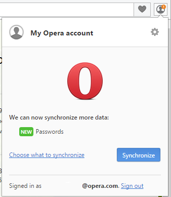

    Naturally, the most effective way is to set up an account in Opera Sync and use the tabs, history, cookies, passwords, etc. in the operatic cloud.
