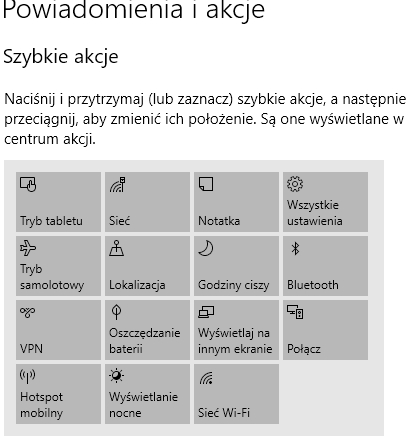

    I had some computer infections recently but Bitdefender and Malwarebytes have dealt with it.
    And now I do not have the so-called action center I don't know what happened.
    Action Center Not Working in Windows 10 Pro: Bitdefender, Malwarebytes, Post-Infection Issues
    And in the options it looks like it's turned on but not highlighted, like in the picture.

    I used to have a similar situation to you, if I am not mistaken, such solutions helped:
    Commands:
    1.sfc / scannow
    2. Get-AppXPackage -AllUsers | Foreach {Add-AppxPackage -DisableDevelopmentMode -Register "$ ($ _. InstallLocation) \ AppXManifest.xml"}

    For now, I have entered the first command and something is scanning there.
    Added after 26 [minutes]:
    He found nothing on the first command.
    And on the second, he writes that he does not recognize this command.

    Both commands, especially the latter, should be done in Windows Powershell
  • #7 16681863
    Matuzalem
    Posts: 17330
    Help: 1653
    Rate: 1101
    Speaking of Powershell, instead of "fixing" embedded applications better, IMHO, will use the command: DISM / Online / Cleanup-image / Restorehealth (Powershell running with administrator rights, in case of application repair also). After the procedure is completed you can repeat sfc / scannow (from CMD with administrator rights).

    I have used Cmd and Powershell and nothing helped.
  • #9 16752889
    wertiko7
    Posts: 606
    Rate: 100
    I've tried everything, but only restoring the old Windows helped.
