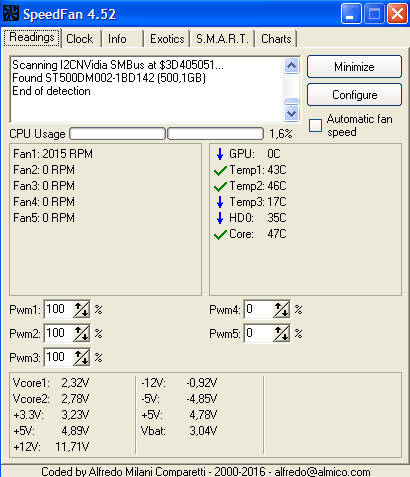

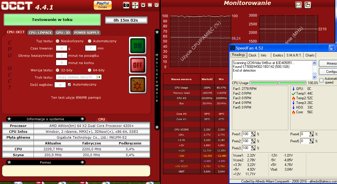

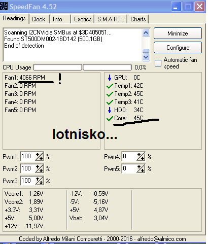

    My Procek processor it's Athlon 4200+ dual core x2 64. The problem is incredibly loud windmill fan on the heat sink. Fan Fan I greased, cleaned. I changed the paste yesterday, it's ok, the temperature has dropped a bit, but the speed at computer startup is 2900 at 35-36 degrees. Then it is only worse and often reaches 4000 and so I have a small airport at home ... Anyone know what temperatures for this processor are ok?
    I immediately say that it is not the fault fan fan or paste because fan fan can go work quiet and currently I have 2064 turns, so it's quiet. Only thanks to the fact that in the Everest program I click on the computer at startup -> sensor. And then it's ok, I can work in peace. But it is enough to restart the computer and there is an airport ... Anyone has any idea why my computer forces high speed so strongly windmill fan ? And at 47-48 degrees, so in my opinion quite ok.
    https://obrazki.elektroda.pl/2613110500_1492857969.png - the airport
    AMD Athlon 4200+ Dual Core X2 64: Processor Fan Noise, Speed & Temperature Range Inquiry - under the OCCT load and the Everest revs program enabled
    AMD Athlon 4200+ Dual Core X2 64: Processor Fan Noise, Speed & Temperature Range Inquiry - airport, after restarting the computer and running speedfan after the OCCT test.

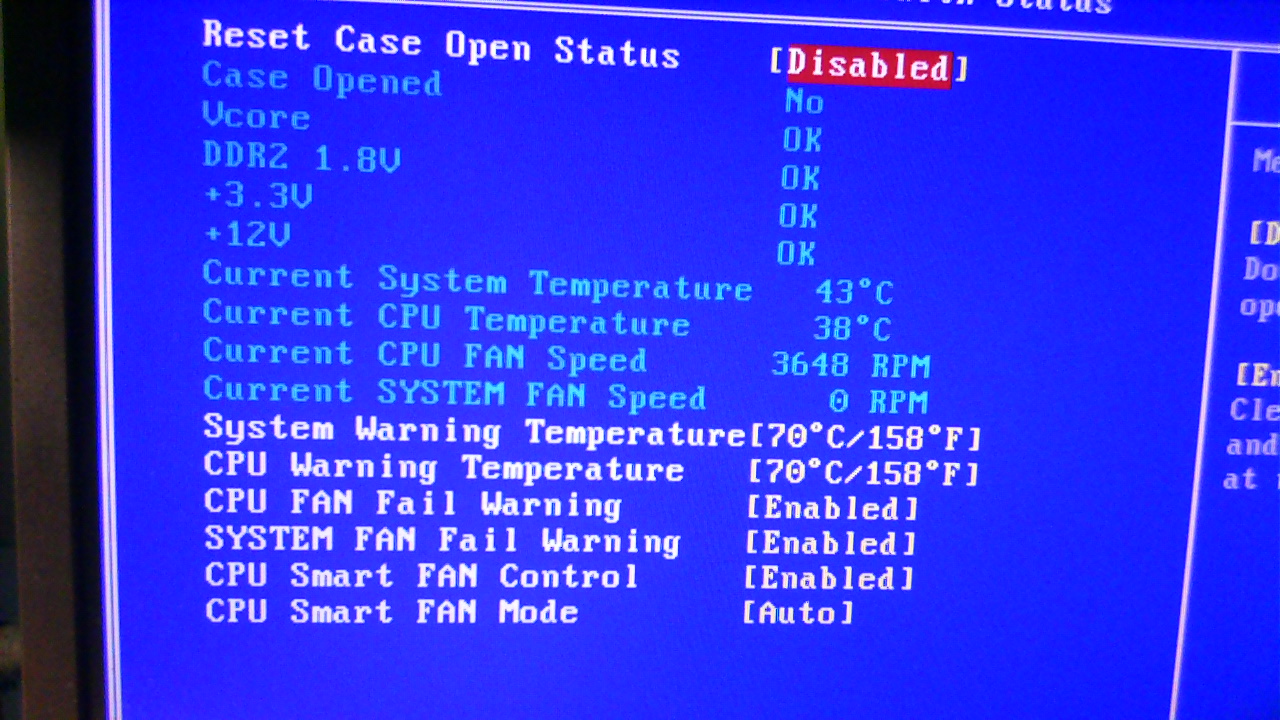

    Little is known about a computer colleague, the board model can be taken from the OCCT dump, so the first question - what are the BIOS settings for cooling operation?
    It is about CPU Smart Fan Control and CPU Smart Fan mode.
    Of course, the first should be on Enabled, and the second - depending on your cooling, which you do not know about. It is probably some small and loud cooling judging by the fact that at full speed it exceeds 4k RPM. Theoretically, Mode should set itself to AUTO and count on the fact that the BIOS from the machine will select the correct mode of operation. Theoretically, this mode should be set to Voltage for a three-wire fan, and PWM for a four-wire fan. Instead of the AUTO mode, if you have a fan with four wires, I suggest checking the behavior in turn on PWM, if it is wrong with Voltage, and in the case of a fan with three wires, I suggest checking the Voltage setting.
    It may also turn out that the hob does not like to set such low revolutions that a friend would like to have (or rather the fan with the current control from the plate is not able to go down so low), here at a friend's place I would simply buy a cooler with a smaller and quieter fan. Recently, I bought a used SilentiumPC Spartan PRO for a friend for PLN 40 (a new one costs 2x this much), because its board had a defective speed control. Compared to the original low cooling Spartan at full speed was barely audible.

    In the bios I have:
    What to change?
    It was quiet at first, the paste has dried up during these few years, but today I replaced it with arctic mx-4 and it is better when it comes to temperature. But still at 41-43 degrees the system gives it 3.5k turns, only after firing Everest it changes to 1957 and it's good.

    I checked on Voltage but it's the same. So maybe I will ask differently: is the temperature for this processor at rest 45-46 and 57 at 100% load is ok or too much? You can see the charm of this processor with age, Ultimately, I could spend a few zlotys and buy a new fan for the heat sink, but can I buy the fan alone? And what do you recommend?

    even under the occt at 100% load reaches 57 degrees so I think it is good, the paste exchanged gave a lot. Thanks for the help.
