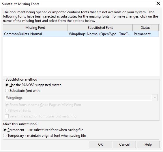

Why does my text disappear or shift when converting to PDF?
Your system lacks the original fonts. Corel flags missing fonts on open and proposes close matches. Accepting substitutes changes metrics, which shifts or reflows text. To keep layout, install the missing fonts or convert text to curves during export. In tests from the thread, converting showed graphics intact while text misbehaved due to fonts. [Elektroda, Anonymous, post #16672040]

How can I avoid layout breakage from missing fonts?
Before export, install the exact fonts used by the CDR. If that’s impossible, accept Corel’s suggested replacements and convert text to curves on export. Keep a copy with live text for future edits. Edge case: substituted fonts can force all text onto one line in some importers. [Elektroda, Stef, post #16668181]
