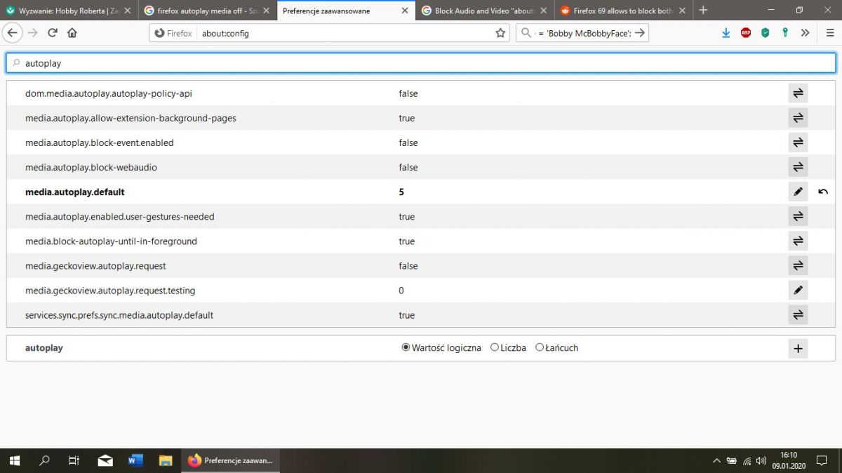

    FlashStopper also blocks html5.

    The above method is not always sufficient. Below are my autoplay settings on Firefox 72 in the about: config setting
    These settings work on both PC and Android, which makes life very pleasant. There are no clearly described settings on the Internet so that it can be found easily, but this thread is well searched, so I present on the screenshoot settings for disabling automatic media playback.
    (switch off autoplay media on Firefox PC and Android for "about: config" function)
