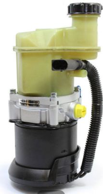

    I have a problem with power steering on my Clio II Ph1 from 2000.
    At some point, suddenly, without any symptoms, the support stopped. There was no hum, screeching etc. It was just as if someone had cut it off. The pump is electro-hydraulic.
    I started with an electric diagnosis. Fuses ok. However, I found one 50 A relay in which the coil was shorted. After applying the voltage, the meter showed 50 A. I was glad and bought a new (used) relay. I installed and ... unfortunately nothing helped. I checked the relay to make sure it was operational and functional.
    I went further and checked if there was voltage in the relay connection - there is. I disconnected the pump plug and the voltage on the plug is there. The transition on the pump is. And now I'm stuck because I don't know what to do next.
    I would like to add that 2 years ago the pump was regenerated (then the bearings died).
    At the moment, I am not going to take the pumps for regeneration again because in my opinion, this is a "crap" and they will delete me as for grain.
    Can anyone have an idea where the problem is? My guess is pump, maybe brushes or something? I'm not an electrician, so maybe someone will suggest something.
    In addition, during the diagnosis of the pump, I found a broken cable. It broke right after the "pin" connection and I can't find the break point ... I don't know if this cable can affect the pump. Below are photos of the cable.

    The pump is electro-hydraulic like in the picture below. I do not have my copy number. The pages contain the following numbers: 7701470783; JER120; DSP706; 04550500
    Renault Clio II 1.9d 2000 - Sudden Power Steering Failure, Electro-Hydraulic Pump Issue, Relay
    So the cable is of little importance in this case. Thank you.

    Pump motor connected briefly turns? Communication with the driver is?

    Power the pump and see if it spins, there is no electronics there, so if it works, it will start.

    @mazi_dg He has already written a constructive comment @robokop . I'll join you. Build the pump, connect it to the battery (pay attention to polarity!). If it does not work, use a wrench (8 or 10), disassemble the pump and check the condition of the brushes, commutator and bearings. Merry Christmas. :D And after Christmas, buy new parts.

    If you have a "transition" on the pump motor, and when connecting to the battery, it will strongly "spark" -
    the pump thus announces that either the rotor is burnt, the bearings are seized, or that the entire pump is seized, or the stator magnet has come off and the motor is blocked.

    the holidays are over, the failure was resolved, but from the beginning.
    After the above tips, I connected the pump for a short time and to my surprise, the pump started. I was struggling with my thoughts about what to do, whether to dismantle the pump and disassemble it myself, or maybe give up and give the pump to a mechanic. I chose option two due to the fact that if it is not the engine, I may not solve the problem myself.
    I also took the car to a mechanic and it turned out that the pump failed in the transmission between the engine and the hydraulics. Apparently, the shaft broke off and had to be replaced. The mechanic replaced the unlucky part and all the hydraulics and gave a year's warranty. The total cost is PLN 450, for information.
