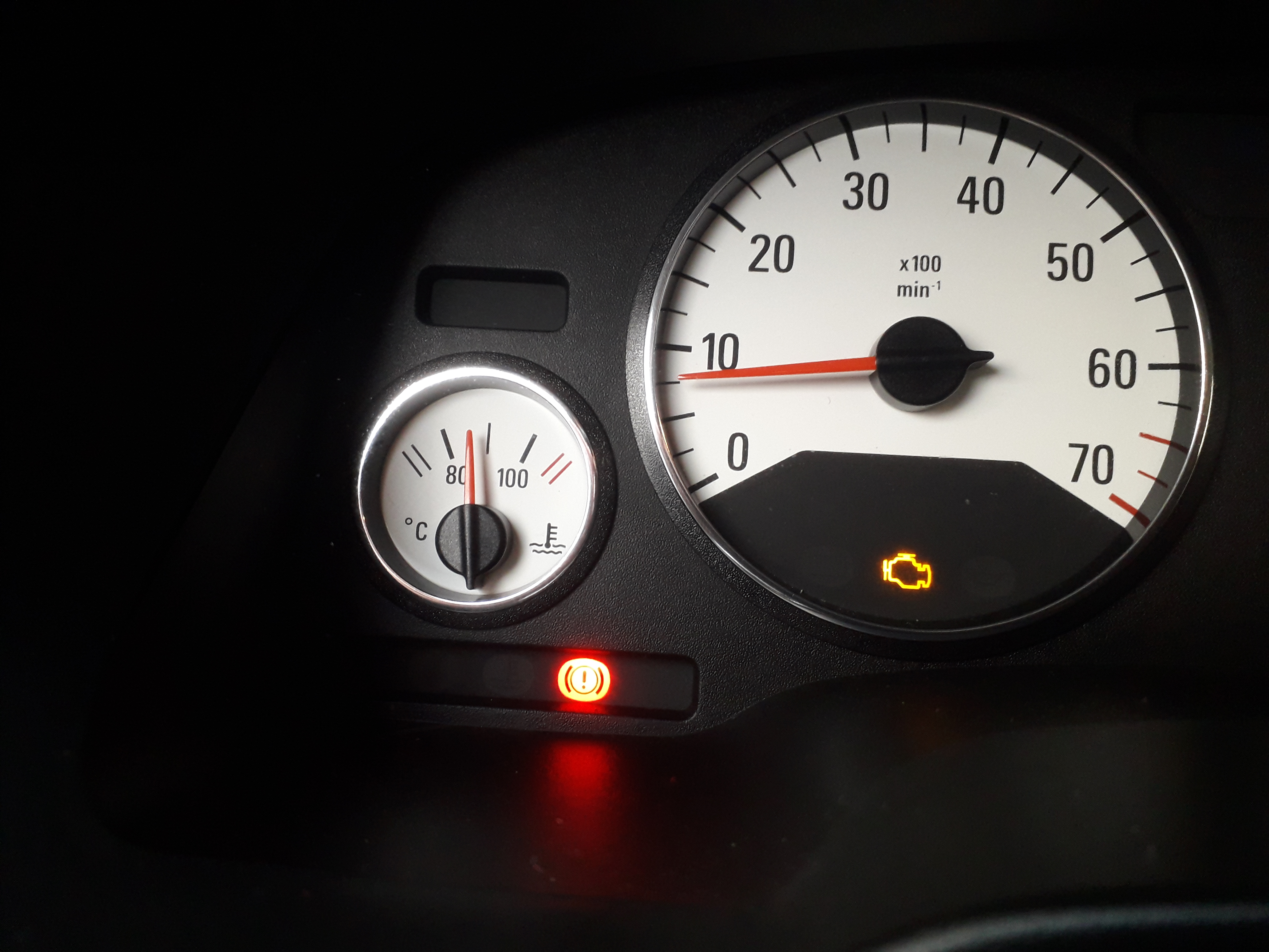

    Hello, while driving, the check light on the board and on the display came on and the message too little coolant. This surprised me as the fluid level was not in a dire condition.
    The fluid has been refilled, the check is still lit. I noticed that the fluid level message appears above 120km / H. And I think it keeps the temperature too low. I'm throwing a photo. Do you advise or for a computer.
    • Opel Zafira 1.8 125KM Check Indicator: Coolant Alert & Low Temperature (Photo Included) 20180519_195106.jpg (3.61 MB) You must be logged in to download this attachment.
  • #2 17230639
    Pedros050
    Posts: 17914
    Help: 2471
    Rate: 3926
    Hello. Connect it to a diagnostic device and read errors.

    And the temperature of the liquid should not be higher ???
  • #4 17230907
    Pedros050
    Posts: 17914
    Help: 2471
    Rate: 3926
    And a photo taken on a hot engine? Has the fan cooled down to this temperature?
  • #5 17230939
    andzej789
    Posts: 787
    Rate: 160
    On a warm one after driving 15 km
  • #6 17230959
    Pedros050
    Posts: 17914
    Help: 2471
    Rate: 3926
    Warm up the engine while stationary, because when driving, the temperature will always drop even when the fan on the radiator is running.

    temperature ok (I have too)
    reading error codes because otherwise they are reading coffee grounds.

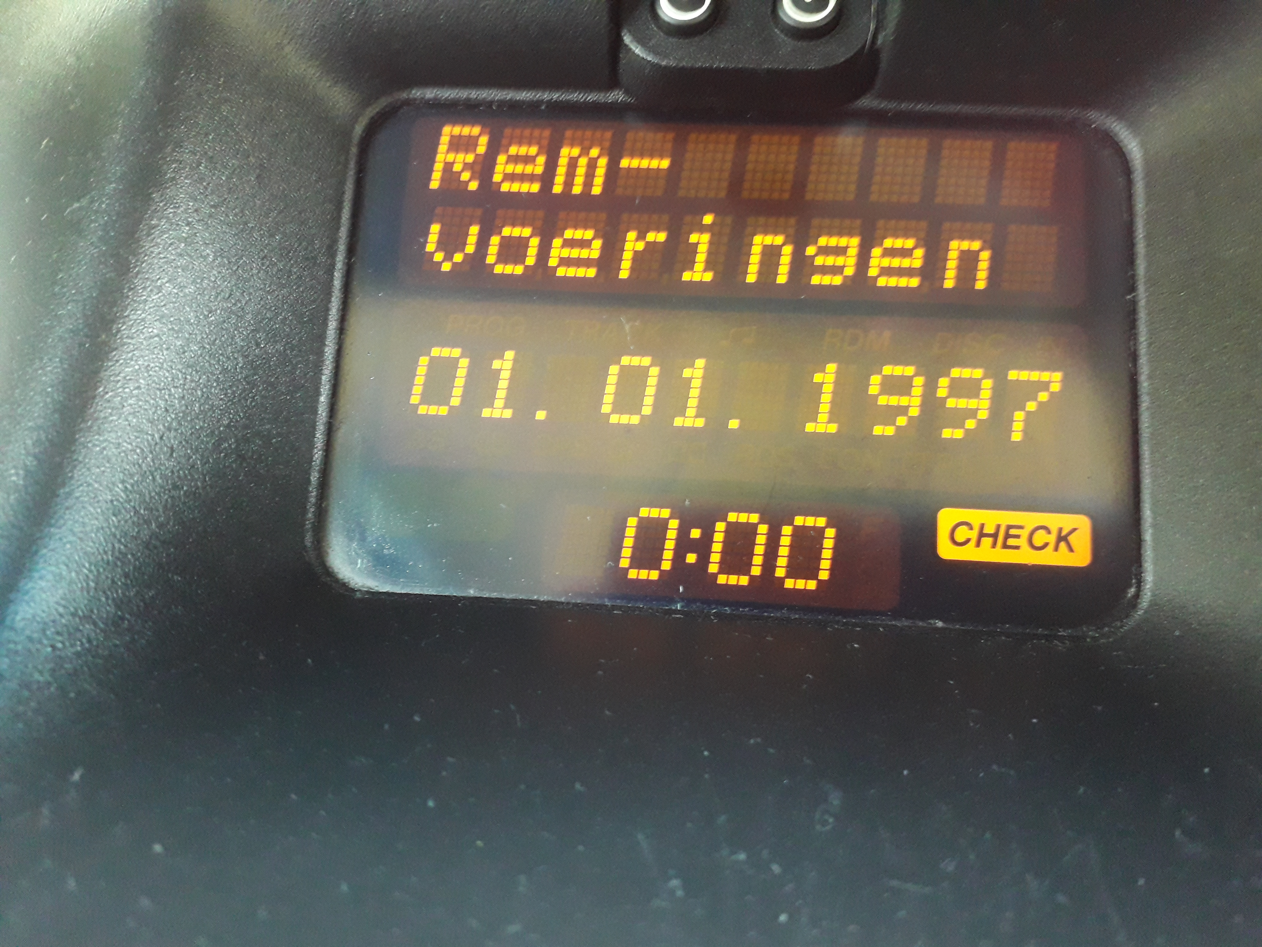

    In addition, a new message popped up, I throw a photo. I know that means little cladding on the blocks - although the blocks are thick.

  • #10 17236702
    g107r
    Posts: 5283
    Help: 811
    Rate: 993
    And it shouldn't be like that? Rich, poor, rich, poor ...?
    How does a lambda probe work?
    Of the simplest ones, with thick blocks it can also mean a broken cable from the block.

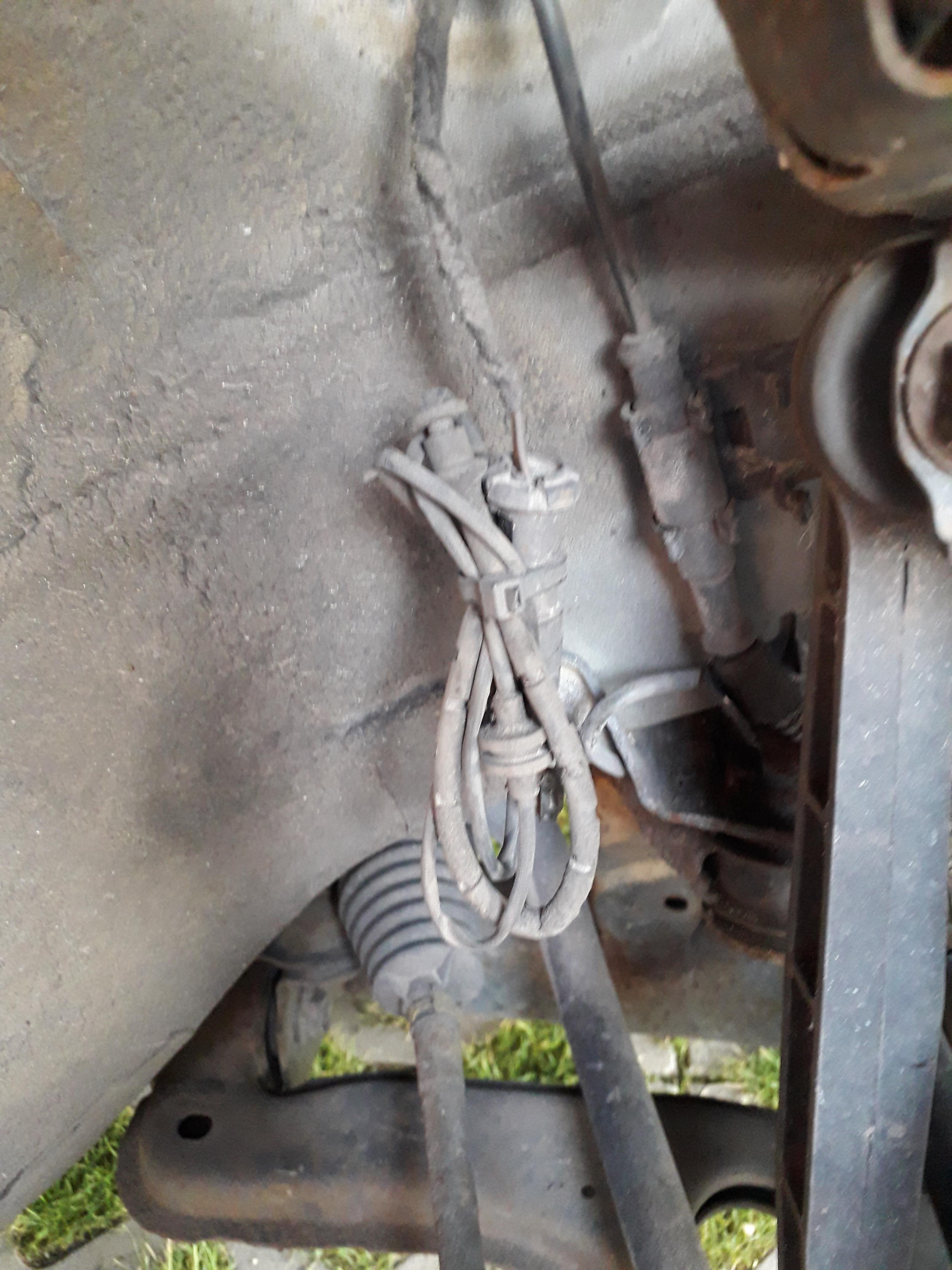

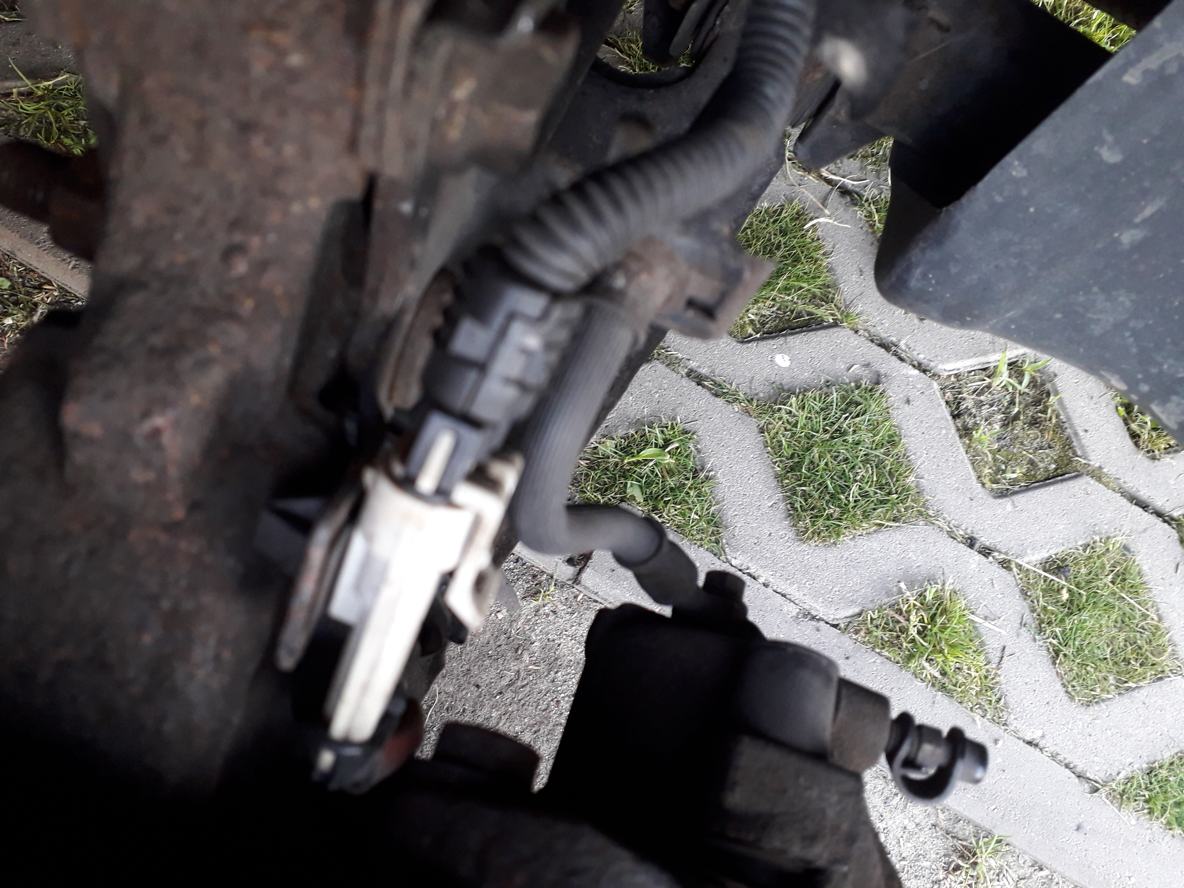

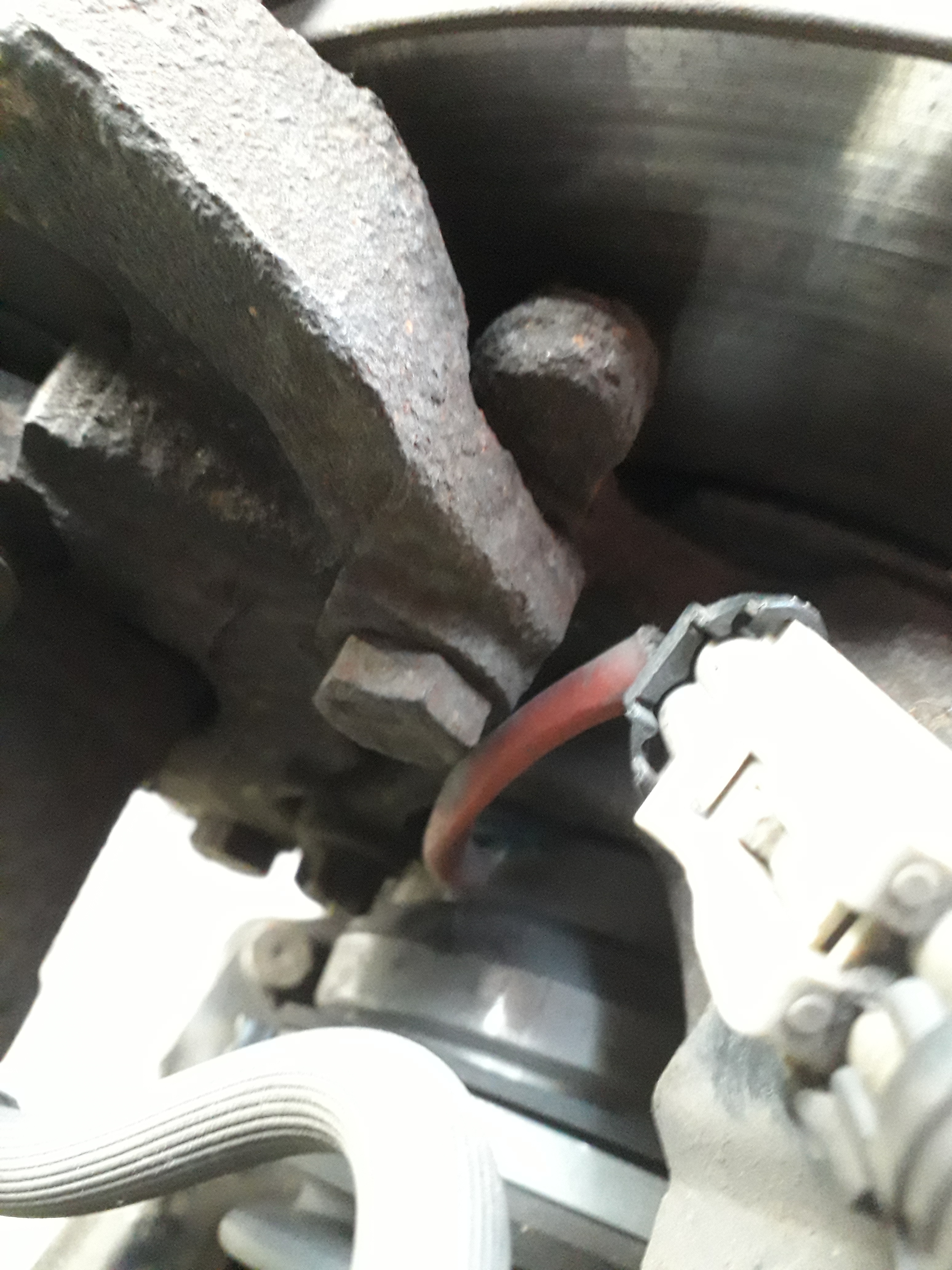

    I checked the wires in the front wheels are whole. I do not see the interruption or other faults ... there are also sensors on the back ?? photo ... Opel Zafira 1.8 125KM Check Indicator: Coolant Alert & Low Temperature (Photo Included) Opel Zafira 1.8 125KM Check Indicator: Coolant Alert & Low Temperature (Photo Included)
    Added after 11 [hours] 28 [minutes]:
    Is it a pad wear cable?
    • Opel Zafira 1.8 125KM Check Indicator: Coolant Alert & Low Temperature (Photo Included) 20180524_191927.jpg (1.18 MB) You must be logged in to download this attachment.
  • #13 17239604
    Pedros050
    Posts: 17914
    Help: 2471
    Rate: 3926
    Yes. Exactly.

    And where to connect them ... there will be a place for the terminals ??
  • #15 17240151
    Pedros050
    Posts: 17914
    Help: 2471
    Rate: 3926
    The sensors are on the brake pads and the plug should be plugged in there.
  • #17 17240189
    andzej789
    Posts: 787
    Rate: 160
    But it should be the input in the blocks ?? So some special ??
  • #18 17240193
    Pedros050
    Posts: 17914
    Help: 2471
    Rate: 3926
    The blocks for the sensors must be there.
