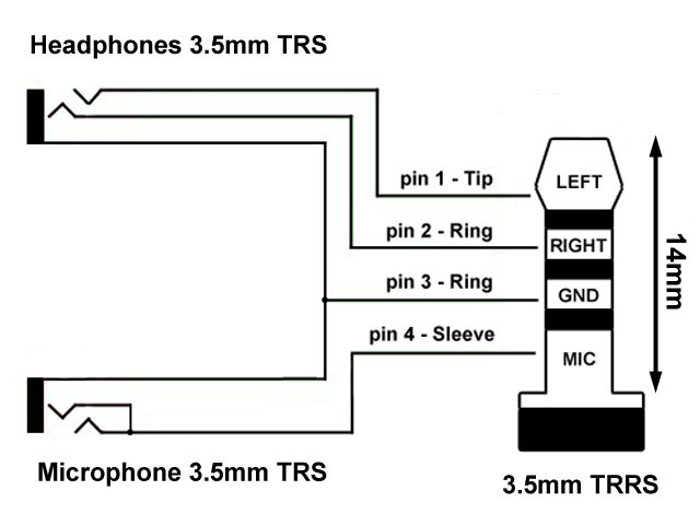

    Other (comments): I am looking for a pattern like "delock", which I found on the Allegro. I would like to use it for headphones from a phone and a laptop that has a separate headphone and microphone output.

    Is that it
    Delock Schedule Mini Jack 4 Pin - Headphone & Microphone Adapter for Phone & Laptop Brands/Models
