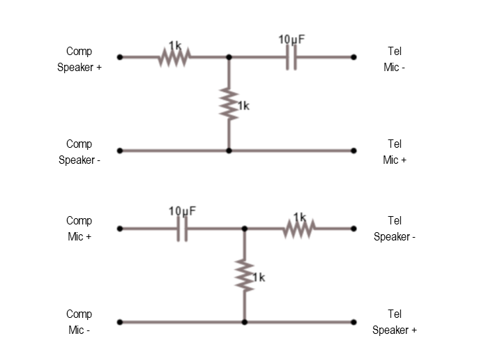

  • Clarifying feasibility of desktop audio jack to handset port
    #1 21681780
    Lukas Wraigth
  • Use capacitors and 1 kΩ attenuation if needed
    #2 21681781
    David Ashton
  • 600 ohm isolation transformers are required
    #3 21681782
    Rick Curl
  • #4 21681783
    David Ashton
  • 10-ohm summing resistors and 600-ohm transformers
