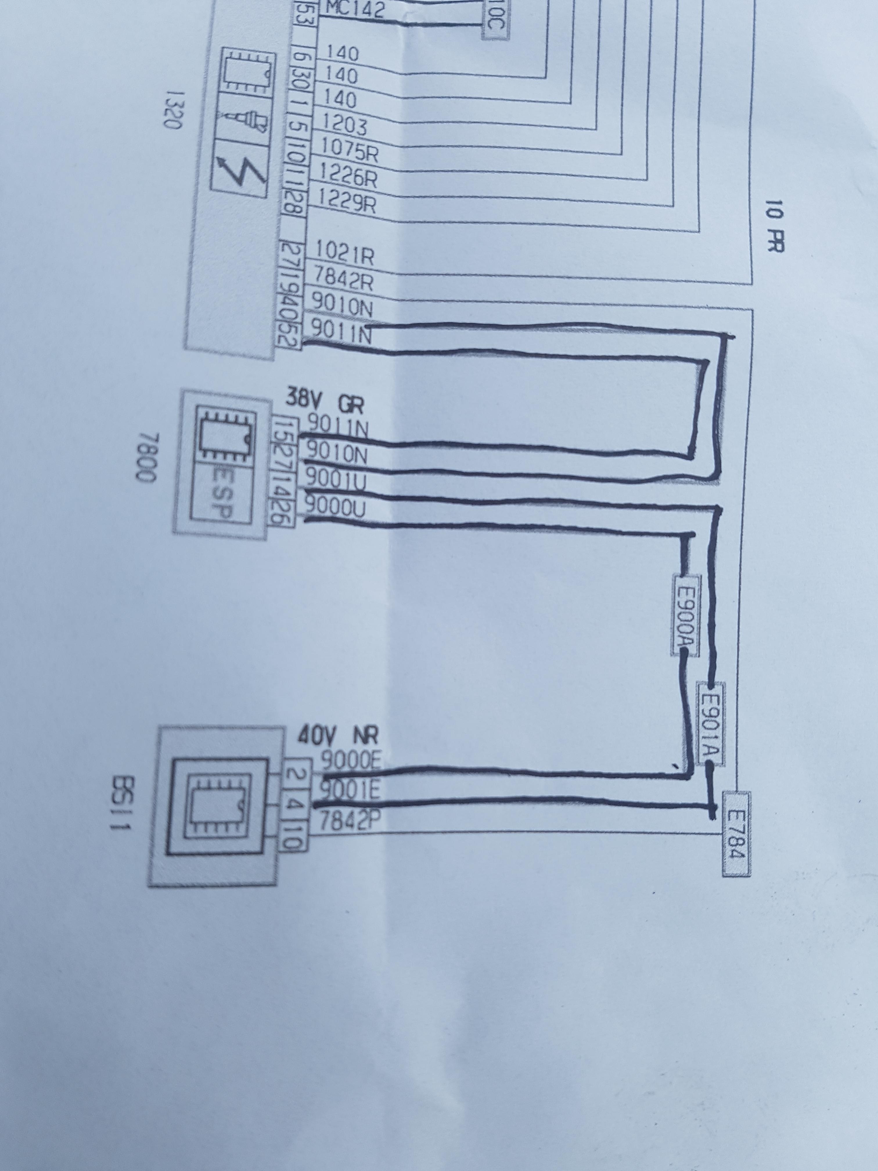

    The car went out suddenly without warning at the traffic lights, and it does not start, but only turns. A car from a Polish showroom, the other owner has not had any fumbling before.
    After connecting the diagbox:
    The main error and the cause is the one from BSI:
    F527 Fault, coded immobilizer: transponder recognized but
    engine management ECU blocked
    The keys are recognized, the immo is deactivated when the key is inserted
    In addition to this error, a lot of additional ones pop up from the section: injection / ignition, but I think it's the communication fault
    and communication error in the ABS department:
    U1308 Fault - No communication with the engine control ECU.
    What I did:
    I bought a fresh ECU and downloaded all "old ECU" to the one I bought and the result is identical, fuses checked, etc. but as it was, it is - the flap.

    Ok, I understand that I need to check the cables for the damaged ECU, I wrote that I bought a second one and copied the "old" ECU for fresh without a result. Besides, if you managed to connect the ecu to bdm100, then both drivers are ok.
    I tend to check the installation, but I wonder how best to do it, physically or with instruments? Begin at the engine or dashboard side. I have not checked the installation "electrically" before and I do not have a device other than a multimeter :) I know that lexi has the option of a multimeter and an oscilloscope, but for this you also need additional accessories
  • ABS/ESP link likely faulting engine ECU communication
    #6 16689888
    grala1
    VAG group specialist
    Posts: 9823
    Help: 1495
    Rate: 5052
    I have only given you the possible reasons.
    You have communication with BSI and communication with the engine calculator is with BSI via the ABS / ESP controller.
    Enter the letter designation of the engine or VIN number, whether the car has ESP or only ABS, it will send you a diagram.
    You have to disconnect the battery and check the transitions between the BSI and the engine ECU - this can be done with a gauge.
    It is best to start with the measurement of BSI - ABS / ESP, and then ABS / ESP - engine calculator.
    Since you do not write anything about the problem with ABS, it is rather a problem in the ABS / ESP part - engine calculator.

    So I would start by checking the plugs on the ABS / ESP controller, then checking the wires between BSI and ABS / ESP.
    In the attachments there are diagrams and locations of elements and plugs from the diagrams.
    Remember to disconnect the battery before disconnecting any controller in the car - do not disconnect / connect the plugs of the drivers under the power supply.
    I understand that there is only a problem with communication with the engine ECU and with ABS / ESP.

    Unfortunately the connections are fine :( I checked the connections in the picture that connect ecu, bsi, esp. I checked with a sound multimeter, disconnected the sockets and an example to the appropriate pubs in ecu, esp, bsi and there was always sound. I will examine the sockets and connectors, I will assemble everything and see because I noticed that the esp plug lock was broken, maybe it did not go all the way. I'll let you know

    Check the power to the ABS / ESP controller.
    You can make a bridge on the ABS / ESP controller plug, i.e. give two jumpers on the CAN line so as to bypass the ABS / ESP controller. As you can see in the diagram, this driver communicates to the engine controller.

    Buddy, and how do you see that the power supply goes there on this diagram because I do not understand. Of course I can check with the meter where it gives 12v after ignition? And then connect it directly to the battery? I can only rummage on Saturdays so during the week I collect info on what might be wrong.
