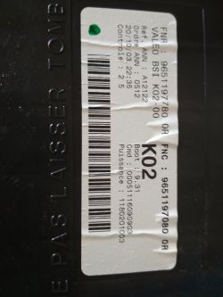

    Hello!
    I am asking for help in repairing the Peugeot 307 1.6 benz year 2003, the car went out and did not start anymore. The left window as it was open has remained so, the blow-in, windows, windscreen wipers, low beam and high beam lights do not work. I checked all the fuses are good, the only thing is the lack of voltage on F2 F1 marked in the figure.
    The fuel pump starts after turning the ignition switch, but there is no voltage on the coil even when the starter turns. Central locking works.
    My questions are as follows: Are the paths burned in the bsi and there is no voltage on the fuses and then maybe on the electronics of the bsi as seen in the attached drawing.
    Can I buy used bsi with the same numbers and can I change the memory, can I buy the whole plate with the green memory?
    Do you buy a set of keys, bsi and ecu and do they have to be the same numbers as the old ones or can they be different just to make the engine fit?
    In a few days I will have an interface with the Lexia program, which I should check at the beginning.
    I am a hobby electronics engineer and I have some time so I want to start this car. Thanks for the help.

  • #2 17259348
    ziolek13
    Posts: 18
    Hello. Recently I had a similar problem with my Peugeot. Bsi is blocked from here this car behavior. You can't do anything without the cable. I blocked the engine computer. The mechanic replaced one element that blocked the car from starting. Then he taught the bsi and the car still goes today. Now I'm waiting for lexia to do something on my own. Regards
  • #3 17259601
    mruko
    Posts: 91
    Rate: 10
    What did the mechanic mention, it is not known?
    It may be blocked bsi, but on these fuses the diagram shows that the voltage should always be.
    I am still waiting for the cable.
  • #4 17259631
    rs07
    Level 20  
    Posts: 472
    Help: 33
    Rate: 166
    The figure shows that F1 and F 2 are powered by a F4 70 A fuse. Do you have voltage on F 9 and F 14?
  • #5 17261440
    mruko
    Posts: 91
    Rate: 10
    There is voltage on these fuses, so I suspect that there is a power outage, assuming that bsi is made as shown.
