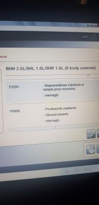

    Hello. When overtaking on a board, check engine light, abs, esp. After reading errors: fuel ramp pressure sensor circuit, short circuit to ground, constant P0192 and P0685 power relay, in ABS C1391 - no confirmation of engine torque and communication failure with engine controller, ABS errors will remove
    I did, engine no, what can be and where to start checking? the engine fires for a moment and goes out.

    fuel ramp pressure sensor circuit, short to ground
    Maybe from your problem?

    I will replace it but there is a chance to check if it is damaged?
    Why replace it right away? Check the pressure after firing, what is happening to it.

    it does not start, it goes out immediately. Someone has a diagram where this sensor is, I am looking for it and I can not see it.

    I did not manage to remove the EGR completely, I unscrewed it from the screws, the inlets, the outlets without disconnecting the cooling supply, the plate above the injectors was unscrewed, I pushed it 3-4 cm and it was enough to get the key 27. The sensor replaced, the car is running. Is EGR coolant refilled from the radiator expansion tank? 100ml of it came down trying to play with the band.

    Hello, I have the same problem, the same symptoms and low pressure p0685. The car fires and goes out after a while, then you have to spin it for a long time to start it. Which sensor did you replace? The one in the pump or on the rail (if any), give the part number, I have 1.6 ehdi 2012 Peugeot 508 1.6 HDI 2011 - Fuel ramp pressure sensor circuit error, short circui

    on the rail, screwed on on the right side.

    Replaced succeeded without unscrewing the EGR.
    There is probably more space in the "machine" and you can do it by inserting the egr cap from the side of the box (it's good to have a mirror with backlight
    Thanks a lot
    The car does not go out and, in addition, the vibrations stopped, which at + 300tkm makes an impression - this is probably one of the better diesel constructions
