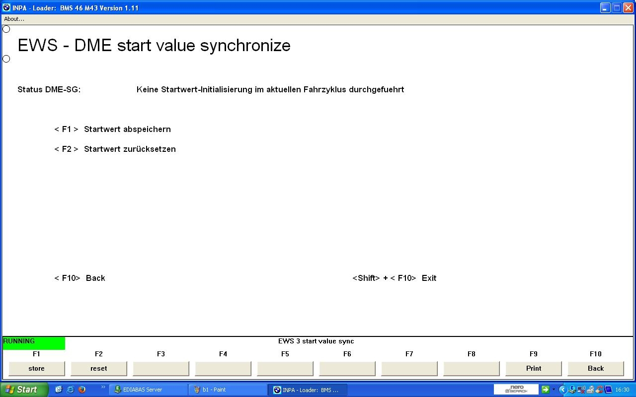

    Two weeks ago, the car refused to obey me - it turns, doesn't start. Connecting the computer and EWS synchronization error. I bought the diagnostic cable and installed INPA. After a few hours of hassle I was able to connect to DDE. The error still occurs, it cannot be deleted and when I press + F6 I have the following message:
    BMW E46 316i 1.9 (1999) - Can't Synchronize EWS, INPA Error & Reset Issues, Need Professional Help
    And when I press RESET, it pops up:
    I am asking for help from professionals and if someone from my area who finds help on the spot is found, I can even get to the place because I would not like to tow it.

    With this INPA, this synchro works very well for EWS 3. You can do it differently by resetting the synchro in EWS, but for this you need to read the processor from EWS and save it with properly crafted content, then it will synchronize itself.

    If you have something to read the contents of the processor, I see no problem. Alternatively, find someone in the area with the programprorm xprog-m. In the worst case, send ews to someone who does.

    I found a specialist in automotive electronics. He arrived with a specific program and after three minutes the car talked.
