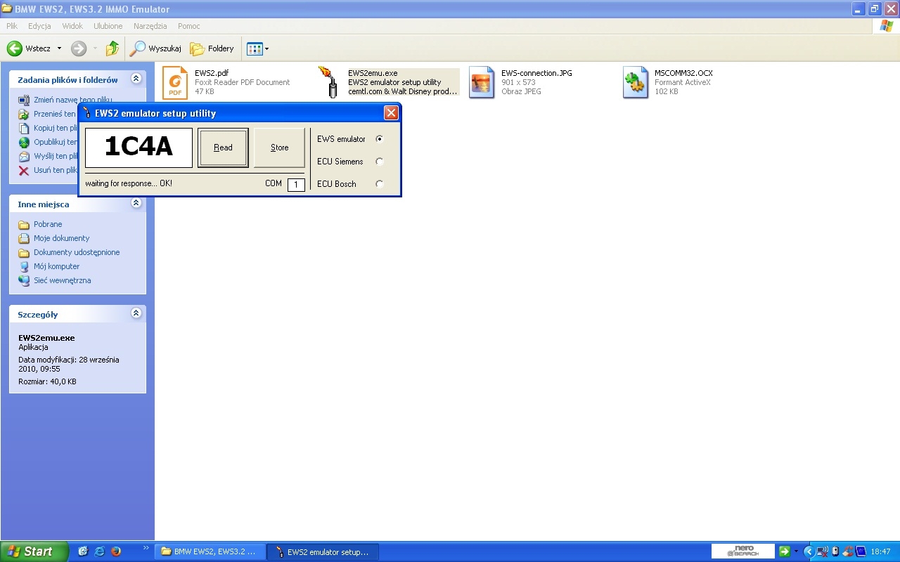

    I inserted the computer driver, read the ISN number, entered it into the emulator, removed the jumper, connected the emulator to the communication wire with the controller and ... KLOPS. The car does not start, the controller reports no communication with EWS. Has anyone had a similar problem? I connected the emulator output to pin 4 of the EWS cube because I found such schematics on the network.

    I connected the emu with a shorted jumper to the K line. Using the program in the attachment, I read the ISN from the controller (I don't know why he identified it as Siemens, even though Bosch is on the controller). I wrote the ISN in the emulator, checked if it read, everything is fine. I removed the jumper, connected the emu signal to pin 4 as you wrote (black and purple wire, continuity checked - goes to the ECU to pin 33 on the 40-pin plug).

    I connected to pin 11. I even programmed it again and then the same. I'll send you the screenshots when I'm home. And pin 6 is a signal from the machine, as you wrote, it appears at a standstill or at ease.
    Added after 2 [hours] 18 [minutes]:
    Screen shots:
    Reading the programmed ISN from the emulator and comparing it with the ECU:
    Programming BMW E46 316i 1999 Engine Controller and EWS Emulator for Engine Start
    And a bug in INPA:

    As for the EWS-DME communication line (pin 4) you have, I believe, well connected.
    Two more things come to mind:
    1. You write that you have checked the continuity of the communication line to the motor controller, but also check whether there are short circuits to ground or plus.
    2. Check if Ci reads the same ISN from the engine controller when you manually select the Bosch ECU and then the Siemens ECU. If it is possible (I don't know this emulator). It's a loose think, you can try.
    Perhaps the problem is with an incorrect ISN

    I checked the EWS - DME line in every way, the rest of the car worked with EWS before, but not as it should be. Below is my old topic, which was dragged on until recently, I decided to clean it up and gave it to the recommended electronics, who died with the driver and EWS, and later it turned out that he was an old thief.
    Link
    I checked ISN from a machine and manually, the same number always pops up.
    EWS was notoriously losing synchronization, last month I was able to synchronize it 3 times a day and then two days of calm and so on. The visitor promised me to get rid of him once and for all and he was not lying ...
    Added after 1 [hours] 37 [minutes]:
    Interestingly, the above error in Inpa concerns the complete lack of DME communication with EWS. I suspect that if it was a question of a bad ISN, I would have had a timing error as it often happened before.
