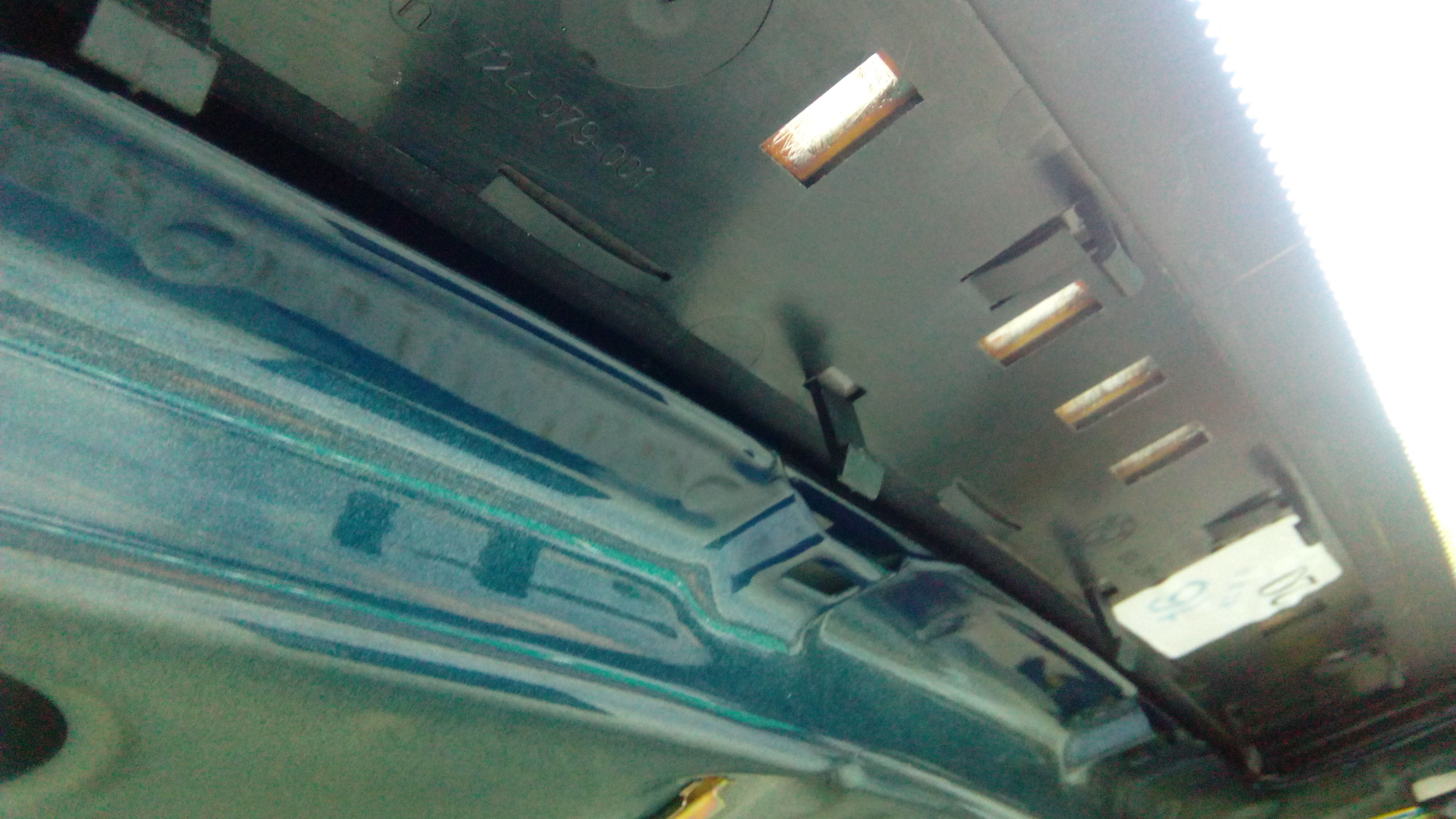

    Ubjawy:
    - no reaction to buttons from the remote control
    - no memory of driver's seat (everything works electrically)
    - after opening the door with a mechanical key, the alarm is triggered almost every time
    Diagnosis:
    - no errors in INPA
    - key control in the service (keys have battery power and send the appropriate frequency)

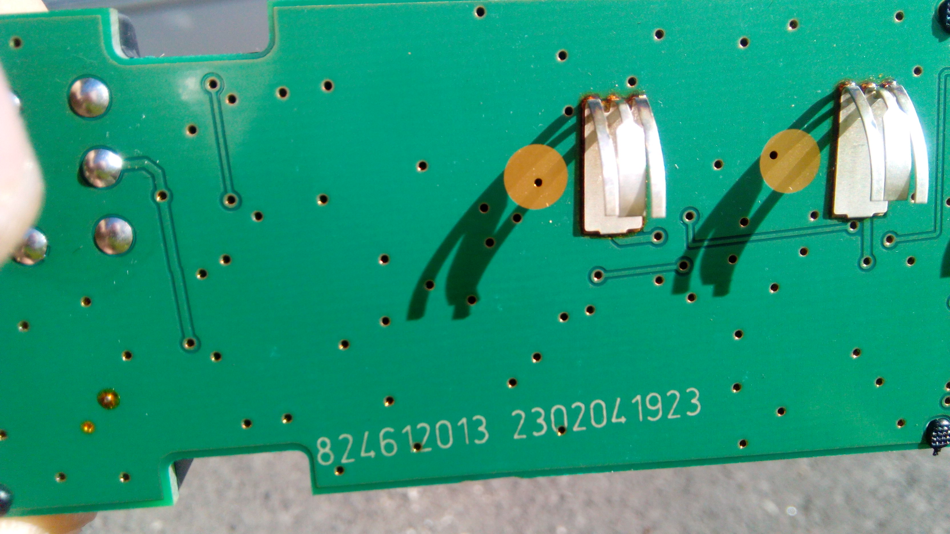

    - disassembly of the diversity module and contact cleaning
    http://www.realoem.com/bmw/pl/showparts?id=NA...-2004-E60-BMW-530i&diagId=65_1324#65209193832
    BMW E60 530i - E60 PRELIMINARY Diagnosis missing pilot work in the keys

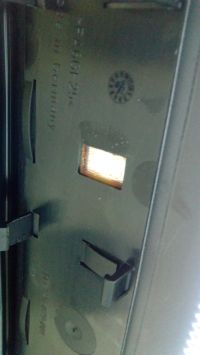

    - cleaning the contacts connecting the diversity module with the rear window and checking the condition of the roof fin from the inside
    BMW E60 530i - E60 PRELIMINARY Diagnosis missing pilot work in the keys BMW E60 530i - E60 PRELIMINARY Diagnosis missing pilot work in the keys BMW E60 530i - E60 PRELIMINARY Diagnosis missing pilot work in the keys

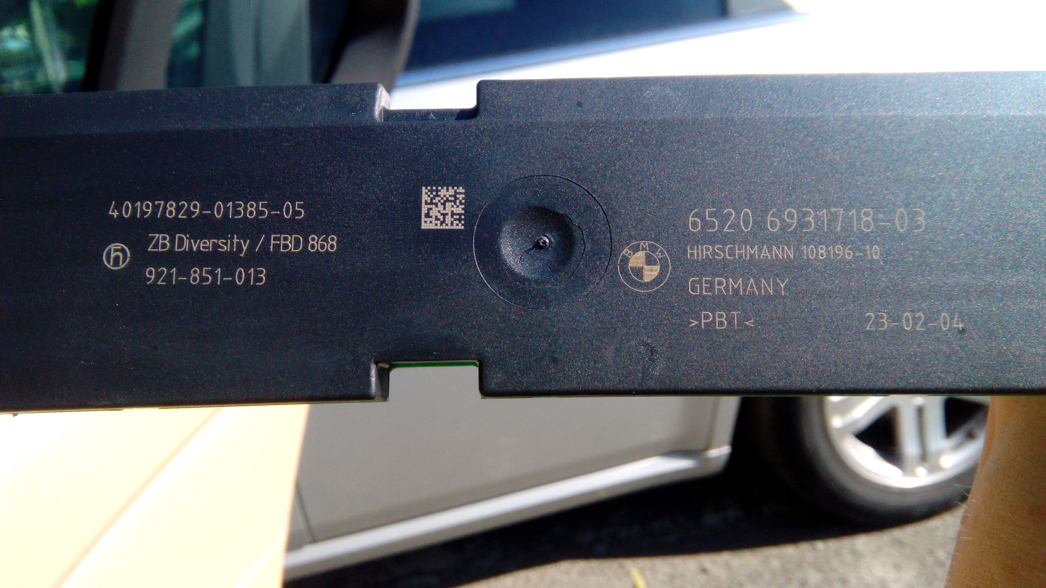

    - replacing the diversity module with another supposedly 100% efficient (unfortunately no changes)
    - status control and module replacement (interference filter)

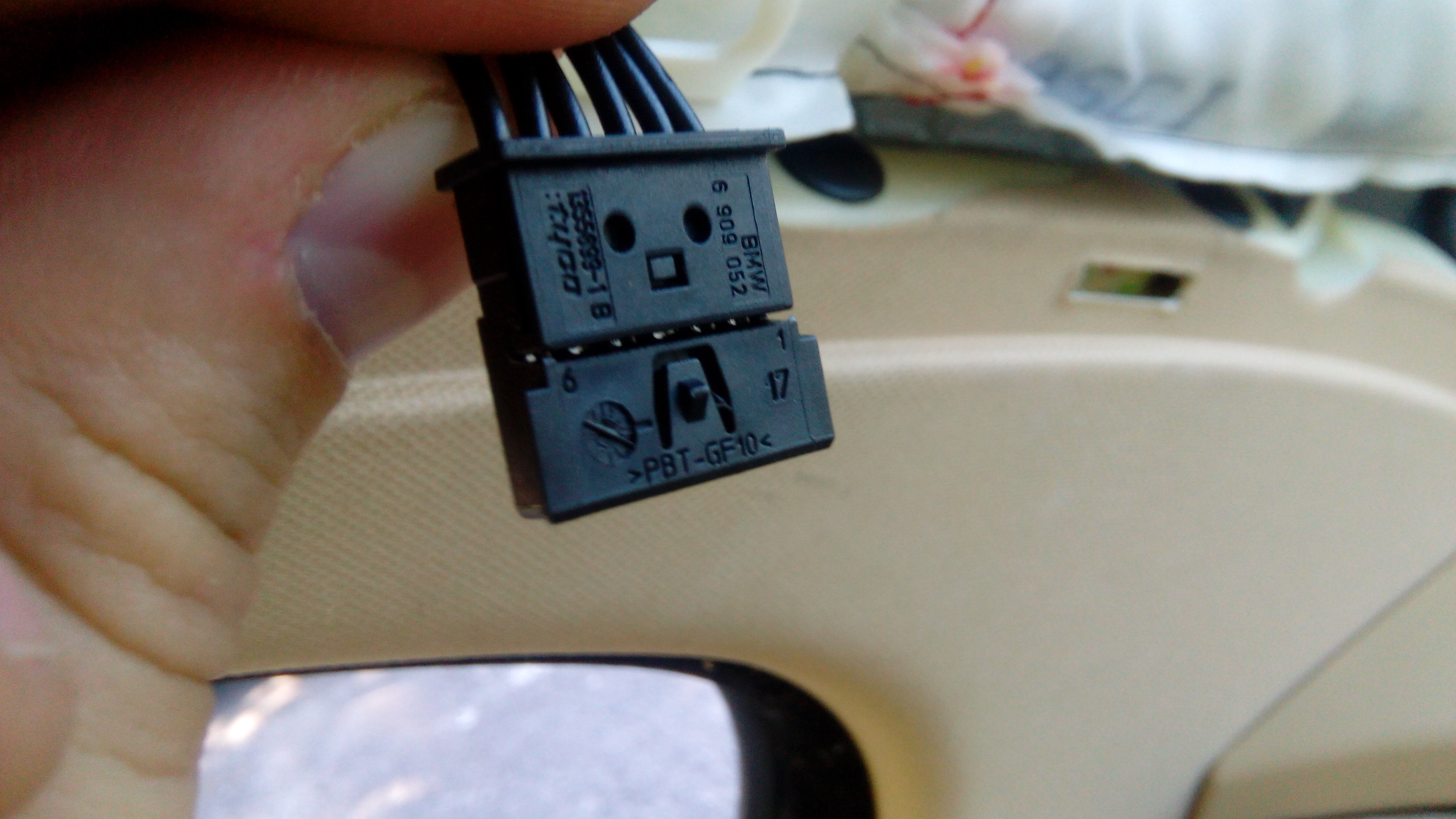

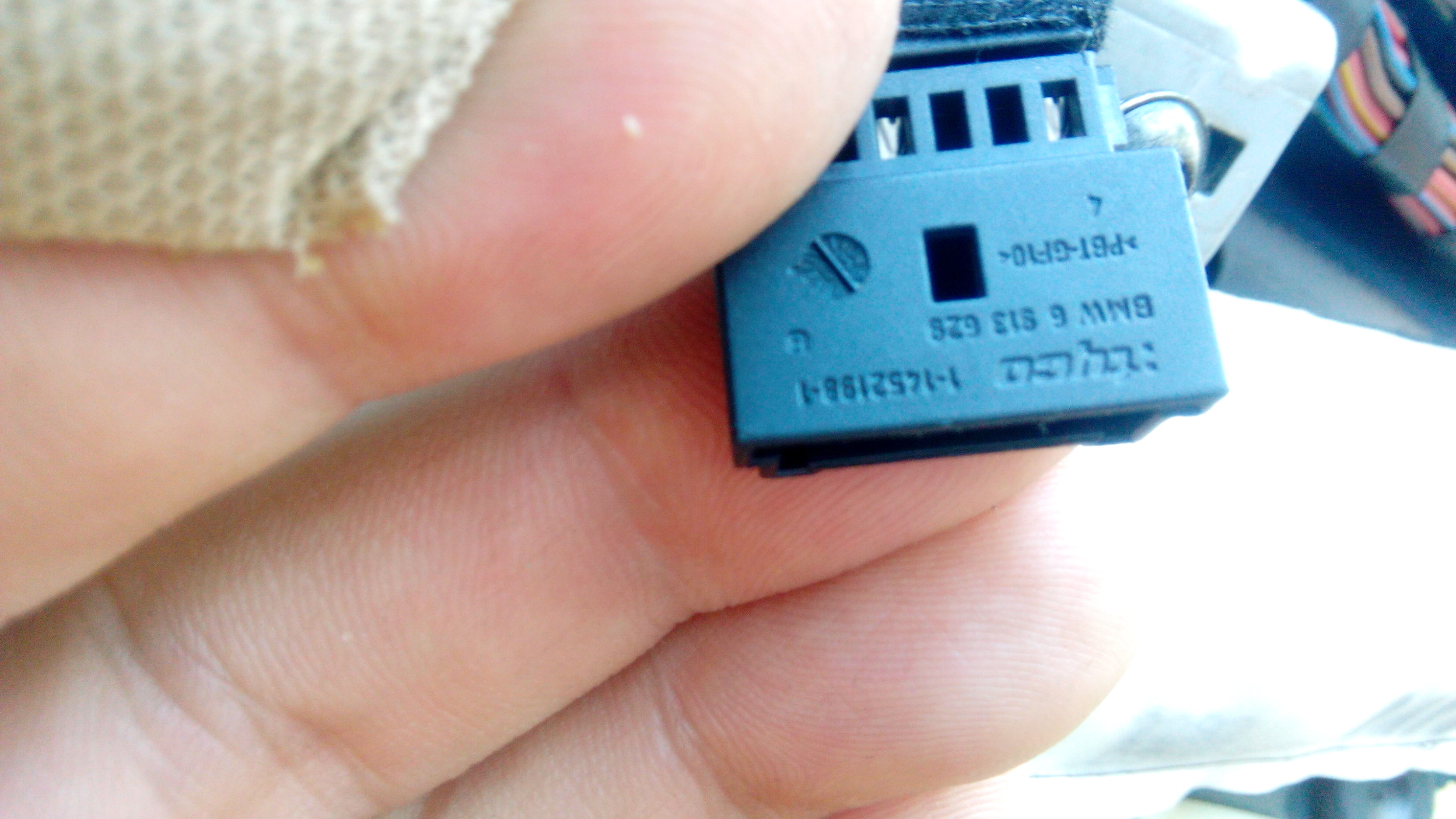

    questions:
    - why in WDS about diversity there is only one link and it is empty in total. Where to hook up in WDS to trace the diagram. There are no helpful markers on diversity poles
    BMW E60 530i - E60 PRELIMINARY Diagnosis missing pilot work in the keys BMW E60 530i - E60 PRELIMINARY Diagnosis missing pilot work in the keys BMW E60 530i - E60 PRELIMINARY Diagnosis missing pilot work in the keys BMW E60 530i - E60 PRELIMINARY Diagnosis missing pilot work in the keys BMW E60 530i - E60 PRELIMINARY Diagnosis missing pilot work in the keys BMW E60 530i - E60 PRELIMINARY Diagnosis missing pilot work in the keys
    - what to check next

    I don't remember exactly, but there is only a constant + - power supply, a cable going to CAS and that's all for the remote control to work
  • #3 16631120
    DZWILU88
    Posts: 313
    Rate: 94
    The remote controls are working, something in the car is not working, some receiver, amplifier, antenna or whatever.
  • #4 16631405
    DoctorCar
    Level 19  
    Posts: 195
    Help: 37
    Rate: 123
    sorry I said wrong, in CAS you will see frames fly through INPE. I used to have the same E60 as I did.
    Antenna module 6 pin permanent PLUS and 3 pin to CAS on 33pin WS / BL, it probably has mass from the body
