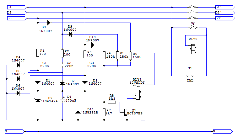

    -How does the phase loss sensor work, I heard that it can be done by itself on two relays, could someone send me a diagram of such a phase loss sensor made on 2 relays?

    - The protection against phase loss is made on the basis of the adder and the relay control system, when the voltage at the output of the adder is too low disconnects the relay.
    - It can be done, but two relays are not recommended because they must be 400V and one of them connects between L1 and L2 and the other between L2 and L3 and the contacts connect in series. But I do not recommend this solution, use CKF.

    And I still don't quite understand the operation of the '' phase failure sensor '' could you send a schematic?

    - The phase loss sensor has the additional advantage that you will not turn on the motor even for a moment in the absence of any phase. See diagrams. The difference between a thermal and motor breaker, why a thermal, why switch of The difference between a thermal and motor breaker, why a thermal, why switch of

    It works a little differently. When everything is ok, the voltage from the adder is 0V and when there is asymtria there is some potential in relation to the virtual zero or from the work cable N.
