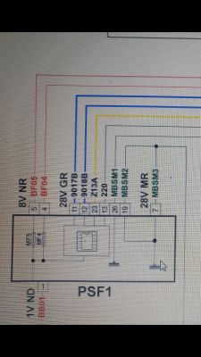

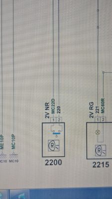

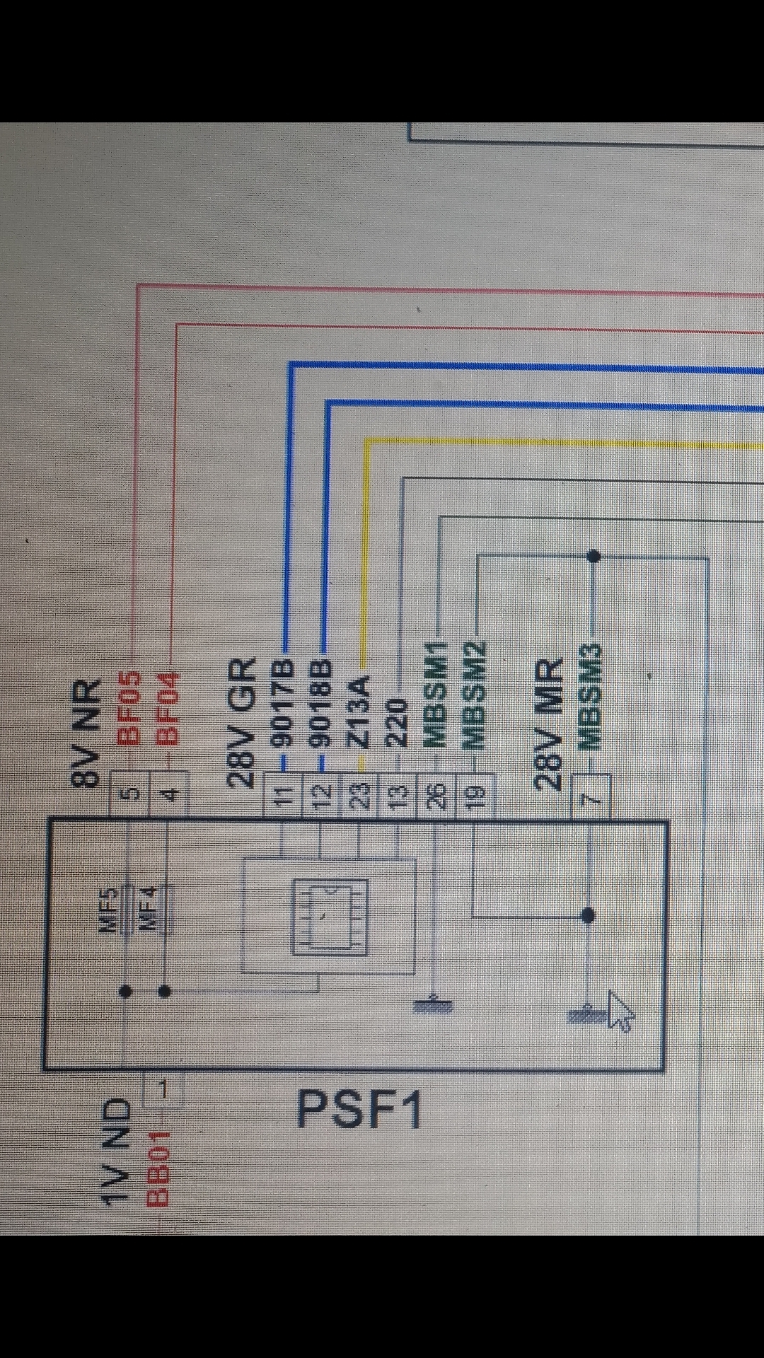

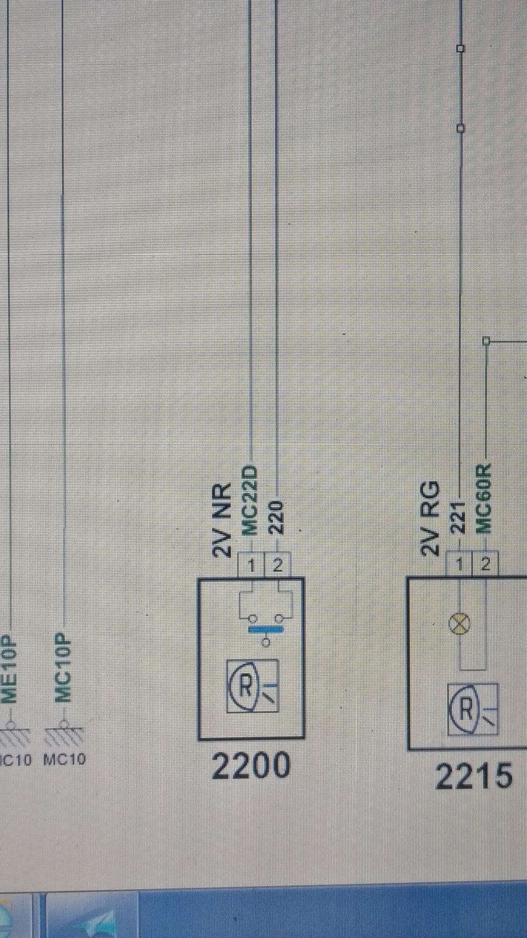

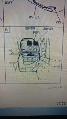

    Thanks to everyone for any comments. As for electrical matters, I only have to connect the reverse gear sensor, unfortunately I can not find a diagram or instructions where to plug it in, I guess that this signal goes to the BSM only the question for which pin. If someone has a diagram, I would ask for information or sharing it. I have BSM L-11.

    Well, unfortunately, through the forums it was not possible to get information whether at least a piece of the diagram, fortunately, a colleague from the company arranged for me access to the citroen service website, where I printed the necessary diagrams and I already know where and what to connect, unfortunately even Citroen does not boast about the types of be4 boxes there there are only so many that they were, but more precisely what not. Well, I will have to look for something that will be pulled directly from this engine. To everyone who wanted to help in a queue, thank you when I get a model of the box that fits, I will write here if someone ever wanted to do something similar ;)

    Well, the spacer is finished, the reverse light connected according to the diagram works as it should. Adds a schema for posterity as if someone had the same problem so as not to search ;)
