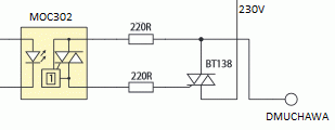

    For now, my design is very simple
    - Controlling WPA 120 Blower Fan Speed: Phase, Group, or Inverter? Microcontroller Options
    Is it worth adding a capacitor in series after the triac at the output as in the furnace controller (will it help with blinking squeaks)? Where should I put the choke - on the microcontroller power supply or somewhere near the above elements?
  • #8 16703257
    kpodstawa
    Posts: 1806
    Help: 234
    Rate: 244
    In the search engine, under the key "triac triggering", various schemes appeared. Note those with RC filters (extinguishers) in parallel with the triac and chokes connected in series with the load. I think this is the minimum necessary to start designing and testing. In addition, the guides write that for stability, thyristors-triacs should be triggered by current pulses with good steepness of the front slope, appropriate amplitude and duration. Will such a simple optotriac key provide this? In industrial or semi-industrial systems, however, I saw separate generators, diacs or minimally switching diodes. Fact - a long time ago - thyristor bridges were common). KP

    mitny
    Posts: 153
    Rate: 8
    I read a bit but I'm still in the field.
    I tried to give the RC element - a 39Whm 0.6W resistor plus a 1uF 305V capacitor in series and the whole parallel to the triac (between 230V and the triac output on the blower) and with this connection the resistor starts burning. Is the culprit too large a capacitor or a too weak resistor?
    By the way, when I accidentally connected a capacitor without a resistor, the triac was damaged - here I don't understand a bit why the triac was damaged.
    I have found such a scheme
    where is a similar RC circuit but the capacitor is much weaker (10nF) but I don't know what power the resistor is (whether 0.5W or stronger) and I see that the similar circuit is repeated a second time with a larger resistor and a larger capacitor although I don't know why items are 2 times.
  • #10 16714305
    kpodstawa
    Posts: 1806
    Help: 234
    Rate: 244
    In several publications that I reviewed, the parameters of the triac extinguisher for 230VAC were mostly similar. 10nF 630V capacitor. Resistor 39 Ohm and at least 2W. But I found this remark: "For highly inductive loads (power factor

  • #12 16722535
    mitny
    Posts: 153
    Rate: 8
    I tried with a 10nF 630V with a 39 Ohm 5W resistor and everything works OK - in the sense nothing burns. However, unfortunately this buzzing at low speed did not eliminate it.
    Regarding the autotransformer, the Defro furnace controller almost certainly does without it - I glanced at the controller a bit and as I wrote there is only electronics, besides the speed control is completely smooth from full power to very low speed and at almost low speed the fan can hardly be heard despite this, the engine does not hum.
    Added after 1 [hours] 47 [minutes]:
    And one more question: does such humming at low speed have any negative effect on the engine?
  • #13 16723624
    kpodstawa
    Posts: 1806
    Help: 234
    Rate: 244
    So, we would have a gasik implemented. The fire extinguishing system is the filter and protection of the thyristor circuit. However, a separate filtering system is needed for the receiver. Buzzing at low speed results from the shape of the current in the receiver. The "cut off" piece of the voltage sine wave, for angles below Pi / 2, more and more resembles a triangle shape. Ripples of the first harmonics are not negligible, and the currents in circuits with inductances already quite differ from smoothness.
    In my opinion, a good quality motor should handle this shape of the supply voltage and hence the currents in the windings. In addition, it is an AC voltage motor, i.e. even such triangles should have an average value close to zero.
    However, the use of LC (more precisely LCL) filters on the receiver may make sense, despite the fact that the motor winding with a magnetic tape can be considered a filter choke. The parallel capacity in the filter discharges some of the harmonic voltages back to the source, thus reaching the receiver with less energy.
    A few months ago, I read a post about Triacs on Elektroda, and something I didn't know about it. Well, the real characteristics of triacs are not perfectly symmetrical, which means that a DC component can be created in such a switched circuit. This is not good for the power supply or receiver because of the permanent magnetization of the core and entry into the more non-linear part of the characteristic. This can generate additional current distortions.
    Therefore, good quality triacs or thyristor systems must be used, because thyristors can be paired well. I could have twisted something, so possibly look for this thread.
