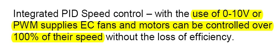

    emarcus wrote:
    You use one method (0 to 10 V analog signal) or PWM (10 V) instead of both.
    No matter what method you use, you need to give 0..10V:
    Arduino EC Motor Control: BLDC with 0-10V PWM, Transistor BD139 & Regulator R-1/010 Integration
    Whether in the form of pulses or direct voltage.
    The R-1/010 regulator is a potentiometer for me (130 PLN).
