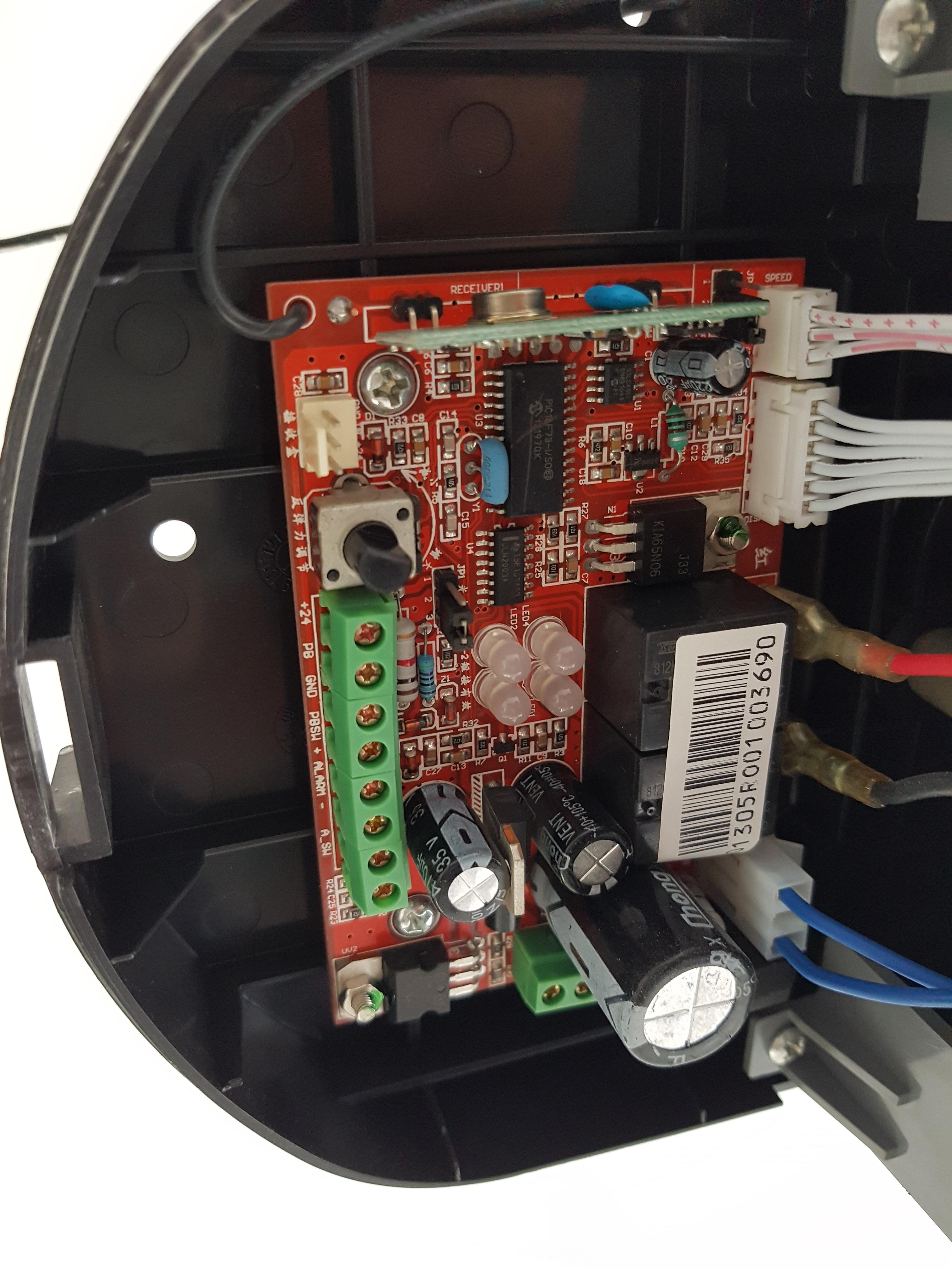

    I have a Gator gate with a Gatolift sm600 drive, unfortunately I can not look for any manual schematics anywhere
    I would like to connect the switch control and I have no idea how to do it below I put a photo of the board there are photo inputs so it is most likely possible to connect such a button
    I am asking for advice, diagram, drawing, how can such a connection be made, I also want to connect the Fibaro Fibaro Relay Switch control
    It seems to me that the GND / PBSW terminals should be used for the button

    Personally, having my own such automatic machine, I would try to give the ground from the GND terminal to how you write the PBSW terminal or the PB terminal, I would look for a trial and error method but this is just my suggestion.

    If you have the option of connecting such a button, it should be described in the manual.
    Added after 38 [minutes]:
    Here you have another gate manual, but the description of the terminals is the same.

    I have this drive and the manual from jarek225 is good. A NO monostable button can be connected to the PBSW, and the PB is used to connect photocells. I connected my neighbor's bell button under PBSW because he lost the remote controls. It works exactly like the remote control, i.e. OPEN-STOP-CLOSE-STOP. This 3-pin connector (GND, IN, +24) is for connecting a third-party receiver. Thanks to this, you can buy a radio, e.g. for FAAC or NICE, and control the garage door with the same remote control as the entrance gate.

    The board looks identical, the panel also - maybe the rest will match (attachment, at the end of the manual there is a drive).
