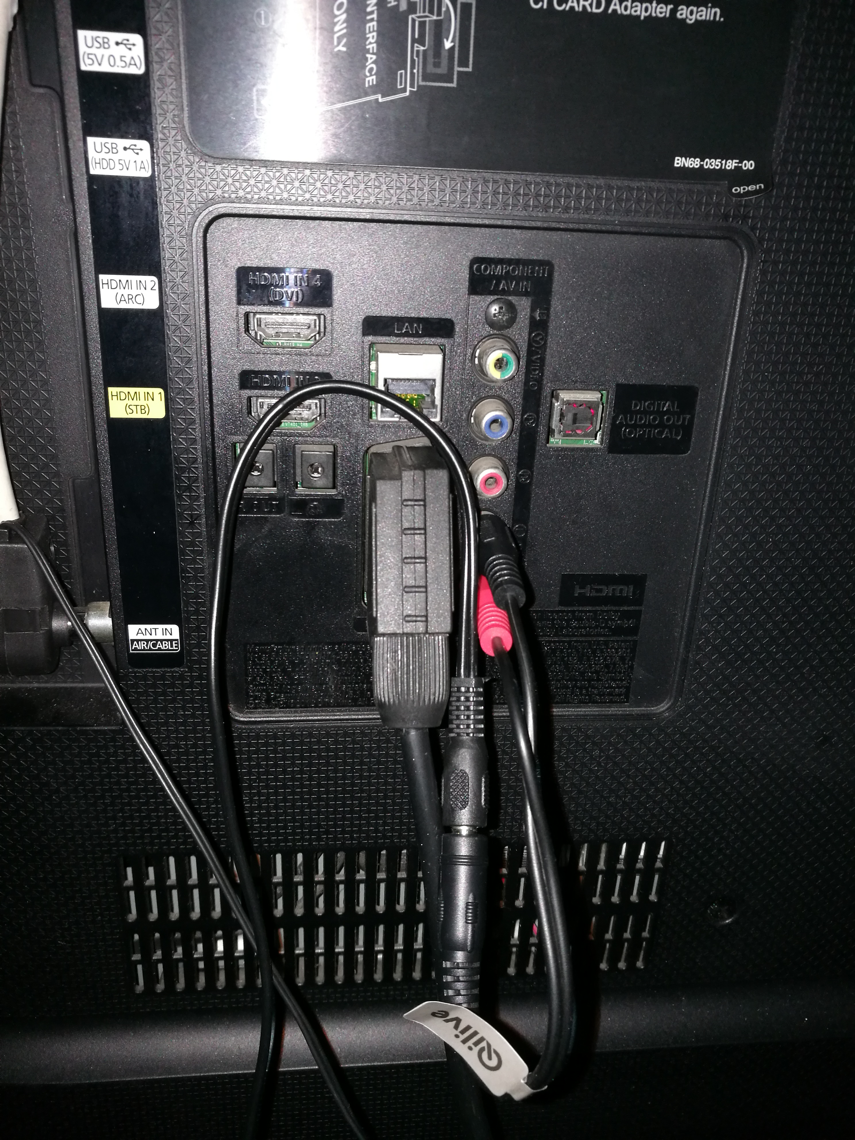

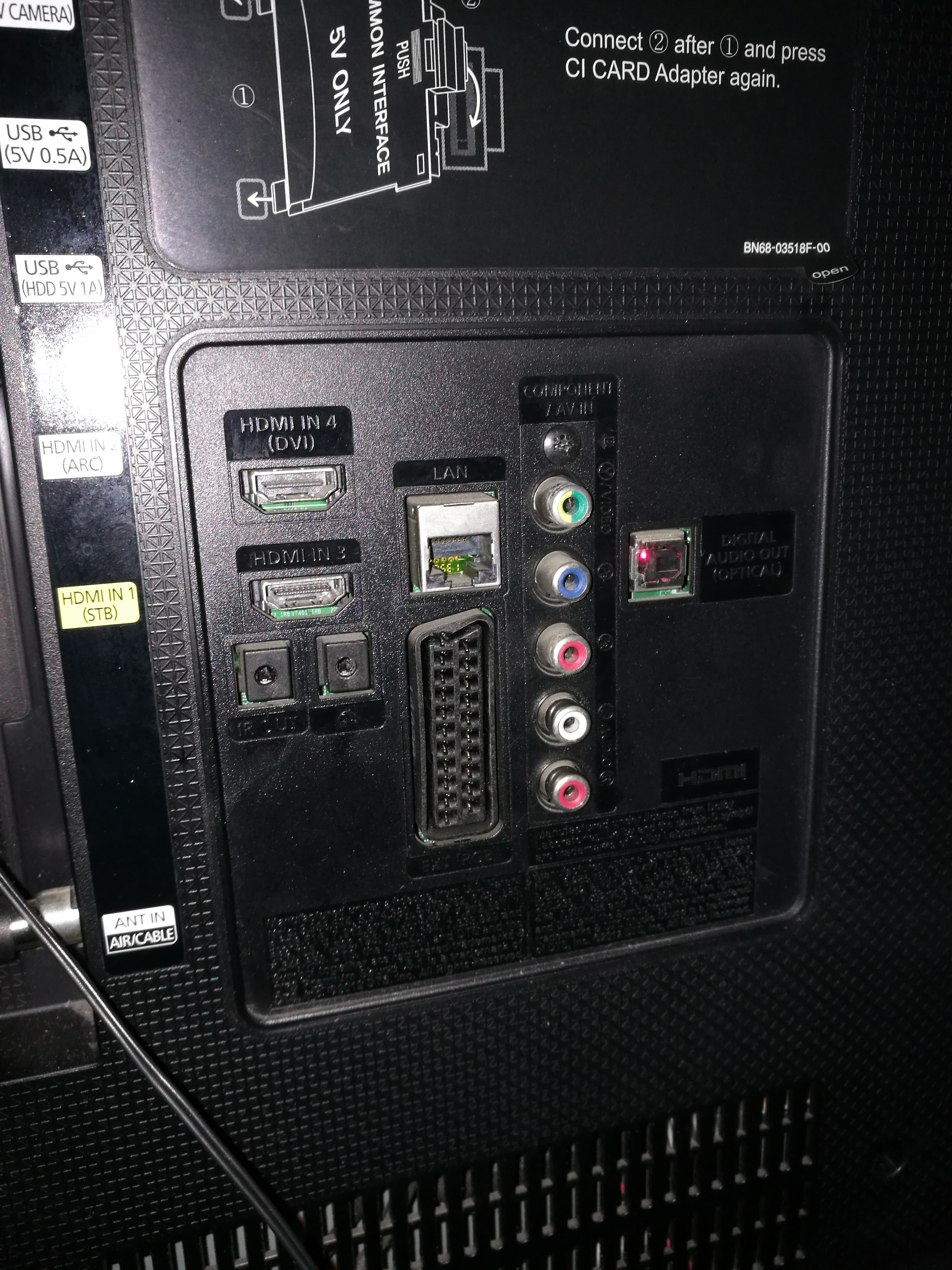

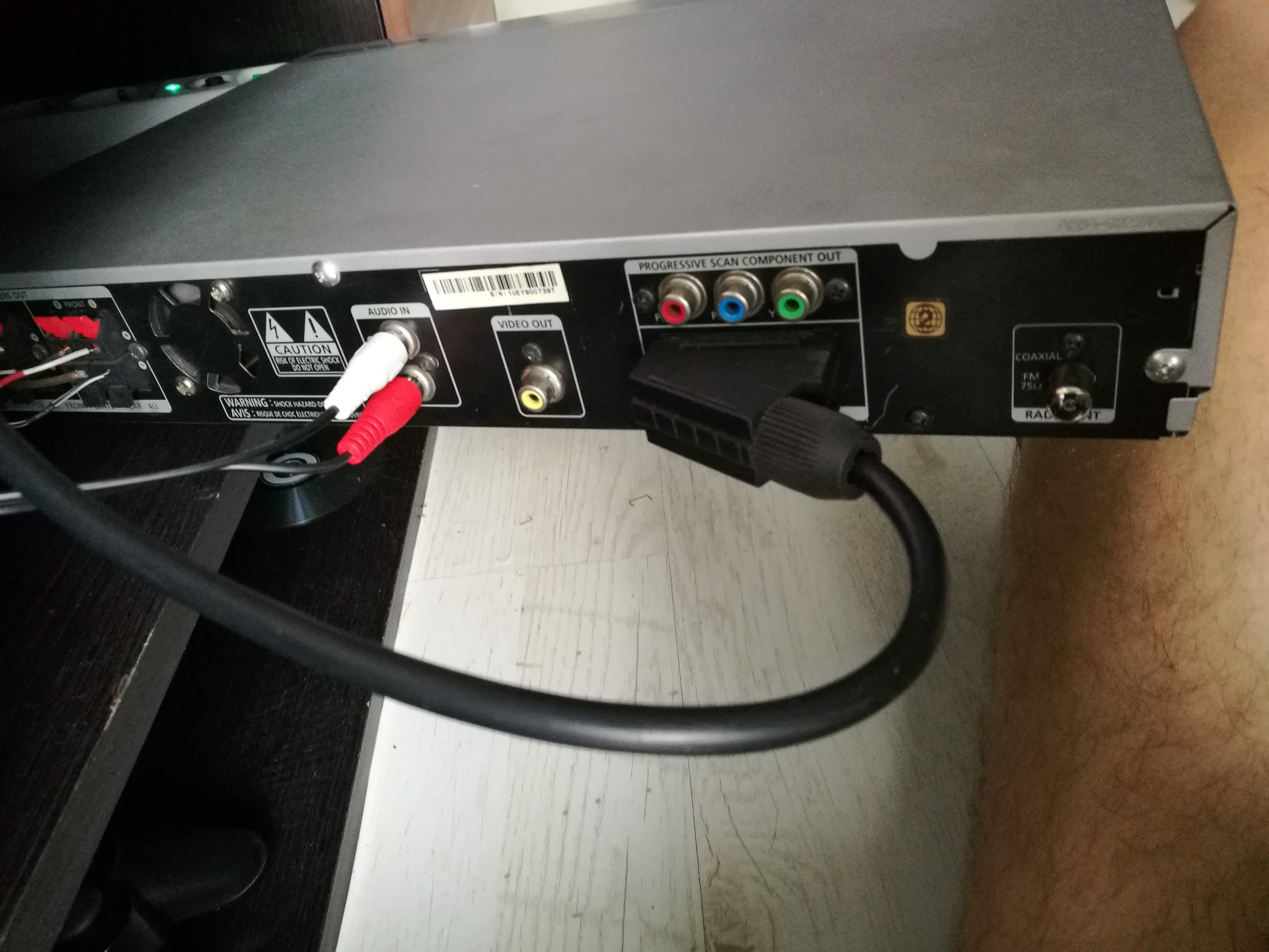

    I need help in the attachments photos, what I have inputs and how I have DVDs connected to the TV, unfortunately the speakers do not work, just buzzing like Jack (e.g. computer) it works, but unfortunately I have a broken headphone input on the TV. Help how to connect what you propose? Thank you for any help for me because I have no ideas, maybe I need some adapter or something else, maybe some TV settings?

    Hello . The connected Euro connector should have both image and sound, set the output to EURO in the DVD menu and the input to Euro on the television set. And everything should play, if there will be a humming change the Euro connector to a new one.

    Welcome. You describe your problem a little incomprehensibly, but I will try to respond to it. You write that you do not have DVD audio through TV. If you mean sound from a DVD for TV, for example, it should be connected to the EURO - EURO cable with a DVD and TV and after choosing the right TV input, it should be flickering. However, something you mention about a damaged headphone jack on the TV, which may be relevant, because to have sound in the speakers, it can be turned off via the headphone jack (inserting the plug from the headphones into the TV automatically turns off the speakers on the TV). If you meant to send the sound to a DVD, this is probably not possible because the DVD has no speakers. By the way, provide the exact names and types of both devices, it will be possible to better help. greetings

    How do they play when you connect the audio input on TV to the audio input in KD? You must learn to distinguish between entry and exit. You don't have audio output on China on TV, so it only stays for EURO as a colleague previously noted.

    @ leszekpo59 In the picture you can see that this DVD model is with a radio and has speaker outputs.

    And that is why it may be that the audio from it does not go out for the euro.

    Now to McArthur. I suggest you check first which audio input on the DVD is definitely active. Because it can be EURO, as well as AUDIO IN. For this purpose, using appropriate cables connected to these inputs, try to extract audio signal from MP3, for example. After finding the right input, i.e. active, from TV you can get the sound from the optical socket, through the converter to analog and connect to the active input in the DVD. Good luck
