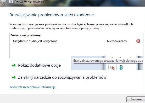

    Hello, yesterday I connected my computer to TV via HDMI and this started my problem with sound.
    The point is that when I plug in my headphones, I keep writing "no audio device installed".
    When I choose to automatically detect problems I get something like this:
    No Audio Device Installed, No Sound after HDMI Connect to TV, Headphones & Stereo Mix Issue
    Interestingly, when I enter the manager, it detects "speakers" for me, which is probably strange, because I only have headphones connected (no sound opening works.)

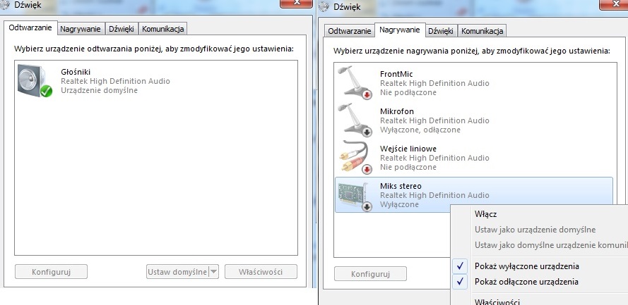

    Another issue was that when I entered the sound settings, the "stereo mix" turned off, even though it was always on. I can't apply any changes, e.g. trying to turn on the stereo nothing happens, same as e.g. trying to turn off the speakers.

    I don't know what's going on, very strange thing, I've never had this kind of problem.
    Can anyone help me? Best regards.

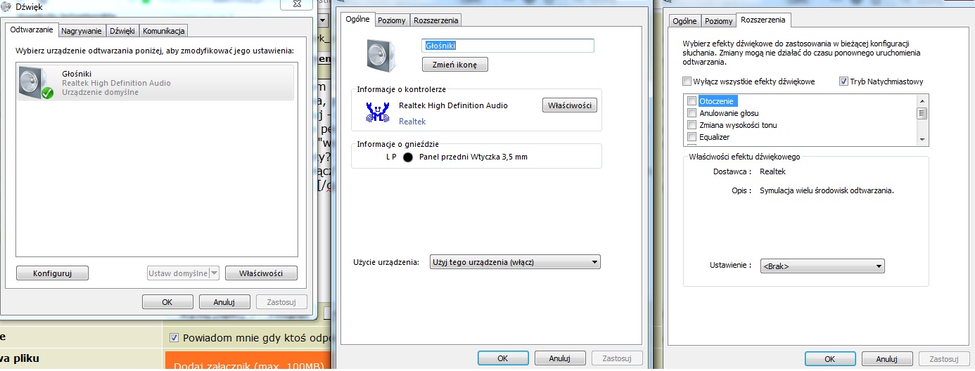

    Right on the speaker and the volume mixer show the screen
    Playback devices, right on speakers and screen properties
    Right on the speakers and test - do you hear something?
    You have something mixed up and it's probably easy to unscrew it, but at a distance it's a massacre to look in the system where something "turned off"

    So yes, screen z from the property:
    No Audio Device Installed, No Sound after HDMI Connect to TV, Headphones & Stereo Mix Issuesakam.jpg (157.82 kB)You must be logged in to download this attachment.
    When you click test, nothing happens, the more you hear nothing.
    There is something mixed up, but I would not say that it is easy to unscrew:>
    It's all confusing, for example, this whole "sound" panel does not respond to the main commands such as turn off / on, etc.
    Now I am connected to the monitor via a DVI adapter (as always.)
    But when I was on TV, I tried to turn off Nvidia from LG, but nothing happened. Just as I would like to turn off the realtek speakers now, nothing goes either, only when I disconnect the headphones, I write that it is disconnected.
    So yes, the matter was settled, I went to the website, they helped me on the spot, as I wrote, it was about the lack of permissions.
    Maybe it will be useful for posterity, so I will write how I dealt with this trash:
    [WINDOWS + R] regedit
    HkeyLocalMachine> Software> Microsoft> Windows> CurrentVersion> MMDevices> Audio> Renderer
    And right on the permissions and you had to tick and everything, problem solved.
