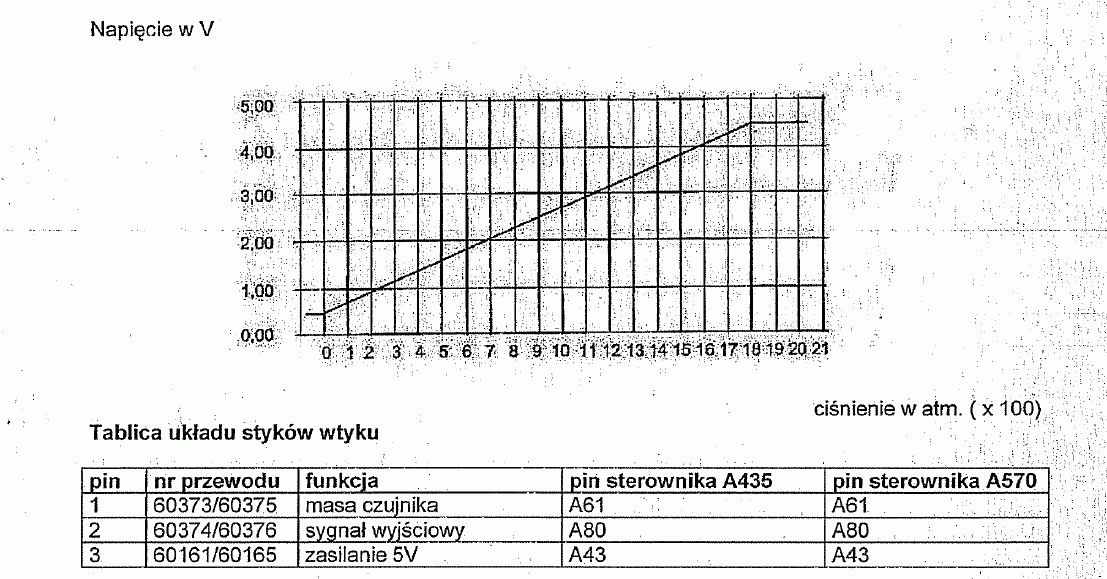

    I would like someone to confirm that from oily inside the driver it can be damaged?
    Tractor p. As in topic
    The parameters show a constant pressure of 750bar when the ignition is on, after firing it starts to oscillate +/- 20 bar, under a sudden load it jumps up to 850bar. A new sensor. The beam tested twice. .
    I spilled ecu, so I washed it now instead of 1079 I have 3099.
    At 90% I am convinced that it is the fault of the ECU but maybe I missed something so please give a hint before buying a second ecu.

    Hi, I see that colleague "Hektar Zahler" answers all puzzling topics that appear on the forum, scoring points and the answers do not bring anything helpful in the topics. "Pitool" buddy, I think the best solution to your problem will be measuring the voltage on the ECU plug. Simply make a device cable with a thin needle and insert it through the connector's rubber on the sensor input pin. Measure the 5V sensor supply voltage and the output signal which should be between (no pressure) 0.5V - 4.5V (full pressure). Give the measurements in the post. "Hektar Zahler" speaking of a defect may mean ECU plug sleeves which often lose their elasticity and there is no contact with the pin on the UCU.
    If the correct values are found on the sensor and ecu measurements, measure the ECU input values (ignition off) with the sensor disconnected using an ohmmeter between ground and power supply and between ground and signal output. Depending on the value, this measurement will help you check whether the wires (sensor connector) have a connection with the ECU.
    Check the large plug connector for oil ingress

    Returning to the merits: you missed nothing. ECU can play such pranks. The only sensible hint and at the same time an attempt to solve this problem is to replace the ECU with another one. Then everything will be explained at the moment.

    I did a bdm clone of the controller on the table and I played with curiosity its curiosity.
    The effect is that apart from a whole bunch of other errors, error 03781-01 and constant 750bar have not changed.
    Second ECU on the road, with effects even though

    Dude, it's not just you who come here, because there are a lot of people with the vision of throwing a cabbage cart away. I have already told you my cars, and now if you want to listen to me, you are doing it right. Unclip the cube and measure if it is actually 0V on the middle contact, possibly (as the previous speaker said) or is 0.5V plugged in. And you poke the clocks in the clocks if there is an adequate error, i.e. with the index 02. If not, you look at the chart below and you poke the clocks in the clocks or there is 03781-01, which would now mean a damaged ECU input, which you can try to fix alone - if you feel up to it. In this situation, you need to give these 0.5V on the sensor cube and again you poke the clocks in the clocks what is the error, or killed. If you do not die, you confirm the internal damage of the cassette by specifying 0V in this place, you stuck the clocks in the clocks and you see no error with the index 02, which means now that the computer has been stupid and there is damage to the bank inside the controller, for which you need a drip of oil in your head. Then you take the computer to the electronics and report what was measured, and he does his job.
    Added after 8 [minutes]:
    Sensor curve for meter measurement.
