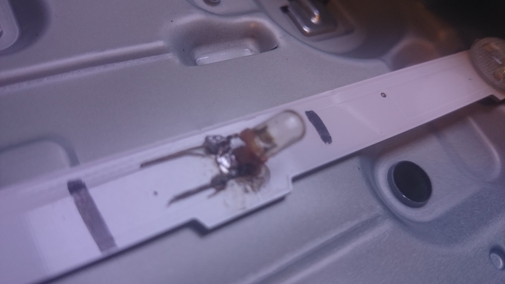

    Hello, I came to repair the LG42LA620s TV with a backlight problem, namely each one diode is visible on the matrix after stripping the TV, it turned out that some master had previously improved the backlight, there were no supports that hold the filters up so I started to replace the LED strips.
    After replacement, the effect is the same, when I replaced the 6916L I do not know whether this further marking is also important, but from what I read the mounted strips should work properly without a problem.
    The only thing in place of the L1 and R1 slats I put L2 and R2 because I did not have the right ones, but could it be a problem that you can really see the whole slats on the screen? mainly on a light background.
    All filters are in place and are not exchanged.
    I have never seen such a thing, I don't have much experience but I have already repaired some of these highlights and I see this effect for the first time.
    I am asking for help, what could be the reason for such a thing?

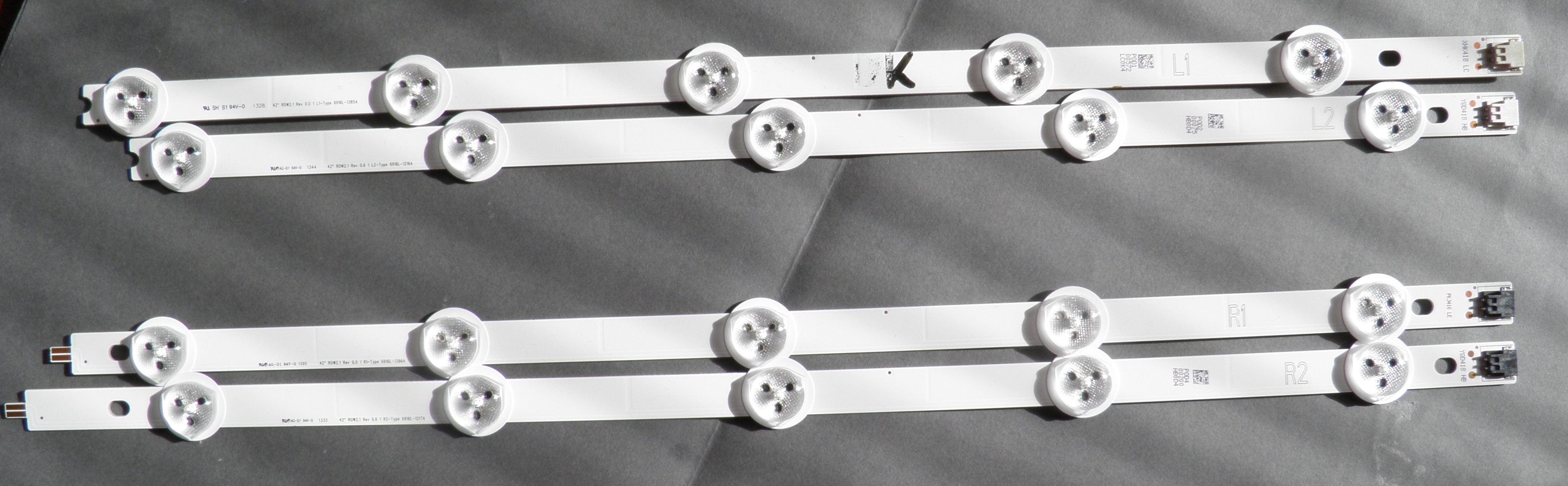

    Well, not another magician ;) because what I noticed inside was a masterpiece I am surprised that someone like that repairs tv but not important.
    I put the LED on
    42 '' ROW2.1 REV 0.0 1 L1-TYPE 6916L-1385A
    42 '' ROW2.1 REV 0.6 1 L1-TYPE 6916L-1214A
    So such?
    LG 42LA620s - LED Strips Visible Through Matrix Despite Replacement, 6916L, L1/R1 & L2/R2 Issue
    To put it mildly, guerillas, but it has absolutely no effect on the effect, only a different spacing.
