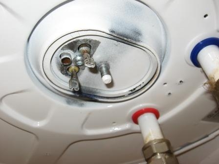

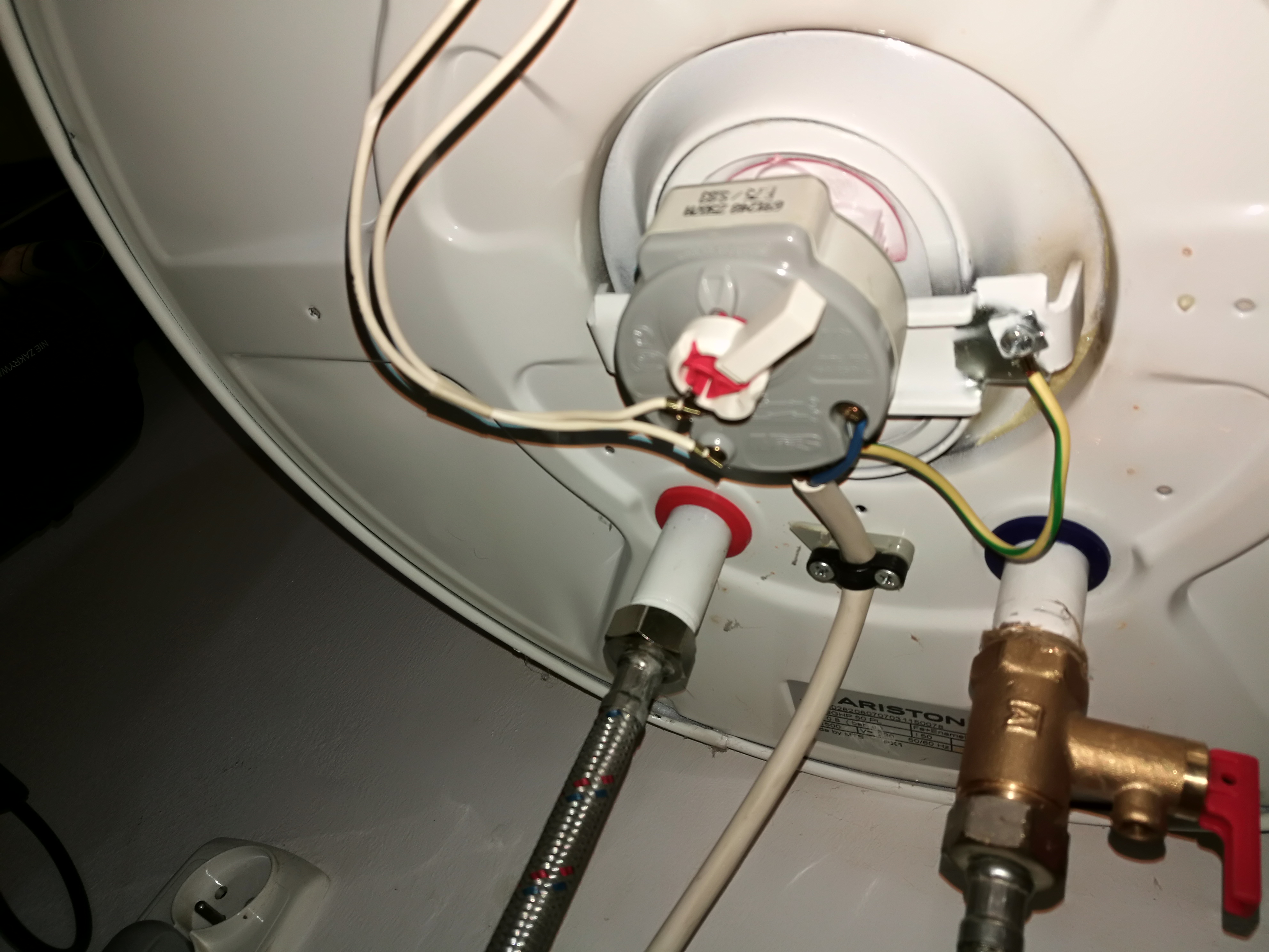

    Hello. I am a complete layman when it comes to repairs. The boiler does not heat well. Previously, it was ok, by the time I replaced the safety valve (it was dripping). Then it was ok for a few days and suddenly it started to heat poorly. I want to clean it, but I don't know how to remove the part with the thermostat and then the heater. I don't want to break something.
    • Ariston SGHP 50 PL Boiler: Cleaning Stone, Removing Thermostat & Heater, Safety Valve Issue IMG_20170928_115427.jpg (2.28 MB) You must be logged in to download this attachment.
    • Ariston SGHP 50 PL Boiler: Cleaning Stone, Removing Thermostat & Heater, Safety Valve Issue IMG_20170928_115417.jpg (2.27 MB) You must be logged in to download this attachment.

    Hello. Unscrew the buddy screws from the power cables, then remove the top part of the thermostat and then remove the rest that is put on the heater wires, then unscrew the white handle that presses the heater against leakage because it is on the rubber seal. Ariston SGHP 50 PL Boiler: Cleaning Stone, Removing Thermostat & Heater, Safety Valve Issue Ariston SGHP 50 PL Boiler: Cleaning Stone, Removing Thermostat & Heater, Safety Valve Issue
