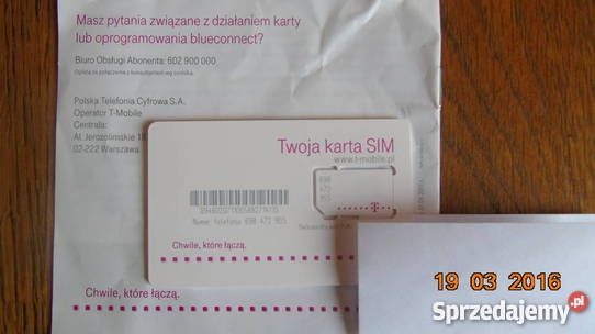

    Thanks for the links, drivers found, device installed but I have two problems
    The scanner works only when the Alladin configuration program is on, when I exit the program the scanner stops working, the button is no longer active
    An additional problem is the lack of reading barcodes from sim cards, and mainly for this purpose I need to use it, normal codes from bottles and cigarettes are read without any problems
    The code on the cards is wider so it probably has different parameters
    Preview photo of a code that does not read ...

    The scanner probably turns on only when the program requires it, so it stays in sleep mode.
    What program are you using to operate it?

    Okay, I changed something and the reader works normally
    But there is a problem with reading codes that need to be read from sim cards and envelopes

    You don't have the option to calibrate your reader somewhere?
    You tried to understand how to zoom the reader in / out of the scanned code.

    I did not find in settings
    Ie. There are other types of codes to choose from, but I don't know what type of code it is and what to program

    The problem solved itself, it turned out that the envelopes had a different barcode than the one I needed (phone number)
    The scanner works fine with other barcodes
