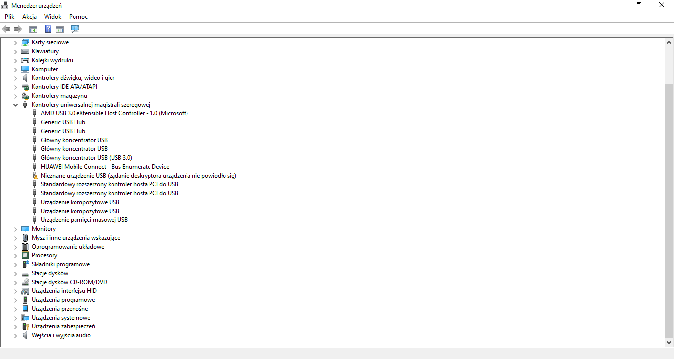

    In the laptop, there is only one driver missing in the device manager, but is it a missing driver for the disk or graphics card or something else?
    Where can I download this driver?
    The laptop was purchased without any driver discs.
    All I have is the Internet and a Google search engine to download the missing driver.
    USBVID_0000&PID_00026&174294C4&0&2
    Port_#0002.Hub_#0005

    It`s some faulty USB device, maybe the built-in camera or card reader or bluetooth - or whatever.
    The device ID is invalid - the DEVICE_DESCRIPTOR_FAILURE status indicates a problem with the device, so you will not find drivers for this ID.

    This is not the correct identifier, from what you can see it is some device connected via USB, do you have a pad or something else connected? If so, unplug it and see if it goes away.

    Do laptopa był podłączony przez USB pendrive i klawiatura i mysz i je wszystkie odłączyłem i odinstalowałem te nierozpoznane urządzenie ale po restarcie Windowsa znowu się pojawia nierozpoznane urządzenie.

    @jajcznica1001 Remove all devices from the USB ports, then move the mouse cursor (click PM) to the device with the exclamation mark in the Device Manager and from the window select the "Uninstall" option, when it removes the device, click the mouse (any device) again (in this window to select the options "Scan for hardware changes."

    The camera, Bluetooth, Wi-Fi, all USB outputs and card readers are working, I checked them thoroughly. I turned off EFI or UEFI in the BIOS, no matter what it's called, all devices and the problem with the Device Manager disappeared, but then I turned them on one by one so that the voice came back and after each turn on the next device I reached the Windows desktop and checked the Device Manager and it turned out that it was it's the fault of the switched on FingerprintDevice so what is this device and what is it for and I disabled it in the BIOS?

    It is a fingerprint scanner. It can be replaced easily (you can probably get a used scanner module or the entire palmrest with a scanner for little money), but most often it is not necessary equipment at home.
