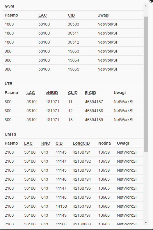

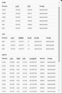

    According to BTS Search, you have the full range on T-mobile. I recommend a broadband antenna, e.g. DUAL X-CROSS 3G 4G LTE 2x19dBi ANTENNA ZTE HUAWEI. It also depends on the terrain but I have one at a distance of 7km through the forest and since they started 800MHz I have 20/10, and at only 1800MHz I had 20 / 0.8.

    What is the offer from T-mobile? Poor router selection, the old DWR-921 does not support LTE bandagagging. There is no option to force a specific LTE band and signal diagnostics. The BTS NetWorks New Village 4A operates LTE800 T-Mobile and LTE1800NetWorks bands and their aggregation. Do you live in Chrosno? take a test on the T-Mobile card and LTE phone with the Network cell info and speedtest application. Show screen from the DATA tab, test at home at DWR-921 and outside. Plus, a BTS test for you. You need to check the operation of the LTE800 and LTE1800 bands. You choose the band for better transfers. the antenna from the cable is a broadband crap.
