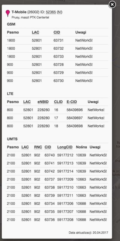

    T-Mobile Internet with Huawei B525 router. I need an external antenna because I have very big problems with link stability - it loses packets. This is the most important thing for me at the moment, speed is a secondary matter. The range inside the building jumps between 1 and 3 lines (out of 5).
    Distance to BTS - 2.4 km.
    BTS parameters:

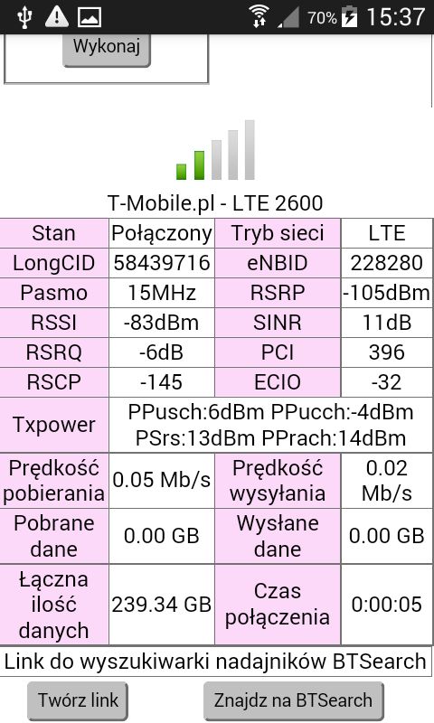

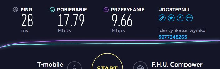

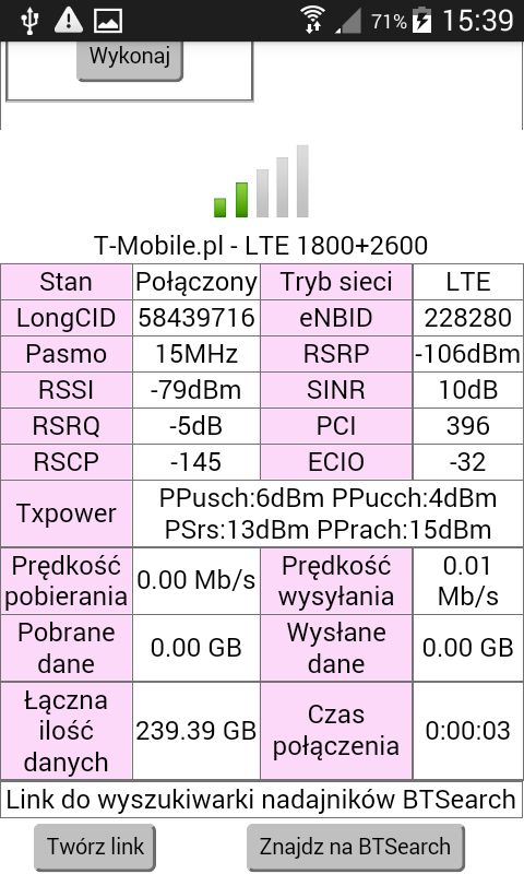

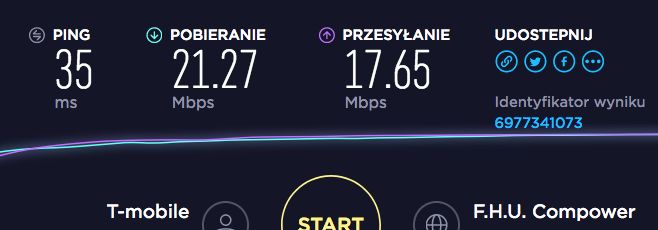

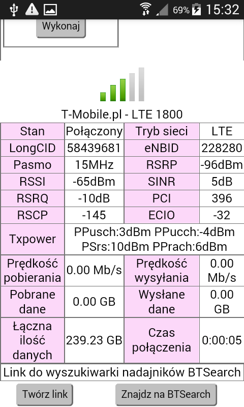

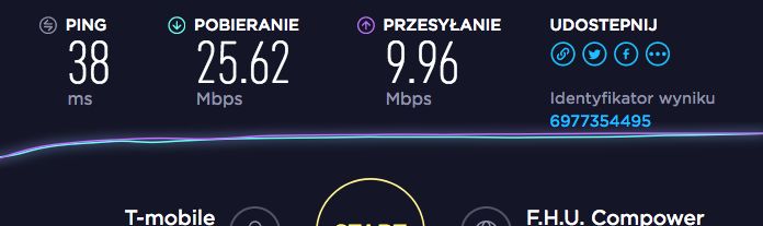

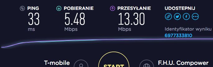

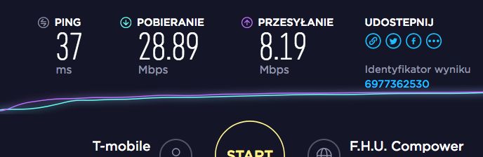

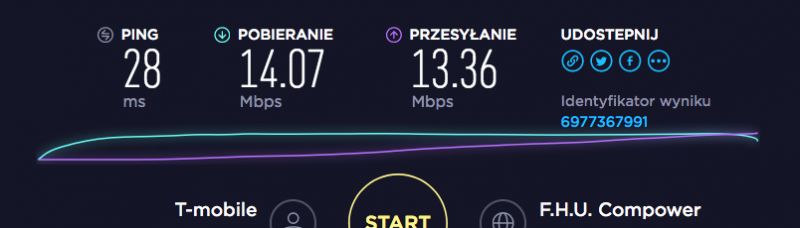

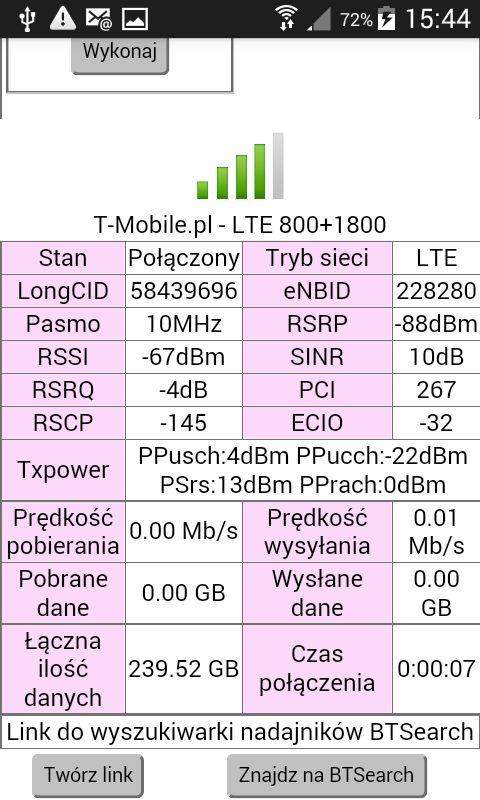

    Measurements done. I just hit the summit because a moment later BTS started to be overloaded - UL> DL. At 2100 - no coverage.
    LTE 800:
    Choosing the Right External Antenna for Huawei B525 Router on T-Mobile Network
    LTE 800 +1800:
    LTE 800 + 2600:
    LTE 1800:
    LTE 1800 + 2600:
    LTE 2600:

    The first application is LTE1800NW was already clogged. On LTE800 the best signal parameters and good speeds. On the LTE2600 the weakest but for them it's not bad speeds. Take the LTE2600 and LTE800 evening tests again. Tests at home or outside? How far to BTS Prussia? And at 2100MHz we check UMTS2100 and not LTE2100, T-Mobile does not use LTE2100. HSPA + DC operates on UMTS2100.

    During the day, if the BTS is not overloaded, it can be pulled out 40-45 Mbps - in the evening it is about 10 Mbps. Unfortunately, there is still a problem with stability. Tests done at home, upstairs.
