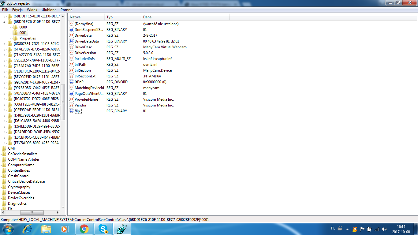

  • #34 16744934
    rojo17
    Posts: 18
    Rate: 10
    safbot1st wrote:
    safbot1st wrote:
    So I have to ask for this registry tree? Please kindly.
    safbot1st wrote:
    HKEY_LOCAL_MACHINE \ SYSTEM \ CurrentControlSet \ Control \ Class \ {6BDD1FC6-810F-11D0-BEC7-08002BE2092F} \ 0000 \ Settings Flip - change 1/0.
    https://obrazki.elektroda.pl/1387507700_1507467973.png
    That was it?
  • #35 16744958
    safbot1st
    Posts: 21951
    Help: 2719
    Rate: 1585
    Properities. What is there?
  • #37 16744992
    safbot1st
    Posts: 21951
    Help: 2719
    Rate: 1585
    run regedit as admin.
  • #38 16745022
    rojo17
    Posts: 18
    Rate: 10
    Empty folder
  • #39 16745035

  • #41 16745060
    safbot1st
    Posts: 21951
    Help: 2719
    Rate: 1585
    Add to 0001 REG_BINARY
    safbot1st wrote:
    Flip
    = 1
    close regedit
    computer reboot or logout / login

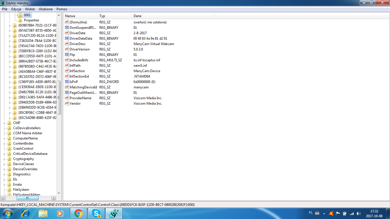

  • #43 16745098
    safbot1st
    Posts: 21951
    Help: 2719
    Rate: 1585
    No no. Right on the folder-> New-> Binary value-> Flip-> 01
    See also the neighboring branches up to "6BDD1 ...", see if there are Settings.
  • #44 16745105
    rojo17
    Posts: 18
    Rate: 10
    https://obrazki.elektroda.pl/8089333900_1507472105.png
    Yes?
    Added after 7 [minutes]:
    Unfortunately, it did not help.
    Still the same.
  • #45 16745173
    safbot1st
    Posts: 21951
    Help: 2719
    Rate: 1585
    As before, it's a flip with a capital "F".
