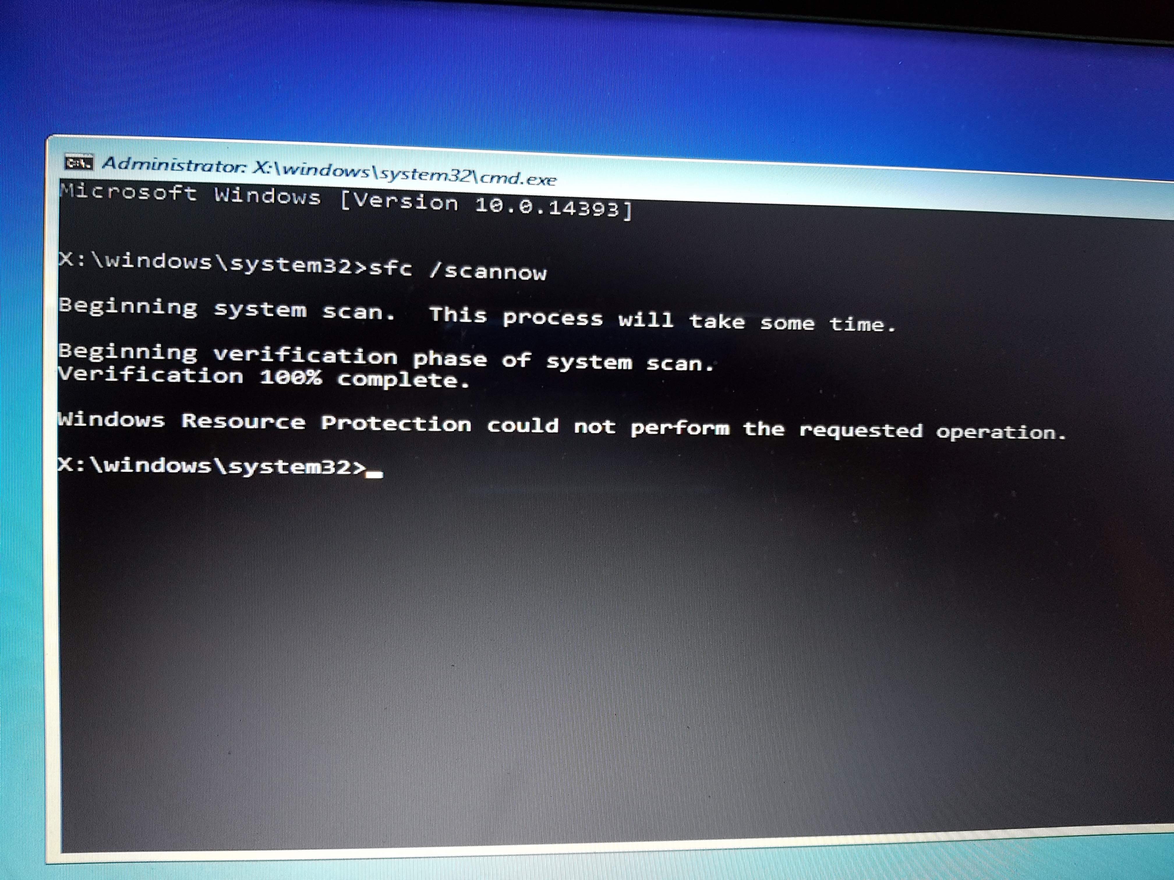

    This is the result of the "/ sfc scannow" command
    System Recovery Options for Asus K52J Laptop Post-Interrupted Windows 10 Update
    I also noticed that on this black screen with the cursor I can fire the narrator through the combination of the keys "Windows logo + Ctrl + Enter". And nothing else.

    After scanning with the SFC command, you received a reply that the disk created virtually by the installer 10 was scanned, where the configuration files for the installation process are installed and nothing more. All that remains is to restore from the image or clean the installation
