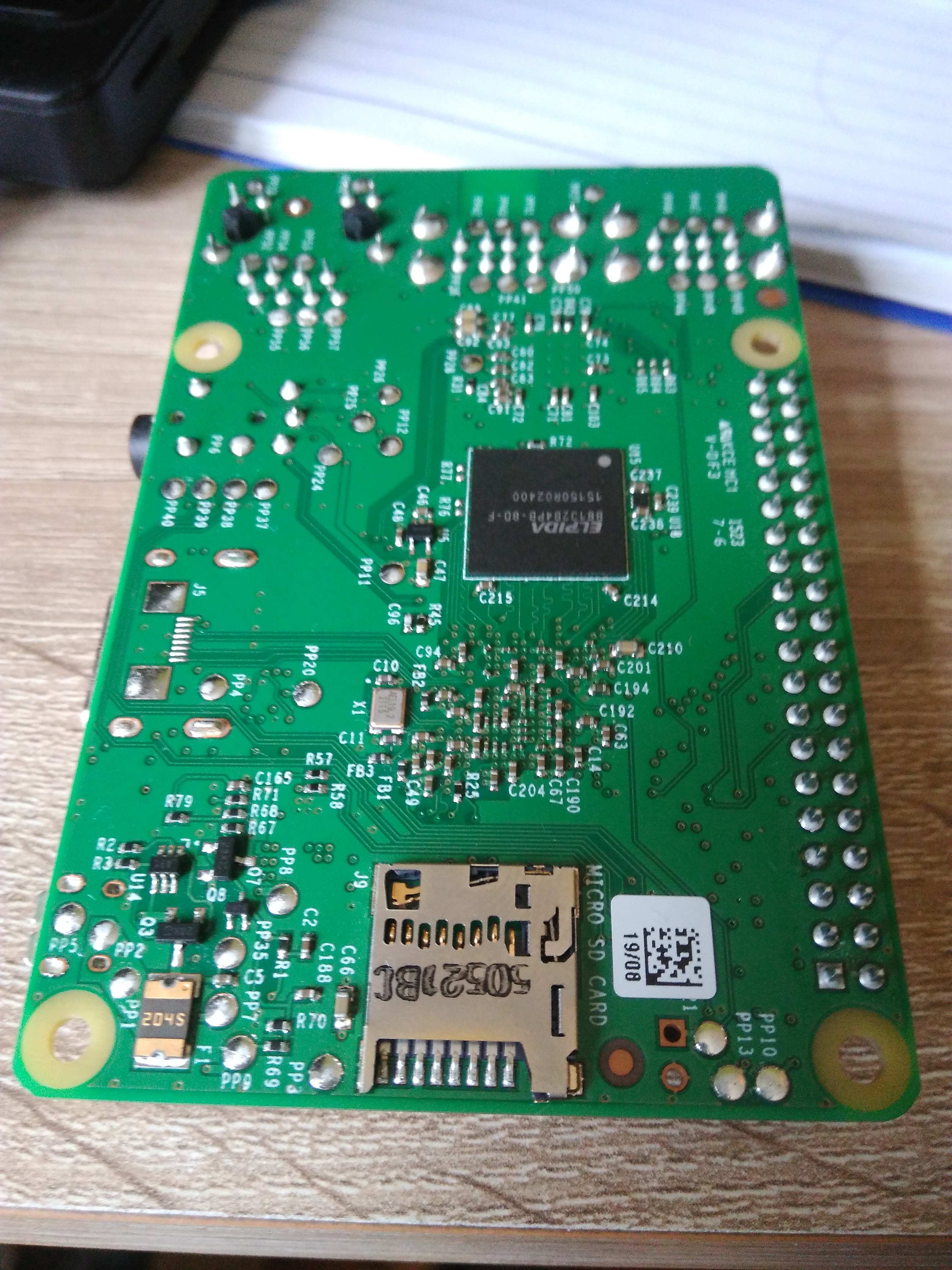

    Hello, I have several pieces of damaged raspberry pi. The converters provide the correct voltages, nothing heats up, all components look functional. After inserting the memory card with the system and connecting to the power supply, both the ACT and PWR LEDs light up. They burn all the time. Has anyone encountered such a problem? What could be the reason for this?

    Unfortunately, I don't know anything. I bought 8 damaged ones. One just got up and is also working in the black. 3 of them have all voltages but do not start. One has a short circuit on the u16 circuit (chipped), and 4 have 3.3 and 1.8 voltages but the voltage from the u16 circuit is missing, i.e. about 1.2v.

    It is known that there is a lack of tension, from a chip that is chipped, there is probably a good chance that Pi will get up after placing it with another model, but in the case of the rest, the matter is difficult, because it is not known who did them. Do you have the option to replace this U16? is it a matter to start because of the difficulties and complications of the process of pouring out and soldering? I haven't played with raspberry for a long time, so I don't remember what U16 is responsible for

    From what I've read, the u16 is a controlled core power regulator. One raspberry is close to firing but after some time the ACT flashes 4 times which indicates errors in reading from the sd card. I tried with two cards and the same error.

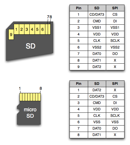

    According to this pinout
    Damaged Raspberry Pi: ACT & PWR LEDs Constantly On, Correct Voltages, Not Booting - Solutions?
    3.3v (is) power should be on pin 4 and this raspberry is on pin 5, i.e. CLK.
  • #8 16743062
    So it looks like there is no voltage and what you measure on pin 5 is just a clocking waveform - a regular voltmeter will show DC voltage.
