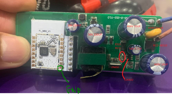

    Hi, I have these devices that's not working
    LED drive for Downlight:
    The highlighted smd resistor appears to be damaged, the number marking was gone so I just assumed it could be 155 based on the nearby resistors. After replacing it, it's still not working.
    Electronic board with components, marked damage

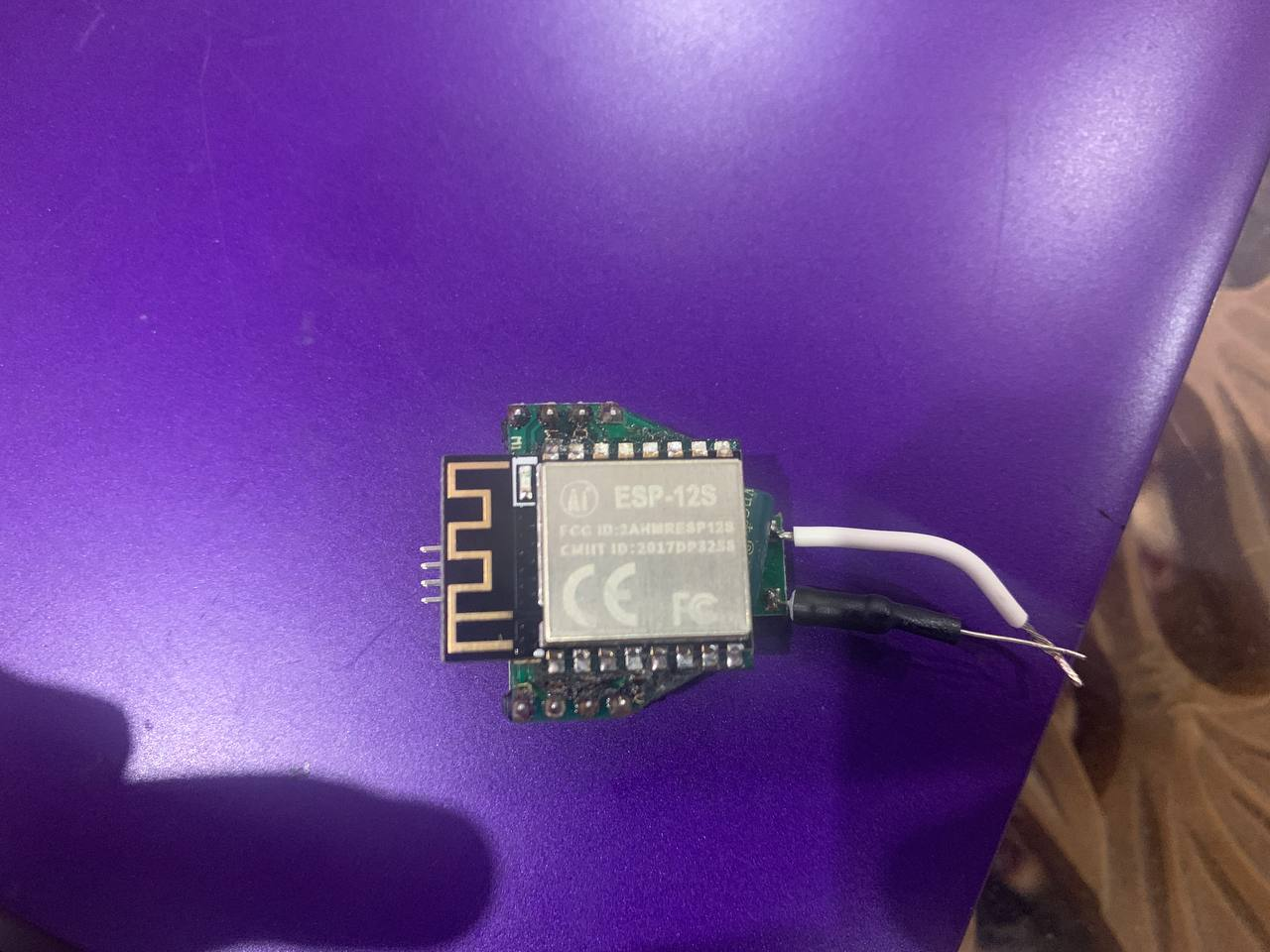

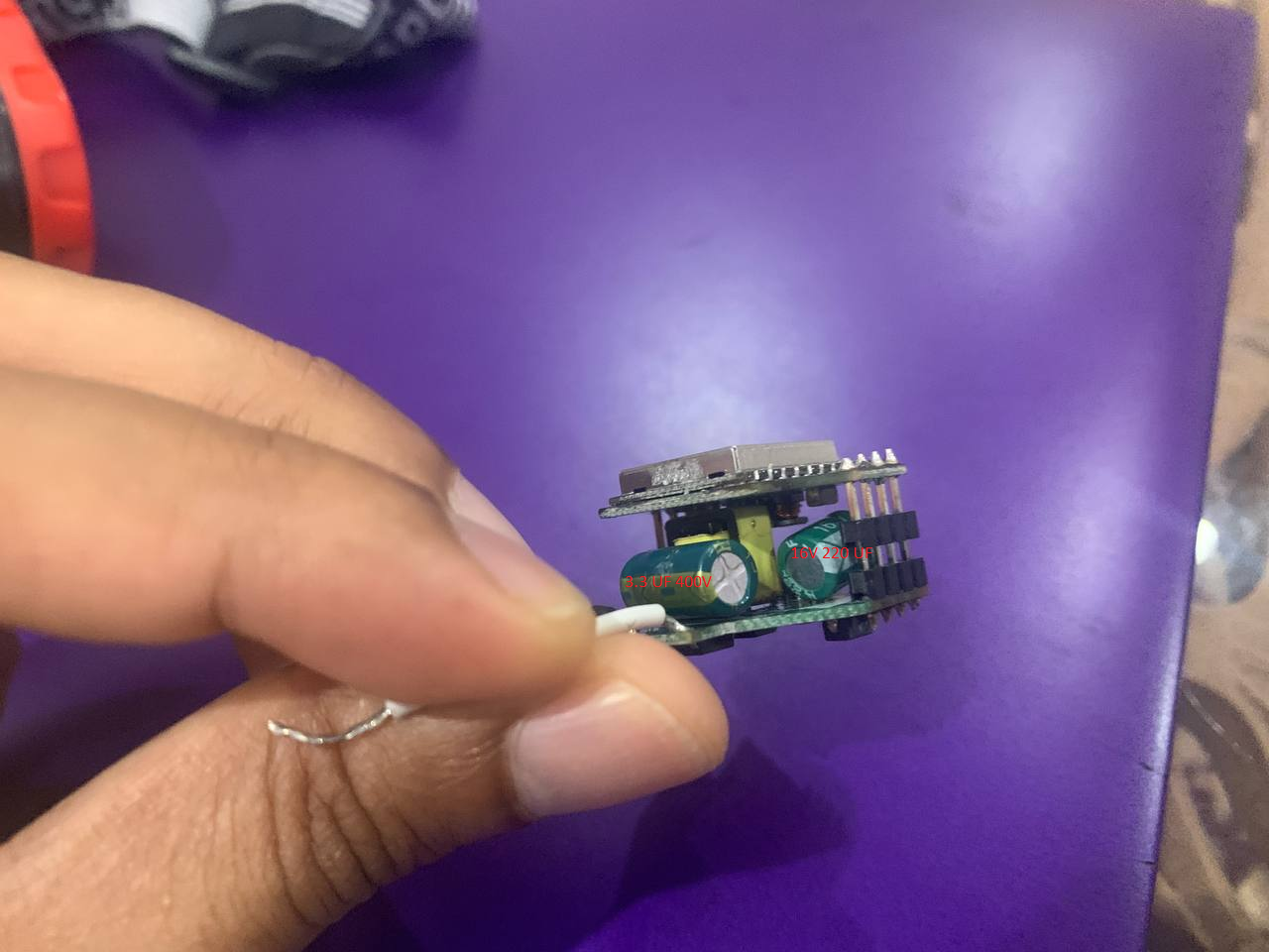

    E14:
    I replaced the 16v 220uf capacitor and was able to get it running again but not for this one, seems like the capacitors are intact/not damaged.

    Could anyone advice how I should start checking the components using the multimeter for fault?
    Do let me know if I need to provide more photos.

    Well, first I would check whether 3.3V is present at the WiFi module. Then I would check if WiFi module works to narrow the issue down to the LED driver. Then check which LED driver is used and find datasheet for it.
    Your description seems a bit confusing to me. It seems that you are repairing two of them, and one is fixed, but second is still not working?
    Also, how was it damaged? Maybe a cold solder joint?
    How the base of capacitors look like? See:
    https://www.elektroda.pl/rtvforum/topic3898805.html
    Open the link, you will see how damaged capacitor in smart device power supply looks like.
    The wifi module works, i was still able to flash openbeken and it boots up after desoldering the chip (led driver downlight).
    By the way this downlight is using PWM led's.
    Sorry about that, what I meant I have 2 units of E14 that's not working. The fist one had an obvious capacitor issue (bulging for 16v 220uf) and replacing the capacitor fixed it, but the second E14 had no issues with the capacitor.

    If you had capacitor issue, then it means PowerSave has to be enabled.
    How do you know that second one capacitor is okay? It may be degraded even if it's not visible from the outside. Have you checked with ESR meter?
    Is this for the downlight? When I soldered the chip back, it doesn't boot up which might indicate there's no 3.3v on the pcb
    I did also replace the 2end E14 with a new 16v 220uf capacitor but it's still not working.

    Please carefully check with multimeter. We need to know where the fault is.
