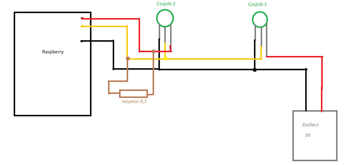

    Hello, I am putting together a circuit for myself to monitor temperature. I am using Raspberry Pi 4b + Domoticz + DS18B20 sensor for this. I would additionally like to create a system based on this sensor to inform me of power outages. What would this look like?
    I would power the Raspberry from a UPS so that it would still work for about 20 minutes despite a power outage, I would like to power the sensor with a normal power supply from the socket without the UPS. In my mind it looks like if the sensor doesn't get power it will show some strange values (maybe 0 degrees or maybe some minus temperatures) then Domoticz will send an alert email.
    Is such a thing even possible? If so, how do I put it all together?
    If wrong section then sorry and please move to the correct one.

    A reading error from the DS18B20 manifests itself as a temperature reading of -127 deg, except that this can also indicate a sensor error, lack of connectivity, etc., so it is not synonymous with a power failure.

    It still saves me because it will be clear that something is wrong and that is what I care most about as this "system" will be in the server room. The question is can I connect it as I described above?

    The GND of the power supply and the Raspberry must be connected together. The question is how far is the sensor from the RPi ?

    DestiX wrote:
    I would additionally like to create a system on the basis of this sensor which informs of power failure
    And why such a combination? Isn't it better to do it directly? At least reading the data from the UPS, via its port. Or, if the UPS is poor and doesn't have this boon, you can feed the supply voltage, after rectification and filtering, to an optocoupler, and output to the GPIO on the RPi. There are probably many more ways.

    This combination because it is easier for me to figure out. What you have written is not very clear to me and therefore I would probably have a lot of trouble putting it together, and soldering the power supply cable is a much easier task.

    Lack of power during a measurement attempt results in a measurement result of 85*C, this is described in the specification. Interestingly the DS18B20 has the ability to check if the thermometer has power remotely via the bus with the instruction "READ POWER SUPPLY [B4h]".

    Okay, so I managed to build a system that actually works. Admittedly the sensor when the power goes out shows about 37 degrees and not 85 or -127 but it doesn't make much difference, in fact none. Should anyone need it, here is a simple wiring diagram drawn in painter.
    Thank you all for your help and best regards.
