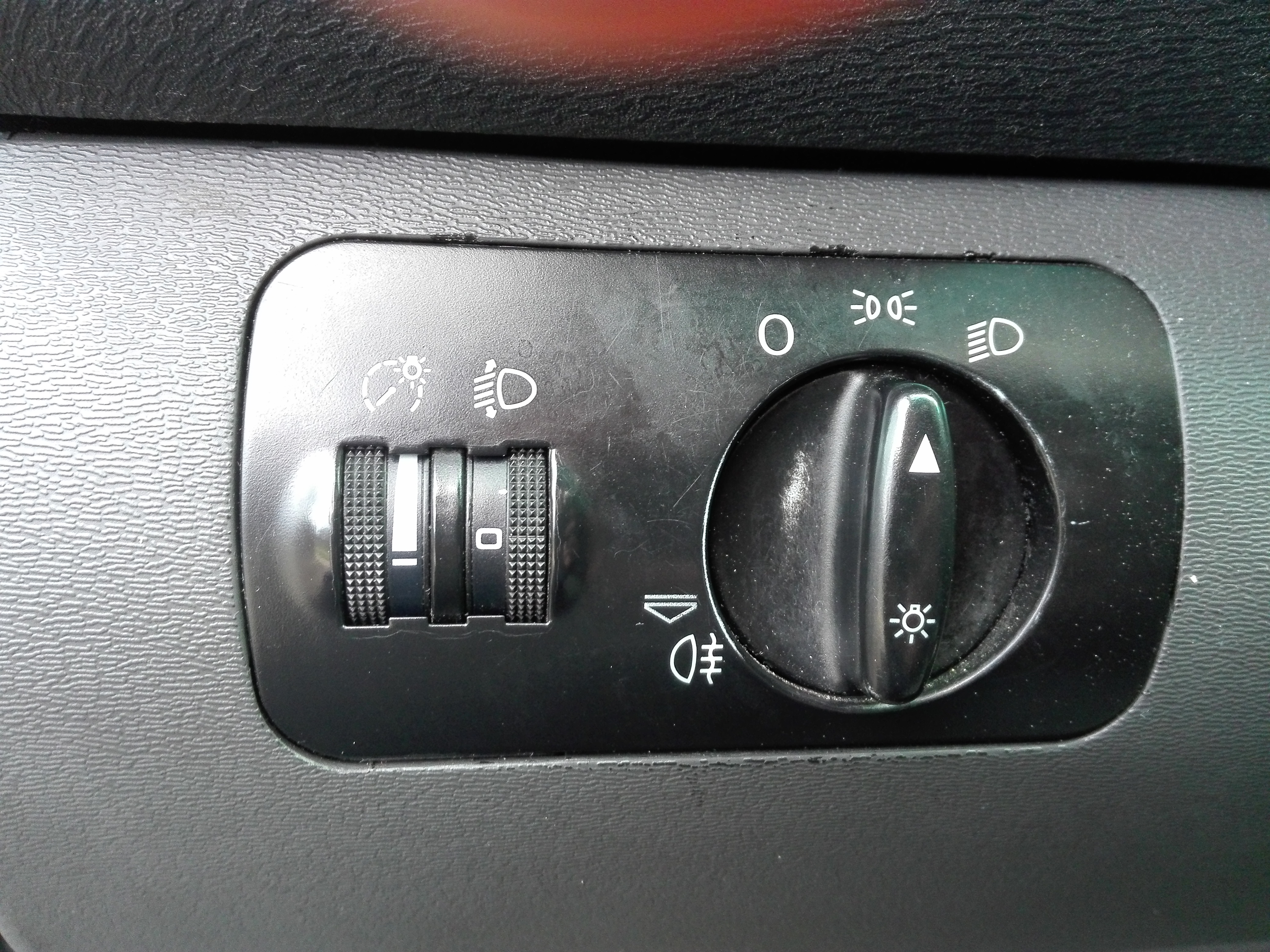

    Hello all.
    I have a broken light switch and I would like to buy a new one, but there is a problem.
    Well, after removing the switch, there is no identification number on it, and the Lord in the store told me that without this number he would not look for me, so I am asking you for help.
    I only have rear fog lights in the switch, and the switches I found also have front fog lamps and halogen lights. I don't want to order blind because I don't know if it will work.
    So my question, if I buy a switch with front fog lights and halogens, will everything work as it should? Are you able to give me any ID number that will match mine?

    masay1
    Level 20  
    Posts: 256
    Help: 40
    Rate: 81
    8L1941531H; change from 01/10/2002 on 8L1941531HB98
    both will match ... but the new catalog number is the latter ...
    and it is according to you should search / order it ...
    Added after 7 [minutes]:
    aaaa ...
    from what I can see in the photo you uploaded it
    the light switch is probably from "Englishman"
    while the number I gave you is for the "continent"

    Pawel.k20
    Posts: 25
    I mean an overview photo from the net. Here is my EU.
    Thank you for your answer.

    VAG group specialist
    Posts: 9823
    Help: 1495
    Rate: 5052
    If you buy from richer equipment, it will work so that, for example, to turn on the rear fog lamps, you will have to pull harder because the front fog lamps will be in the first position and the rear fog lamps in the second position. Of course, what is not in the car will not light up.

    Pawel.k20
    Posts: 25
    Such a question, just to be sure.
    It's hard to find a switch with this part number, so I have a question if the switch with the number 8L1941531E will fit
    I am asking because I want to be sure there is the same wire connection in the cube, without any DIY.

    masay1
    Level 20  
    Posts: 256
    Help: 40
    Rate: 81
    99% yes ...
    the number you give is probably the part number ...
    while I gave you the catalog number ... according to whose
    you can buy a new one ... but with stimulants it is not so easy,
    because at auctions they usually give part numbers ... and NOT catalog numbers ...
    no. catalog does not have to and is not always the same as no. parts ...
    but to the point;
    you wrote about the Lord in the shop; that's why I gave you no. catalog ...
    but now I see that you are going towards the stimulant, and with that I will not help you much ...
    but if the one you are going to buy has the same functional markings (holograms)
    and it is functional on the mechanical / electrical side, it will be Ok ...

    grala1
    Posts: 9823
    Help: 1495
    Rate: 5052
    Google the photos from the back as you want to be sure.
    Electrically, the Golf 4 switch fits there (it only has a different lighting dimmer).
    No matter if you have front fog lights or not, the plug is identical, it only has a different number of wires, so every switch will go there and the basic lighting will work.

    Pawel.k20
    Posts: 25
    I ordered a new one with the number 8L2941531H.
    I am writing this post for the next lost ones to read this post and learn more.
    Will it fit perfectly? I will write how it will be mounted.

    Pawel.k20
    Posts: 25
    Switch came on, everything works as it should.
    Thank you @ masay1 for help ;)
