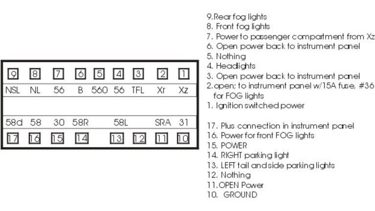

    Hello!
    I need a diagram (description of individual pins) for the plug connected to the light switch.
    I am asking for help if anyone is able.

    below Seeking Light Switch Cube Diagram for A6 C5 Avant 2002 Model
    • Seeking Light Switch Cube Diagram for A6 C5 Avant 2002 Model 2017-04-05_21h05_30.png (152.25 KB) You must be logged in to download this attachment.

    Thank you for the diagram. I have a question, could you explain point 6 from the diagram to me? What does pin 6 correspond to ??

    26 and 27 pin power supply in the meter
