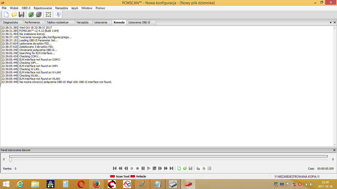

    The request is to someone wise who could elminate elm 327 version 1.3a to connect with Ford. I attach photos of the plate. Maybe someone knows if this can be done ELM 327 1.3a for Ford - ELM 327 does not combine with Ford 1.8 petrol mk3 and how.
    Regards ELM 327 1.3a for Ford - ELM 327 does not combine with Ford 1.8 petrol mk3

    I did something, question or everything is good - I attach photos of my scribbles ELM 327 1.3a for Ford - ELM 327 does not combine with Ford 1.8 petrol mk3 ELM 327 1.3a for Ford - ELM 327 does not combine with Ford 1.8 petrol mk3 ELM 327 1.3a for Ford - ELM 327 does not combine with Ford 1.8 petrol mk3 ELM 327 1.3a for Ford - ELM 327 does not combine with Ford 1.8 petrol mk3 ELM 327 1.3a for Ford - ELM 327 does not combine with Ford 1.8 petrol mk3

    unfortunately - no response after entering the commands ELM 327 1.3a for Ford - ELM 327 does not combine with Ford 1.8 petrol mk3 ELM 327 1.3a for Ford - ELM 327 does not combine with Ford 1.8 petrol mk3 ELM 327 1.3a for Ford - ELM 327 does not combine with Ford 1.8 petrol mk3

    You haven't connected to the interface at all, check the COM port number where the interface is installed. I also remind you that the interface must be connected to the car with the ignition on.

    I see that my colleague does not believe that I have the right port - I have set the com1 port and in the tab you are asking for is com1 and in the terminal. We can skip this motive. But I also tried to connect to other ports and nothing.
    Some spells, but I postponed this pin from the additional K line in place of the missing L line and fired - so I did not reschedule so I fired ... miracles but lines appeared on the car meter (where the meter readout) and the bingo merged ... I read error P1000. But strangely, now the terminal does not connect no connection and error ... massacre ... can anyone explain it ...?
