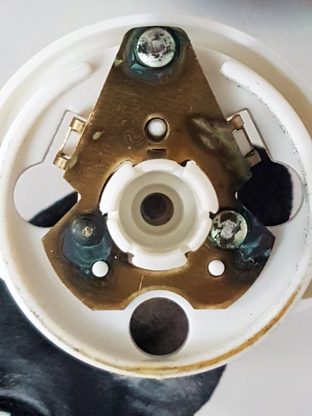

    A classic problem, i.e. airflow in the 4th gear. I wanted to unplug this entire resistor and replace the fuse but I can't locate this resistor. I located the windmill power plug (after pulling it out, even the 4th gear did not go).
    Below photos from what I took down, i.e. the board from the passenger and the cube mentioned above.
    I also unscrewed the fan housing.
    If someone can direct me somehow where to look for a resistor, I will be grateful (I am at odds with vehicle mechanics).

    Well, you have a resistor in the fan housing, this heat sink with two transistors.
    If possible, the regulator can be dismantled for repair.

    Do you have air conditioning there? You don't have an ordinary resistor, just a step adjustment on the electronic regulator.
  • #5 16774698
    Sysia91
    Posts: 7
    Yes - it's climate.
    So you need to replace this regulator?

    You have burnout on the joint, check it out.

  • Corroded fan switch contacts likely caused fault
    #19 19674371
    tacim
    Posts: 174
    Rate: 83
    milejow wrote:
    Have you got power on that 40A fuse?
    It should be after ignition or after starting the engine and go directly to the blower motor and the ground speed control from the switch through the resistor.
    Heh I'll say a good question I thought I measured everything but as you can see it seemed to me.
    fredflinst wrote:
    Buddy, they will start by checking the resistor, namely the pins in the ankle, they have it to themselves that they like to sunbathe.
    The hatch tomorrow but it looked rather nice.
    Added after 11 [hours] 2 [minutes]:
    However, I am an amateur of sour apples. Half a day of tinkering and I did not check if the voltage on the fan went after starting the engine. I think I have met a car that fires windmills with the engine for the first time, or I pick for new ones ;) . It doesn't change the fact that it works. I don't know what was wrong, but since I unhooked everything and splashed it with contact, something helped. I bet that the plate of the rotation knob was to blame, the one with the photo-cleaned and bent guns.
    At least I will replace the backlight bulbs because everything is burnt.
