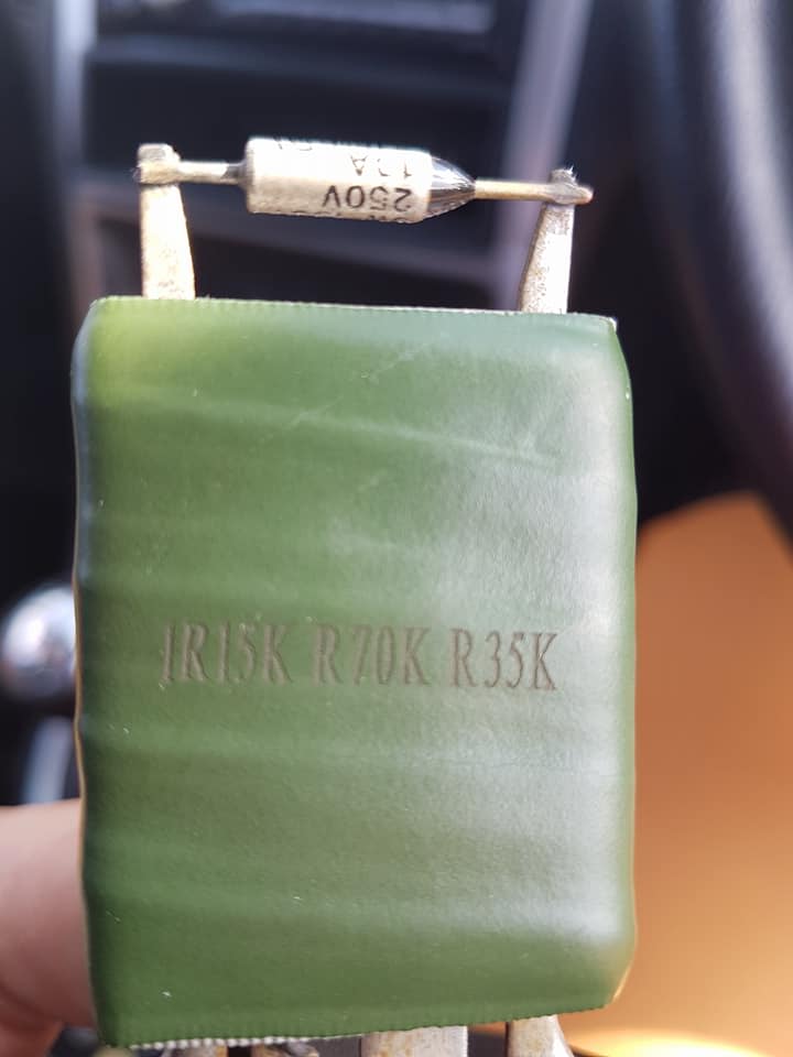

    Smoke has recently come out of the air vents. I turned off the engine and blower and it calmed down. I started rummaging and dug out a resistor from a blower to which the cables were attached. The black (probably +) cable was charred. I shortly connected the same cable to another (4 were) and the air flow returned, only a problem appeared, because the cables began to heat up. I thought maybe it can't be done and I bought a new resistor. I connected the cables, the ventilation started to work properly only that the resistor started to heat up so after just 2 seconds. Please help.

    Give photos of old and new resistors [resistor].

    pingwin72
    Posts: 44
    Rate: 19
    the old man is also warming up
    Added after 55 [seconds]:
    I will send you the photos, I am going to measure the tension now

    Peugeot 307 - Resistor from the supply cables began to heat up. Peugeot 307 - Resistor from the supply cables began to heat up. Peugeot 307 - Resistor from the supply cables began to heat up.
    the temperature is such that you can't keep it in your hand so I think that's not the point
    I sat in the car and buried it a bit ... What is the situation? First of all, I found one cable where the resistor doesn't heat up. This is the cable from the 4th speed (plug 2nd from the right). I held the resistor and it was very good, i.e. the temperature was optimal. After connecting the next cables, the resistor was heating up very quickly. I put it back in again from which the resistor did not heat up and everything returned to normal. The blower works beautifully without any signs of smearing. The wind was blowing like in the good times. I thought that maybe I would pull it out and put it in another contact of the resistor - unfortunately the resistor immediately got warm despite the fact that the rotation of the windmill decreased. I put other cables (in turn) into the pin on which the first cable caused normal work, unfortunately each combination caused the resistor to heat up. Conclusion: ventilation normally only works at speed.

    now I understand - it was immediately written - if the heating of the resistor is normal, what temperature does it reach?
    Anyway, somebody explain why after skipping the resistor, when connecting cables from level 3, are they terribly hot?

    I buried, connected a new resistor, repaired the faulty cables and what? Everything's fine so far. Tomorrow I will test the wind a little - I have to do about 90 km, so all that is bad will certainly be revealed. I am still surprised that heating the resistor (so much) is the norm - but I think it should be like that. Many thanks for the advice, tips and tricks. I wish it was good.
